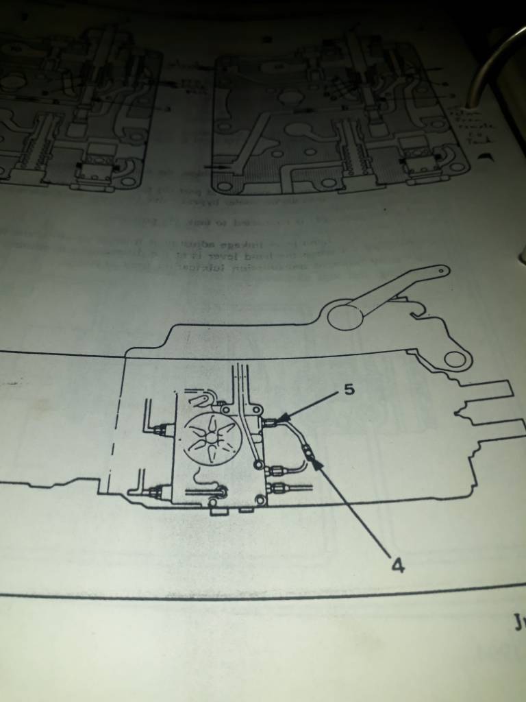

I'm going to put bar on the pto shaft and see if I can turn it counter clockwise as you suggested. I ordered a liquid filled pressure test gauge and hose today. hopefully I'll get it tomorrow and can get the pressure readings. Is the dip stick on the lower left side of the seat the one that gauges hydrolic / trans fluid? It doesn't have any hash marks on it, but it sure does look low. I expect the fluid level needs to be close to capacity before hoping to get an accurate reading, correct?

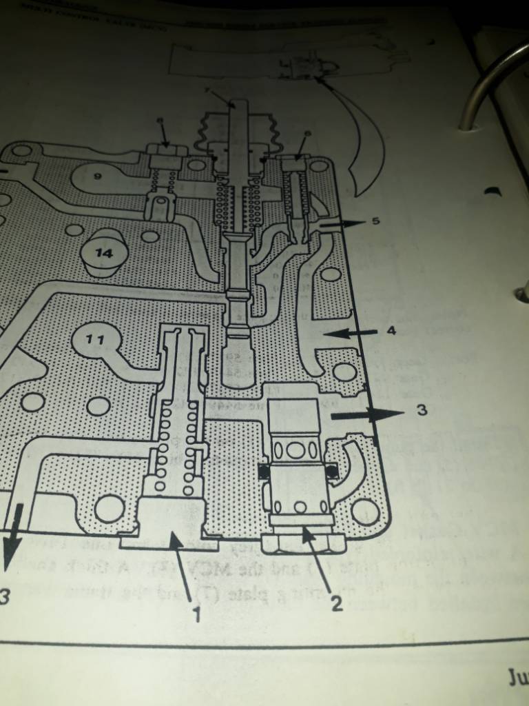

#14
Thanks DLT for posting those pics. If I get my pressure gauge today, I'll check it tonight. I put a wrench on the upper pto shaft, it does turn counter clockwise, but it took some force to get it going. I was then able to turn it clockwise as well. perhaps thats not a good thing that it turned both directions? I was just glad that it wasn't frozen solid like the seller told me.
