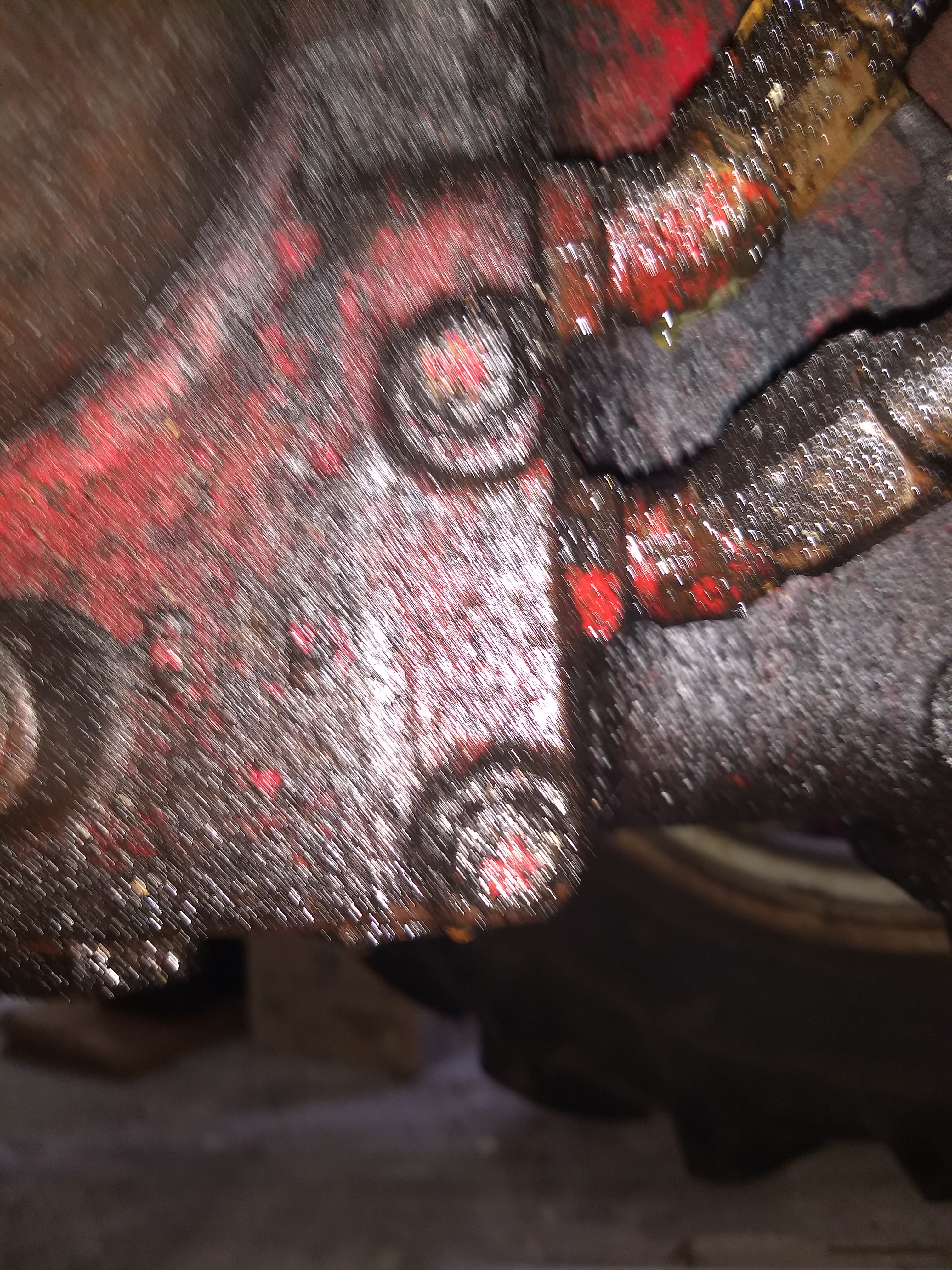

fitting connections IH454 pressure check.jpgvalve fittings hydraulic IH454.jpg
In the pictures above, the pump fittings look a bit different. I don't have the inter tubing fitting that your picture shows. Do you know what type of adaptor / hose I need to make my pressure gauge fit into the pump once I remove the attached solid lines? Is the top on the flow to the pto clutch and the bottom one is the return from the pto clutch?
   / Pto on IH 454 locked up.
#29
Since I don't have a flowmeter, is there an order to doing this test. Isn't one of the two connnections outflow and the other inflow? Do, I test from both ports the same way just leaving one plugged into the circuit flow, while testing the other?
#30
So, the thin line going down behind the two thick ones is the pto line. Since it has a cap on the end of it, how does it feed the pto. I was wondering about that. I have the IT-203 Shop manual, but it shows the two large ones and what appears to be the brake line, but I can't see the pto line in a similar. The manual also says the two "thick" lines shown in my earlier photos as hitch return (top one) and hitch pressure outlet (bottom one). I would think that checking the return would show limited pressure, but the pressure outlet would show substantial pressure. I'm trying to understand how it all works, but am confused how pressure can be tested without a flow meter.
