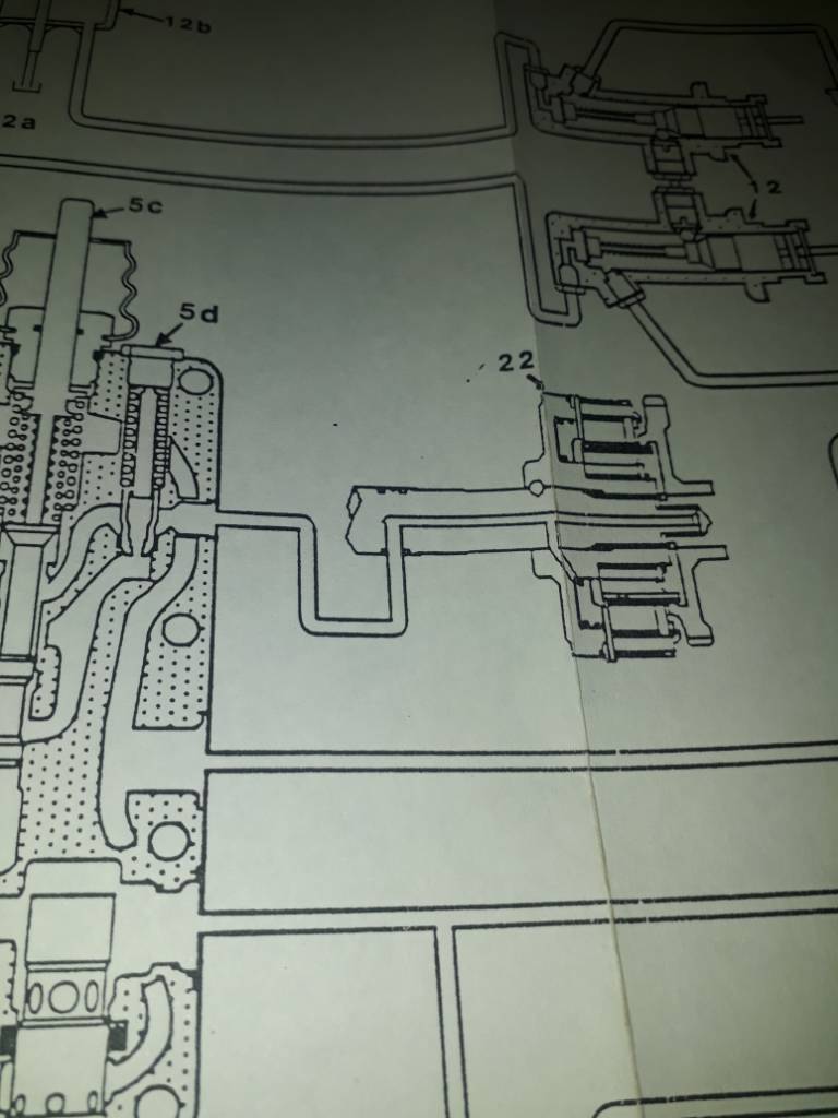

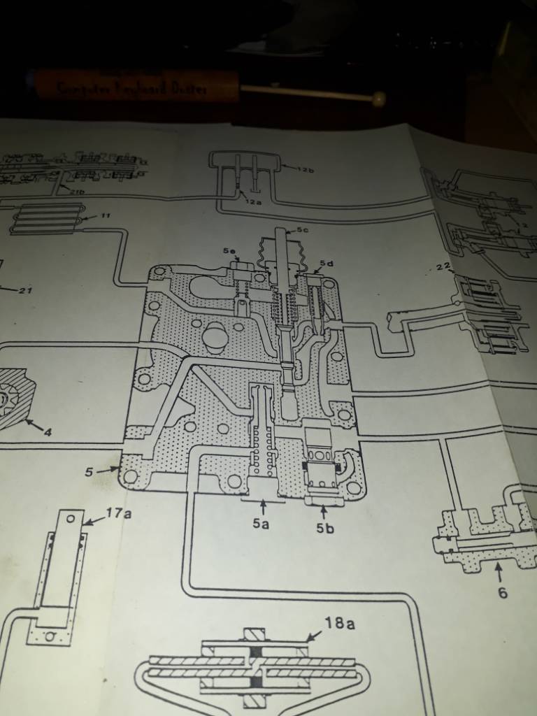

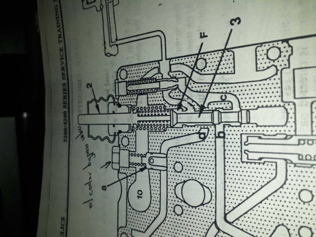

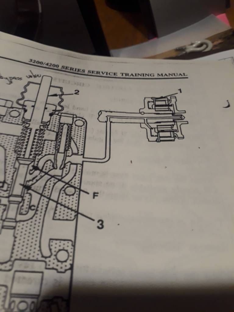

MCV = Multipal Controle Valve.
Thats the "squere housing" between the filterhousing and the diff housing. Where all the pipes is connecting to.
That small pipe is the feed for the PTO clutch and that pipe fitting at the end is a T- piece going into the diffhousing throu a channel to the rear PTO shaft and that shaft has 2 rings on it and a hole inbetween it channaling the oil to the PTO clutch. Oilpressure clamps the clutchplates together coppeling the front and the rear PTO shaft together.
No oilpressure and the 6 springs in that pack clamps the brakeplate and stops the rear shaft.
Will send some pics.
