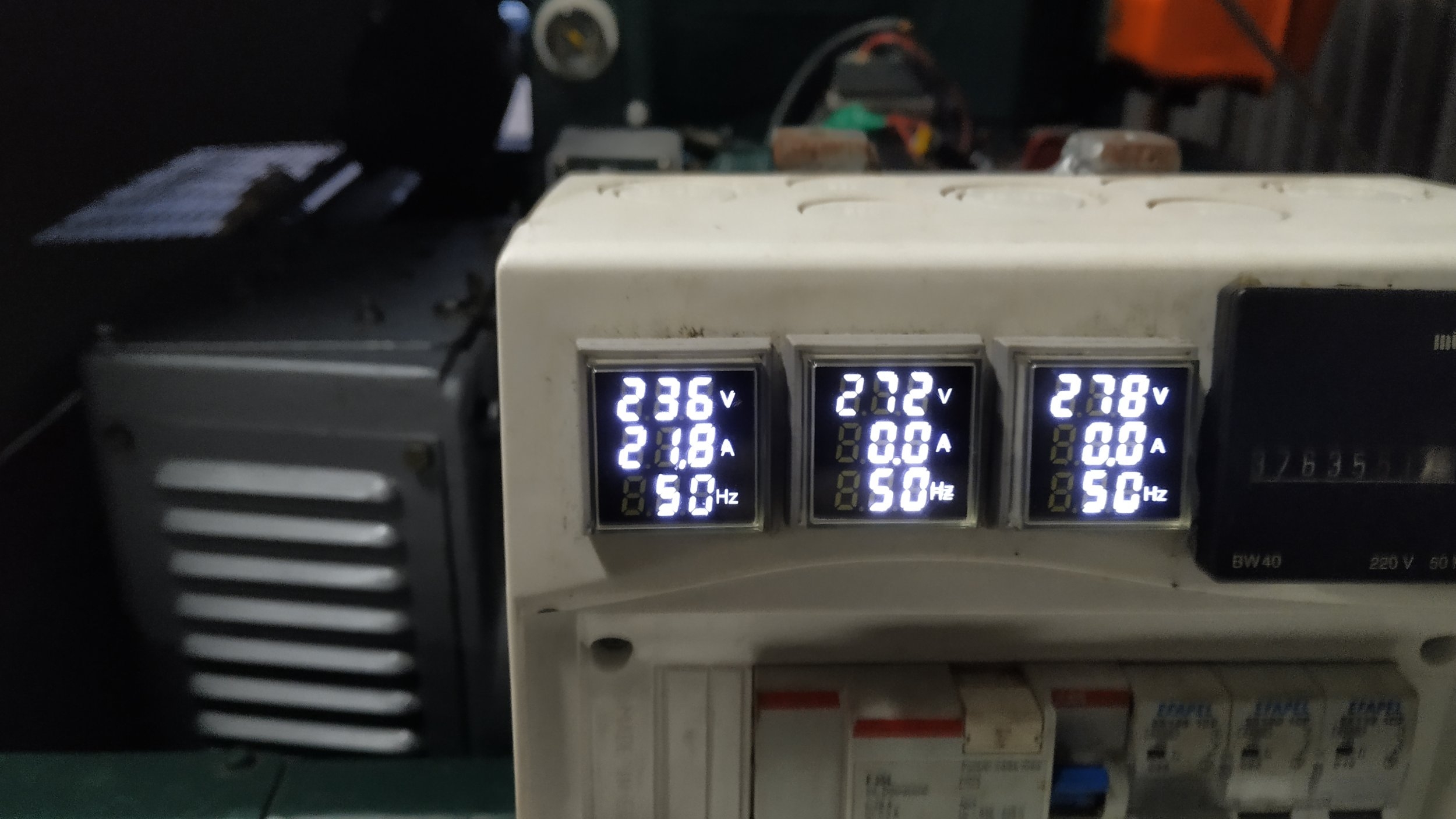

On mine, I also added 3 of those Volt/Amp/Hz meters. One per phase. Works awesome and only cost like $4 each.
I like that! Wondering if I should monitor the amps per leg?

For the price of those things, it's pretty much a no brainer having a meter per leg.

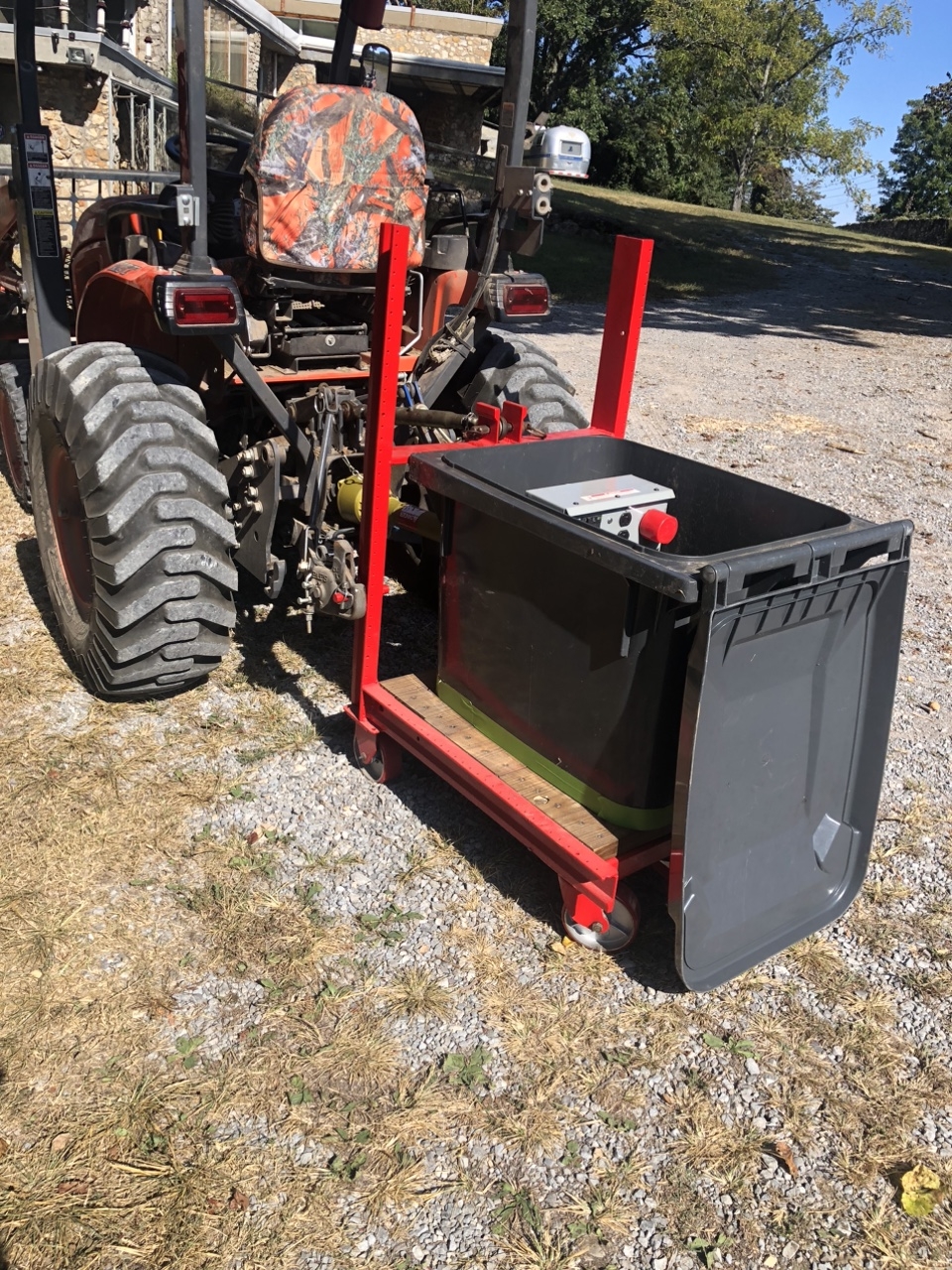

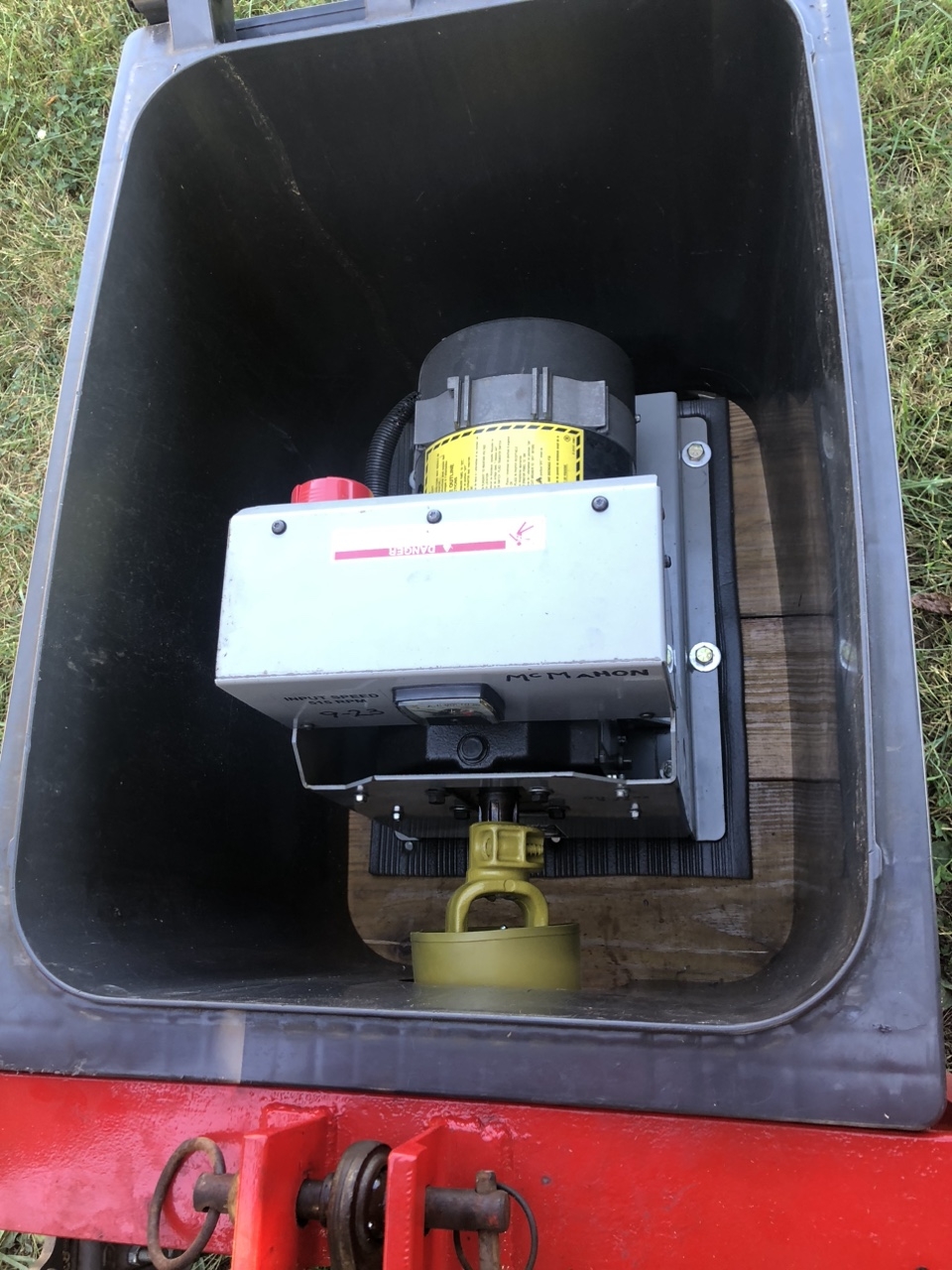

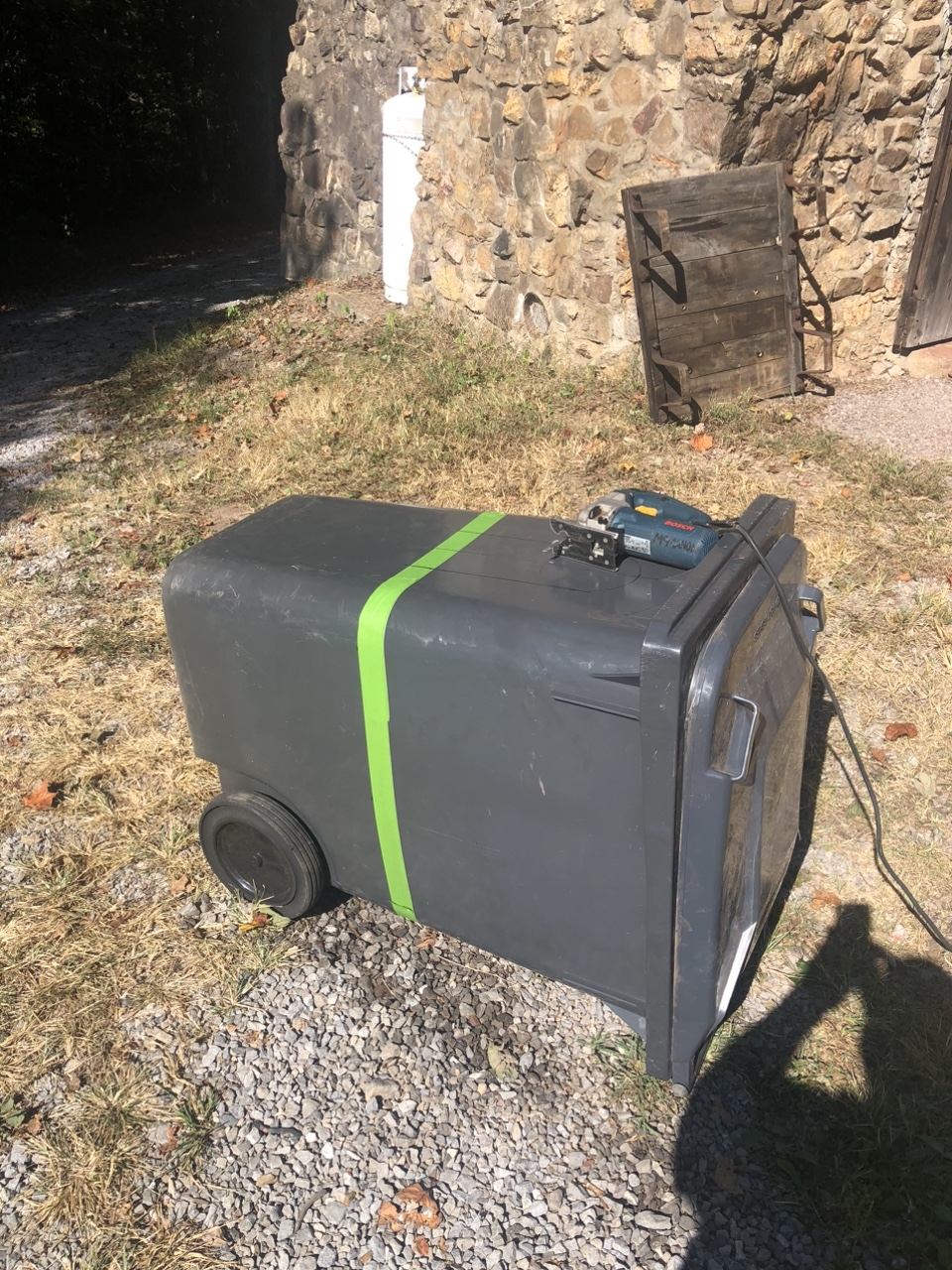

Worked on making a weatherproof cover. Pto slot cut. Need a few ventilation and cord holes. Holding down with bungees for now. Need some blocking at the base to keep from shifting. Think the concept will work and keep the generator dry in inclement weather. Strong enough to push on the top for positioning.

I like it. I envisioned your project with the trash can laying horizontally with the lid closing on the back of the generator. Better access like you have it.

Do you get heat buildup inside the enclosure?
I used a plastic deck box in a similar manner to cover my 12KW PTO generator. I had to prop the lid open a bit to vent the heat buildup produced under heavy load.

Appreciate the experience advice. Definitely something I’ll monitor. Propping up the lid a possibility. A simple bungee across and under the lid could give variable space and still give rain protection. Generator is fan cooled. Pulling air from back thru the alternator. Not shown very well in the photos, there is a 6x15” slot for the pto on front and 1x21” slot overhang on the back. There will be holes for cords, large for 50amp industrial plug. Also plan for some 1” holes around under the generous drip edge of the container lid. As you can see the lid also swings completely away if needed. Maybe some side holes/slots or louvers that align with generator fan flow path? The trash can is surprisingly heavy, strong and tough material made for rugged handling in outdoor extreme temperatures. Wall thickness 3/16”. It doesn’t say but suspect this one was 65gallon capacity. $35, used, sourced locally. We have the larger 96gallon style.

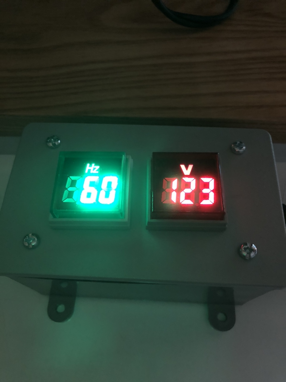

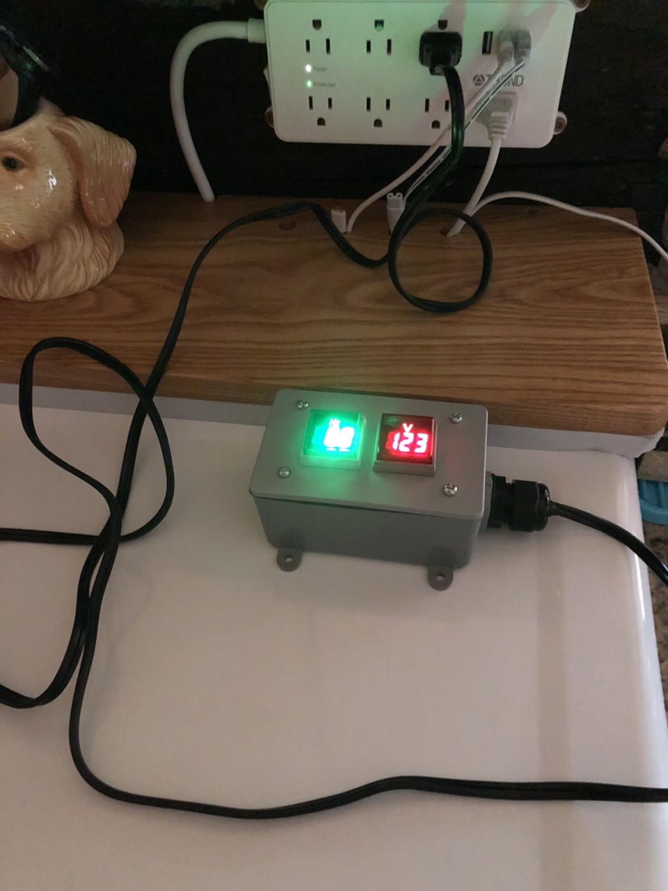

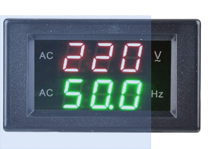

Like many of us living the dream with property, we have to rely on generators sometimes.
Bought some meters to mount on the generator to better monitor. Some extra to make a simple box to be plugged into a receptacle to monitor any generator or house when on generator power. Cost of parts only about $20.
Hertz is right on and the volts is 0.3-0.4 high compared to my Fluke meters.
Have it now by the TV admiring my work. Wife says it’s too bright to stay there unless we are on emergency power. Numbers are sharper than shown in the photos.
/ PTO generator weather proofing #32
Looks nice. I kinda agree on the brightness. Maybe some dark window tint film would help it a little bit?

/ PTO generator weather proofing #35
Wonder how accurate the HZ reading is where most non-inverter generators are not a true sine wave. I've got a plug in power meter that registers HZ, volts, amps watts, I meant to use it last time the power was out and I had the generator set up but I forgot it.
I was looking at this one and planning on mounting it in a box similar idea to yours. Amazon.ca
