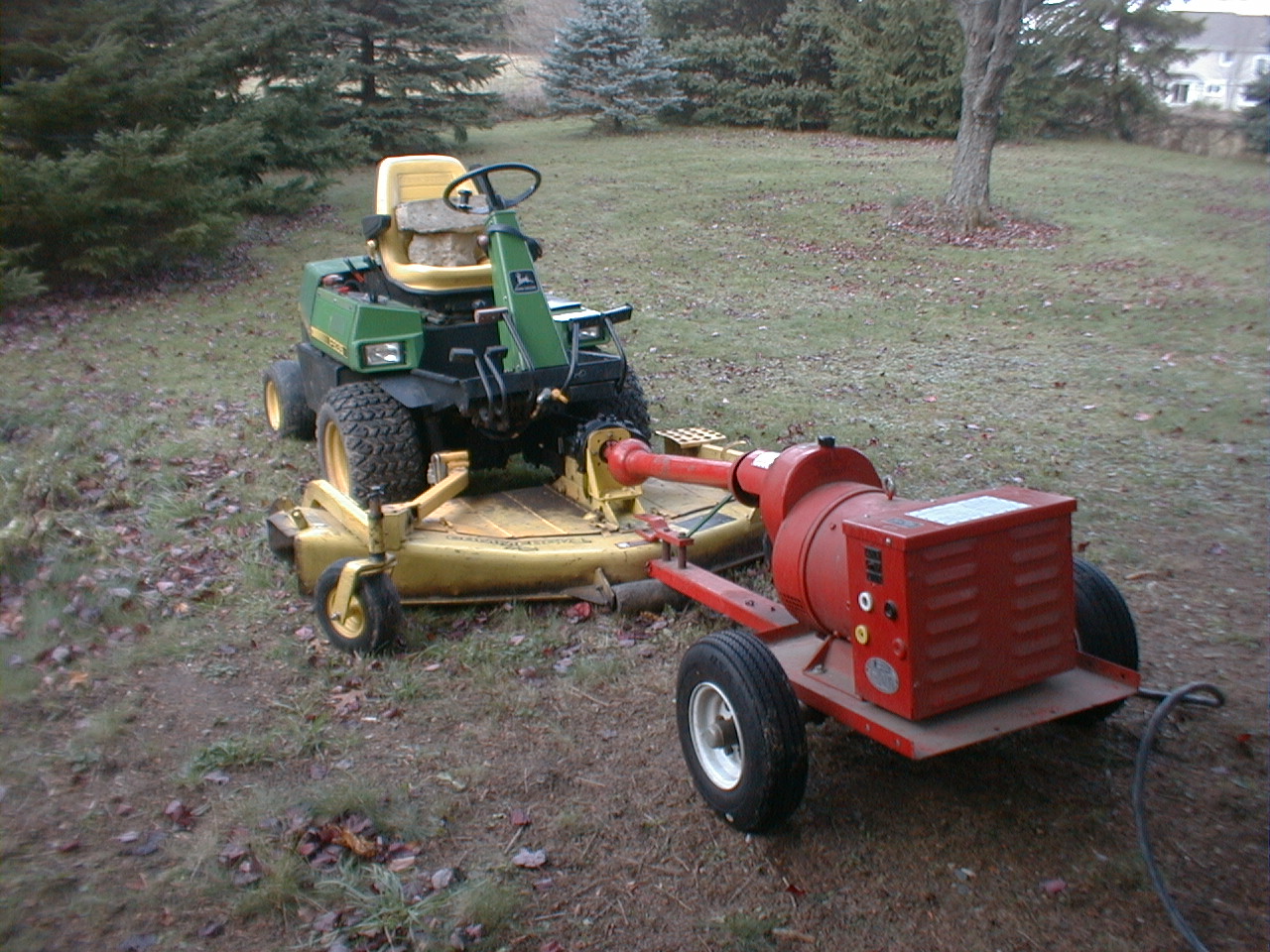

Heck I run my 50kW Winpower off the pto of my F-935 lawnmower (~22 hp). It doesn' PIC00015.JPGt even grunt. I use a Kill-O-Watt device to set the throttle for 60Hz and away we go...
