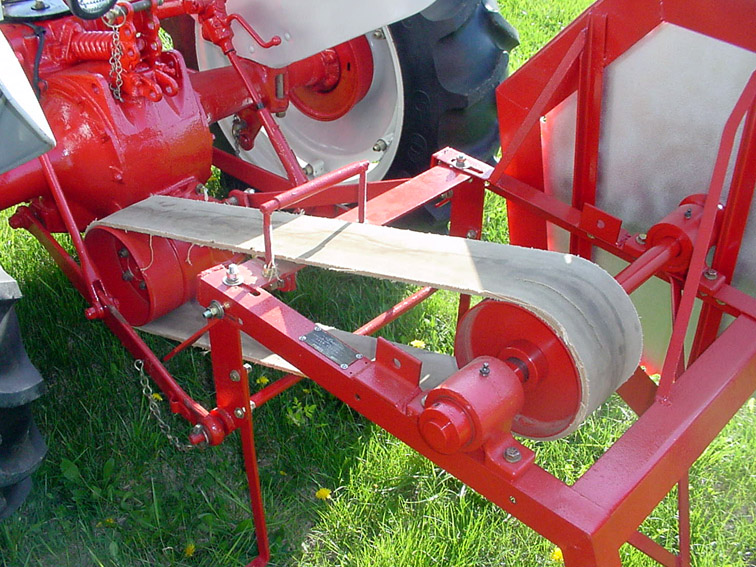

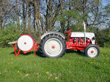

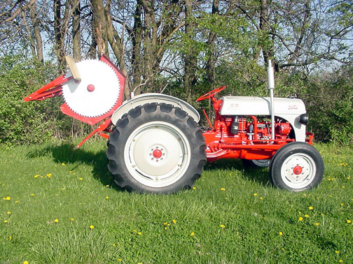

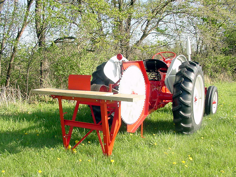

Did someone say belt driven?

I have the "factory buck saw" that was made for THAT tractor...
I haven't used it in years...
SR
That is a Dearborn cordwood saw, so it is period and correct saw for my 8N. The only part I could not restore was the paper pulley on the saw, it is steel now. Philip.
My grand dad had something like that but the PTO was on the side so the saw was up front, the tractor had steel wheels and the drive belt was made of leather. The tractor never moved and was only used to cut firewood. He used horses for plowing and such.
