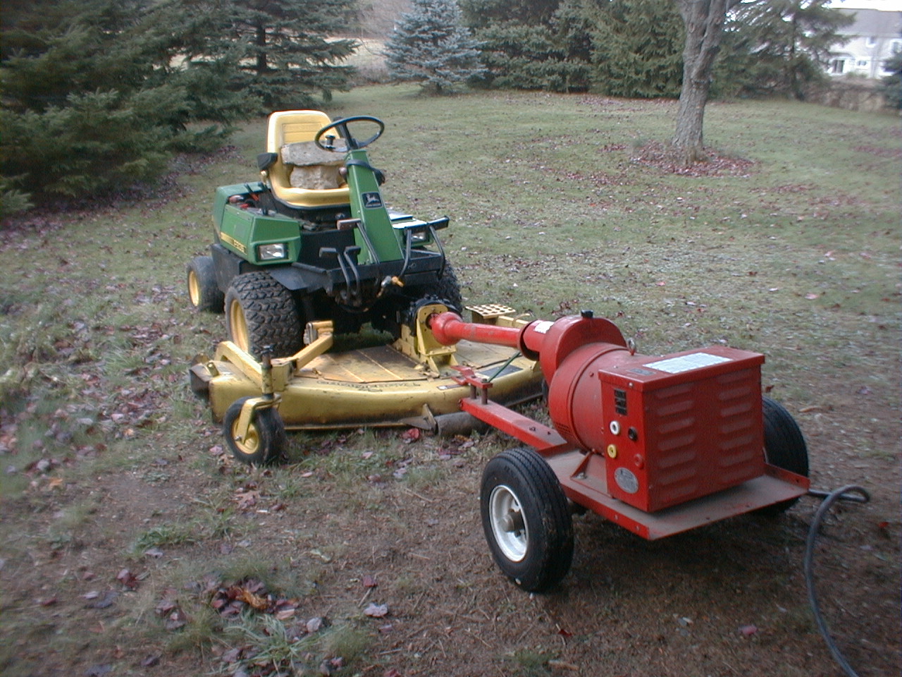

I too run a Winco/Winpower alternator. Mine is a 50 kw unit with 3 phase taps even. Got it cheap at a farm auction. I use it for powering electric power washers and welders way off the grid as well as the house. I use it on my JD 1070 (~35 hp) and my JD-F935 lawnmower (~22 hp). I use a "Kill-A-Watt" device to monitor frequency. Never really found that I needed the tractor for anything else when we are down and out. Where are you supposed to go ? No one else has juice.
You don't need power all the time, just when the house gets too cold for comfort or the horses need water. That's about a 4 -5 hour window around here at worst. My U-verse router has a 2 hr battery backup and I have a spare car battery that can run it for days. All you need to know is when the power is expected to be back on. DTE has an outage map you can view which shows the outage cause, size and expected return to service day and time.
