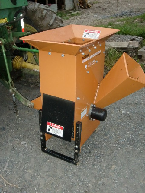

The chipping chute on the Woods 5000 (and it's Bearcat counterpart) is about 40 degrees or so off the vertical. This unit takes up to a 5" branch or trunk.
If it's a long (>10-12 feet) and consistently close to 5" diameter, I part it to 7-8 foot lengths. It really depends on the wood. Some is more dense (heavier) then others.

That's funny, I had to raise mine 9" to get it in line with the M series PTO. I still prefer horizontal feed over vertical or angled for heavy branches and knots.... The Nortrack in the pictures is direct drive. Can't see that munching up a 5.5" diameter limb unless it's softwood or the input power is sufficient and that don't mean a CUT either. Chippers are power intensive if direct drive. Looks like a royal PITA to change knives on too.
