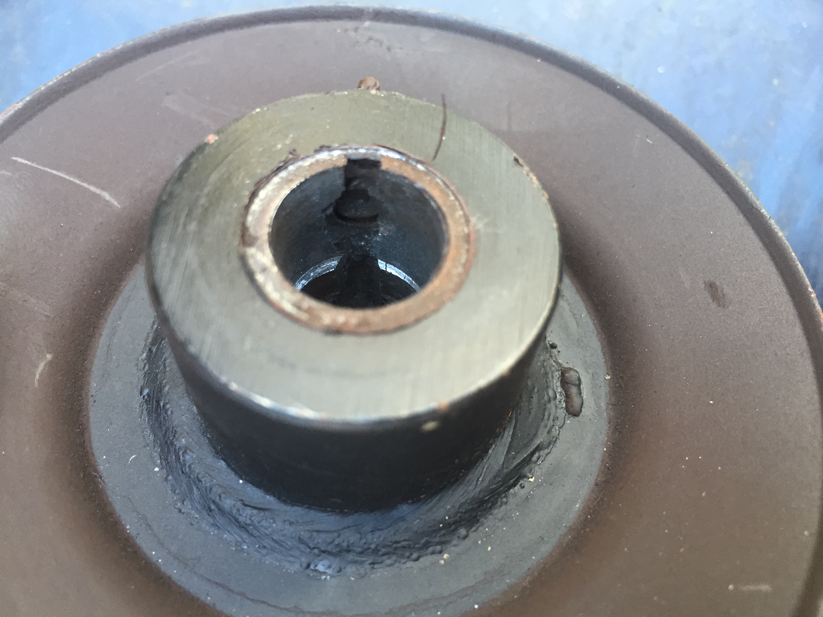

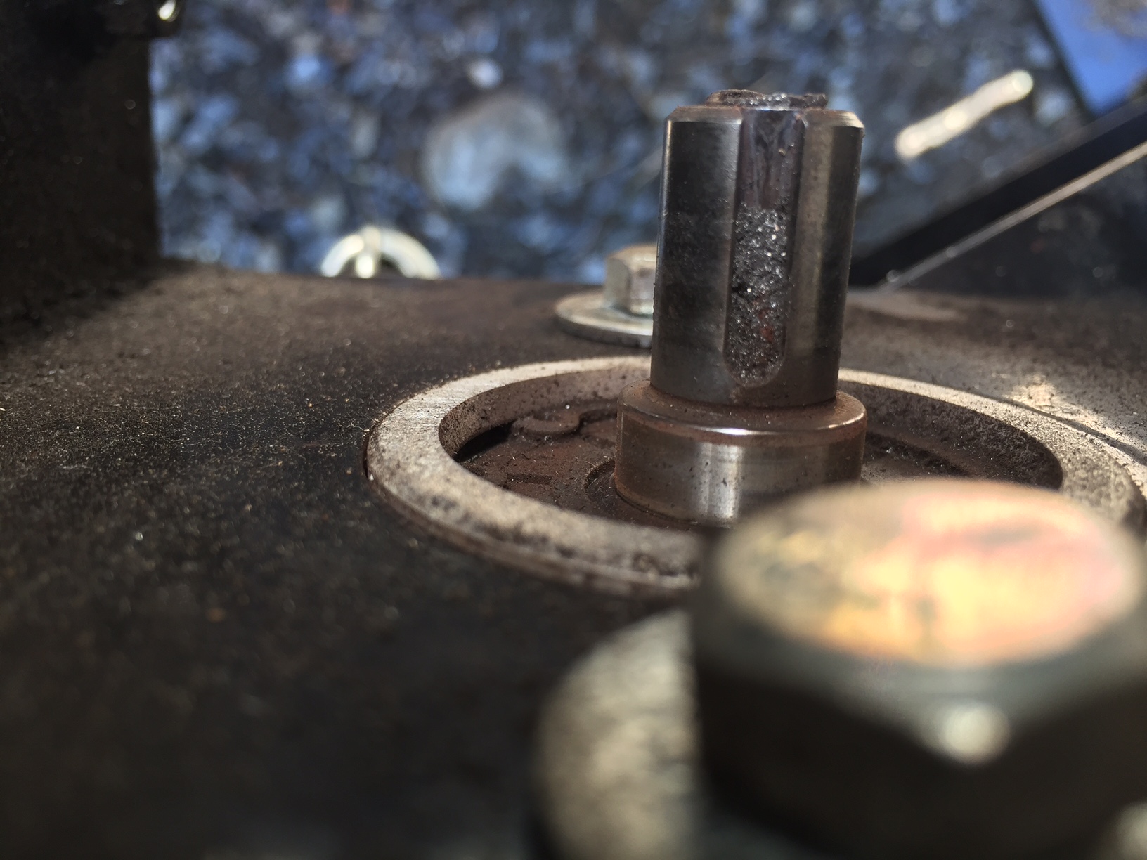

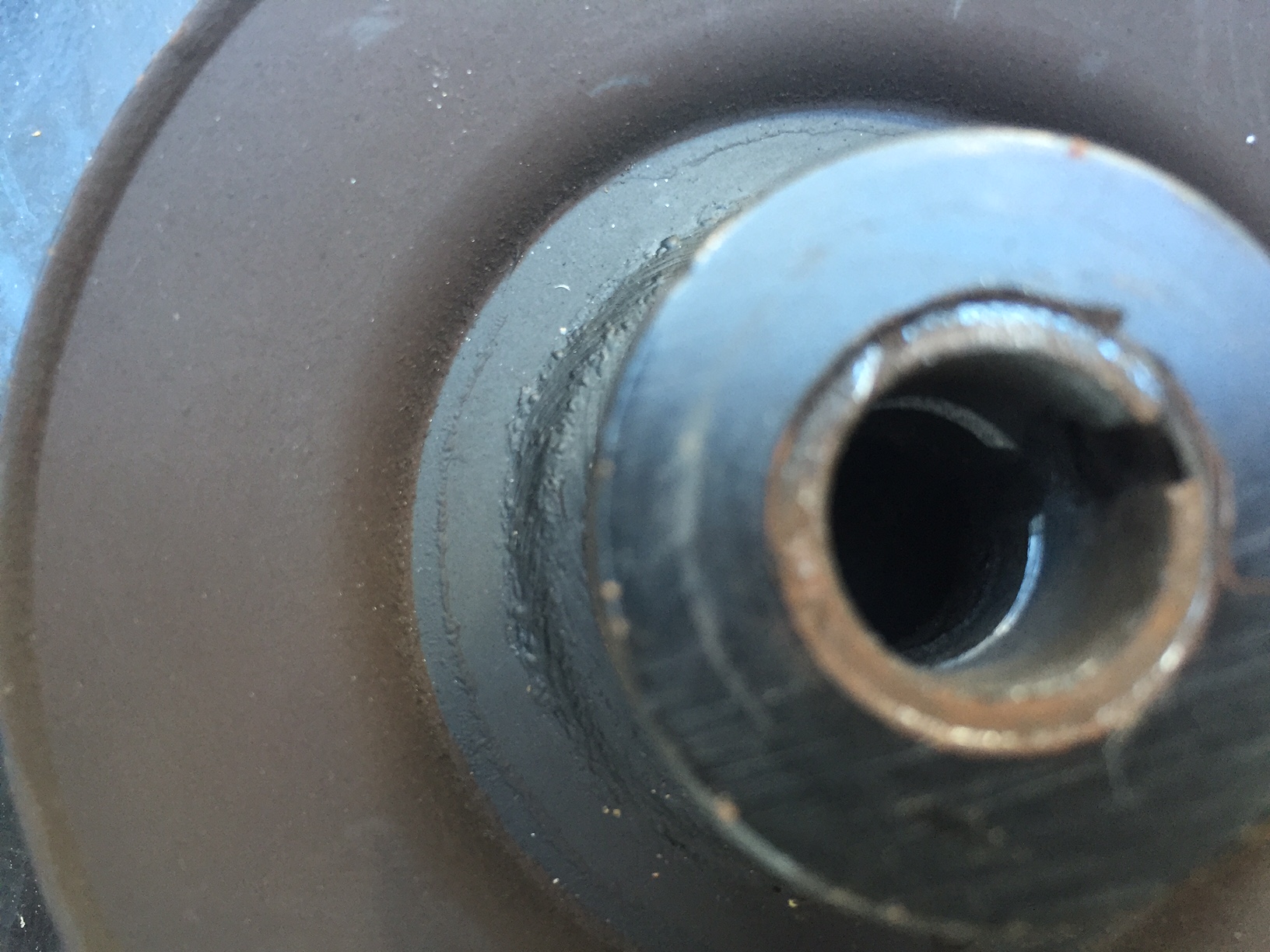

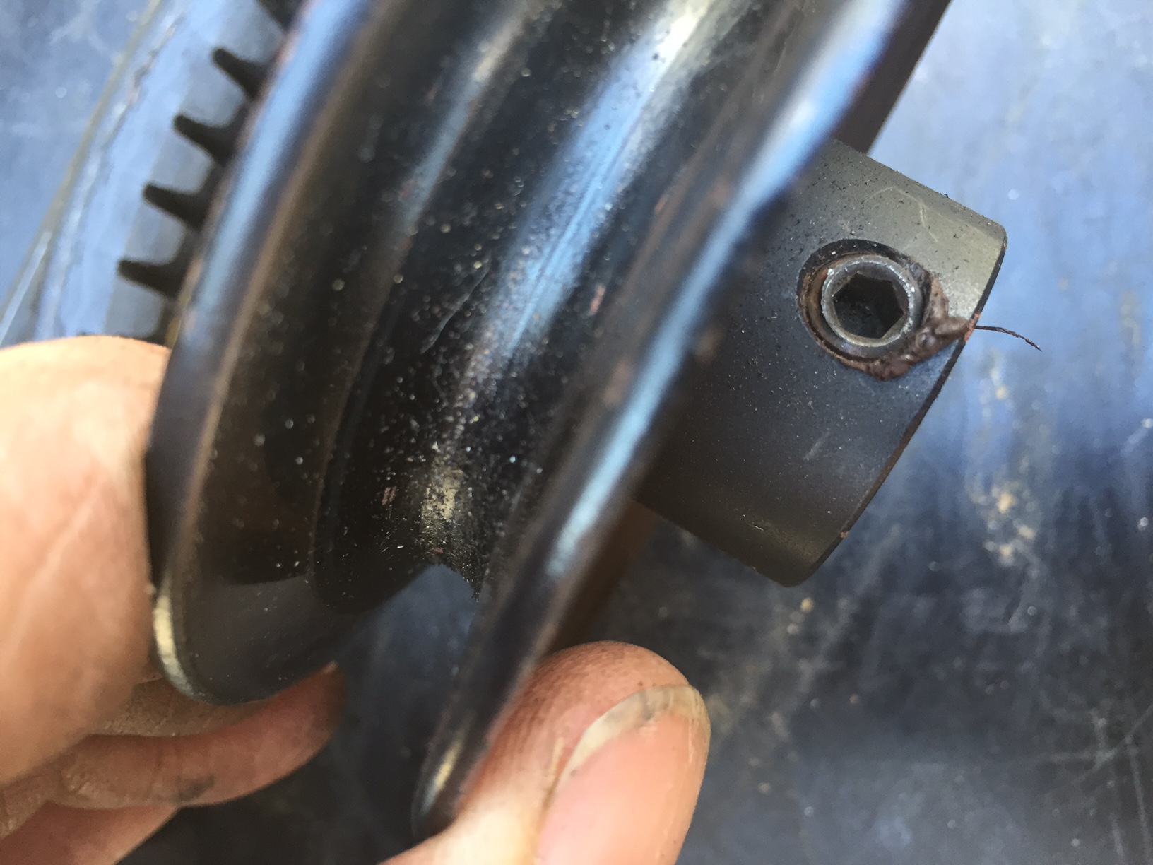

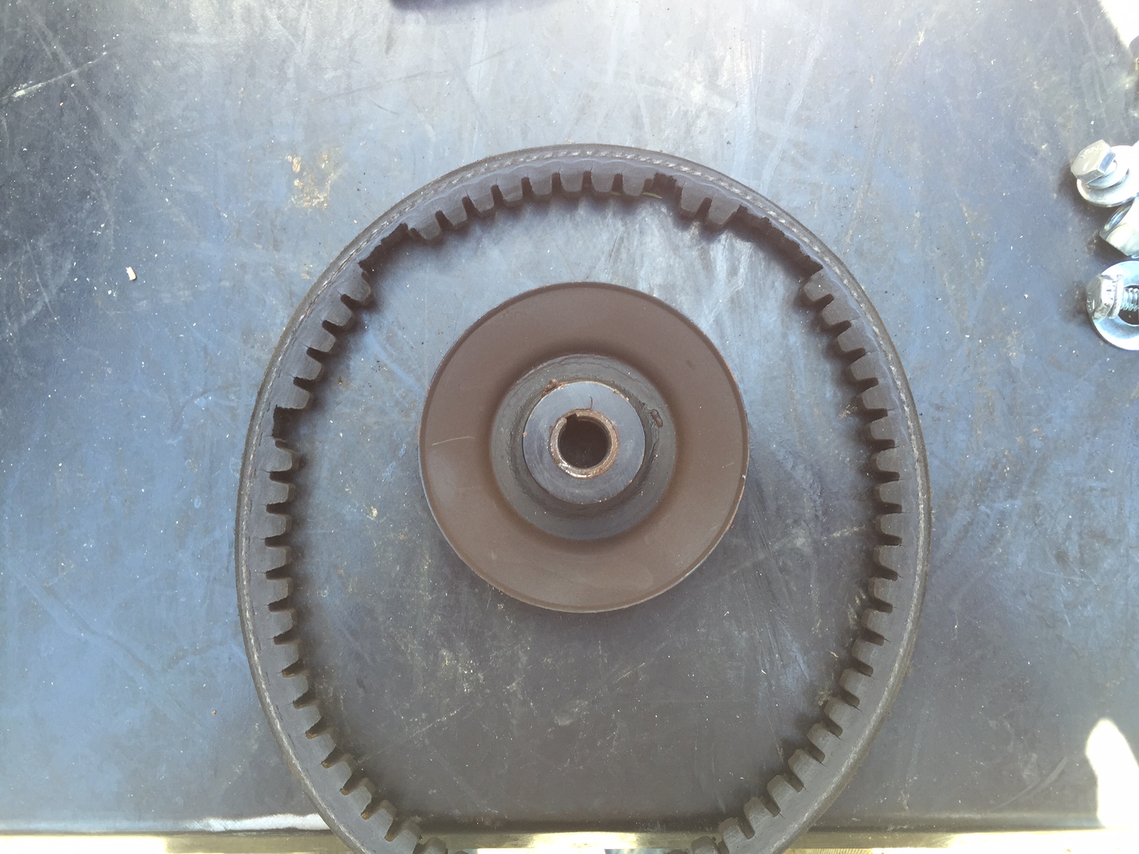

Well, I expected a breakdown at some point during my ownership of a Woodmaxx 9900 but not this soon. I have about 10 hours on it and the pulley on the hydraulic pump that drives the intake roller has failed. I took the unit apart and I need someone to look at some pictures and provide some feedback on what I've found. Based on my observation it don't appear that a key was installed in the key-way or it came out. I would think that if a key was present, there would be more damage to the pump shaft, it just looks like the pulley was spinning free. But there also seems to be a mark on the key groove where a key was driven in, maybe the key slid out because the set screw was not tightened down.
Any experts have an thought they care to share?

Much to their credit I have received an email response from Woodmaxx already this morning, and I'll share with you all.
"Hi Gary. I'm not sure how that happened but I will get you the parts you need immediately. They will go out priority mail today. Look for a tracking number in your email. We apologize for any inconvenience this may have caused you.
Sincerely,
Will"
I have also already received the Order confirmation.
