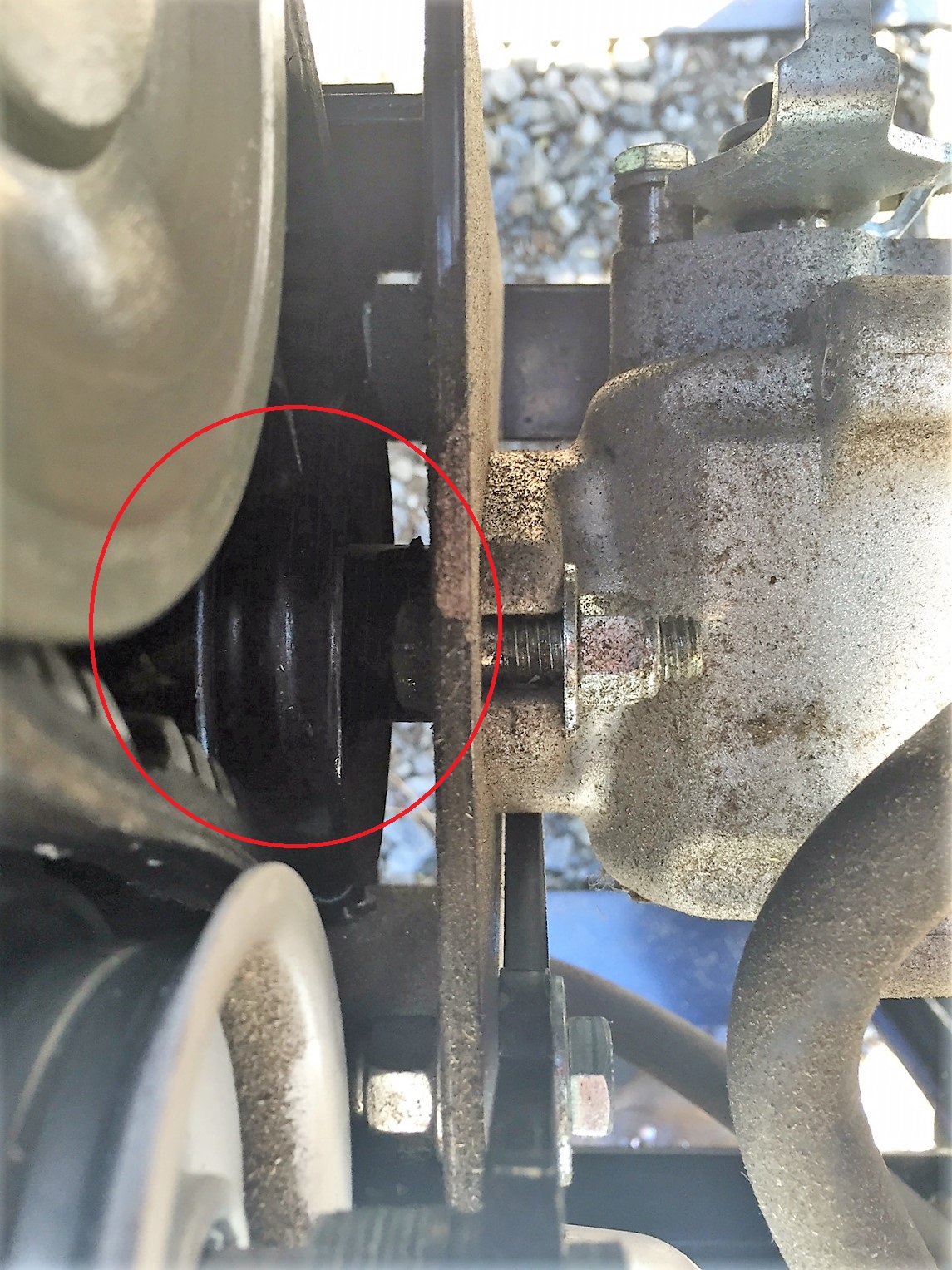

A person named Will at Woodmaxx contacted me this past Monday and informed me that the replacement parts had been shipped. The parted arrived on Thursday, and I noticed that the new pulley is a lot heavier duty than the original one and it also has 2 set screws, 1 on the key way and the other off set 90 deg.
I installed the new parts yesterday and gave the loctite setup for a full day. I plan to use the chipper today so I'll provided an update later on how it goes.

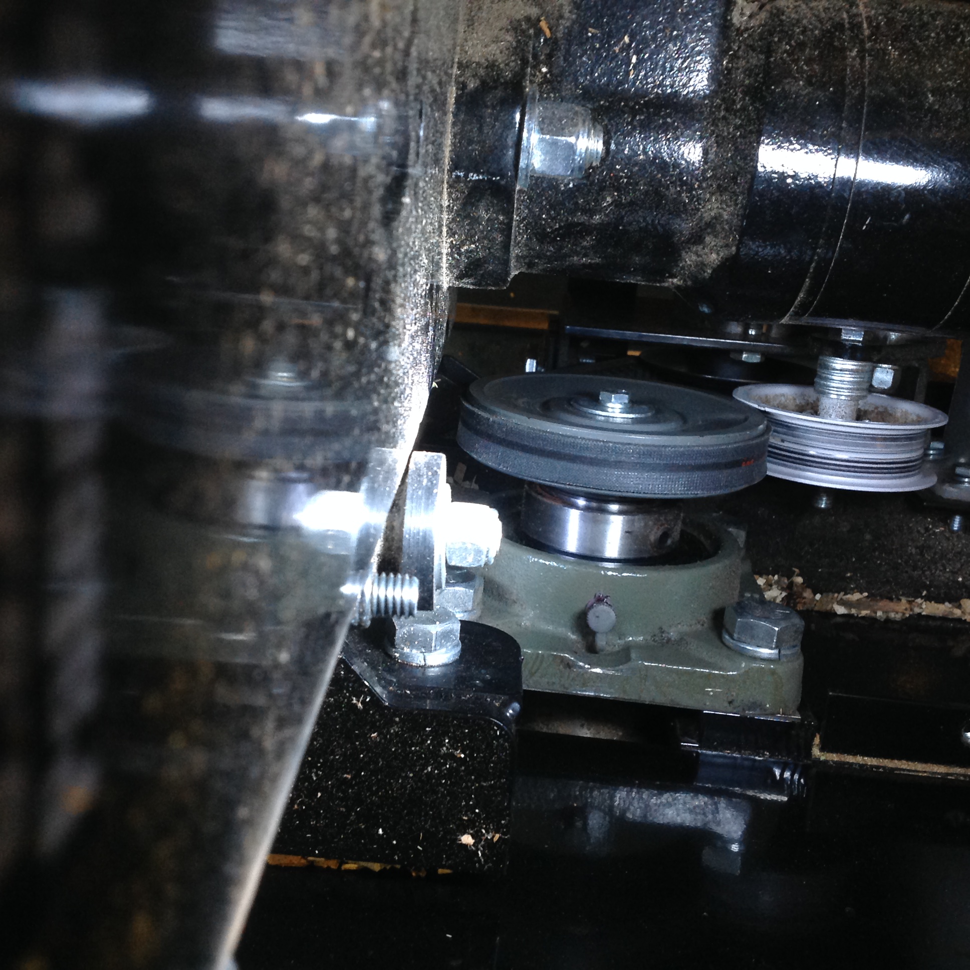

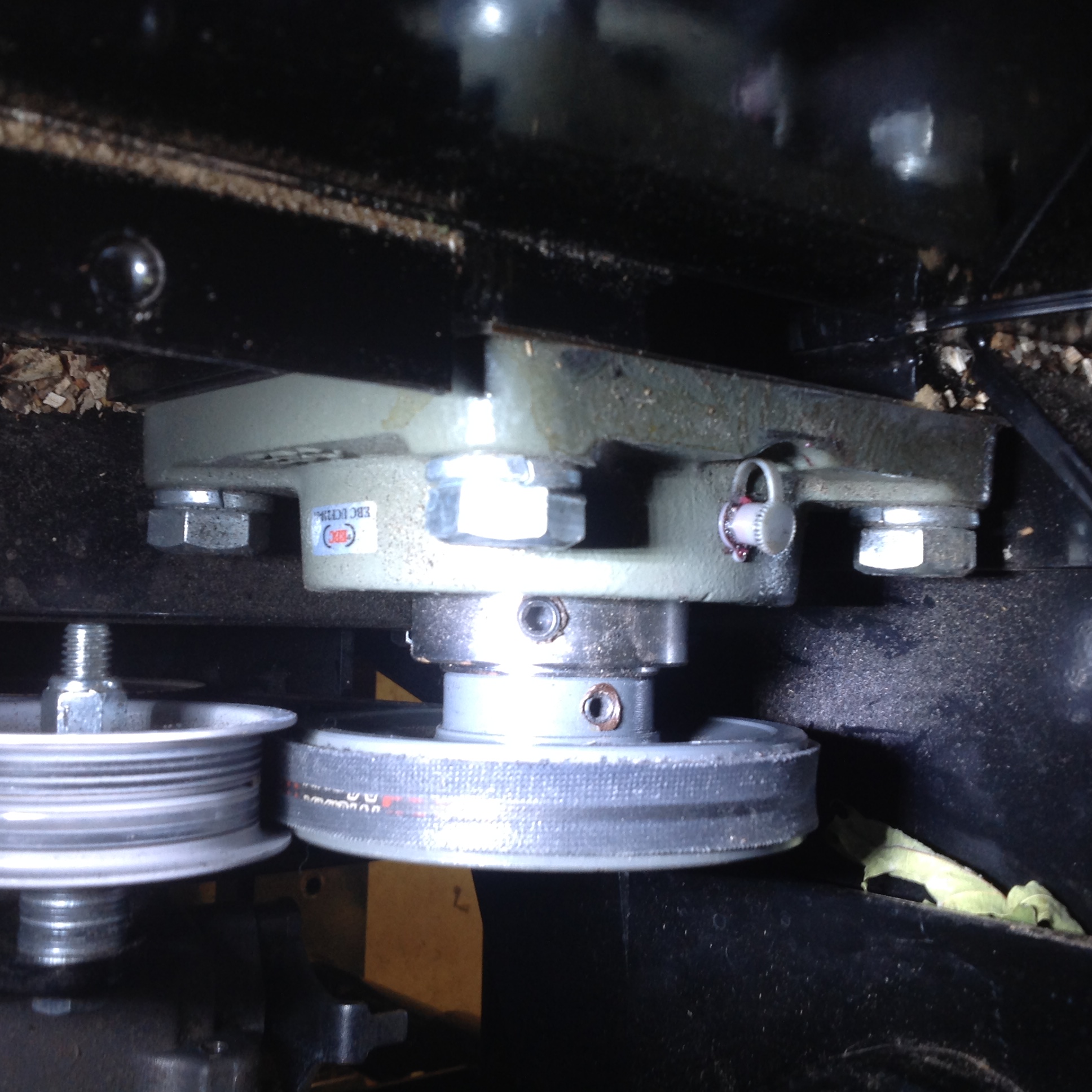

image.jpegimage.jpegGlrret, after seeing your failure, I decided to look at mine (the bearings were do for lubricanting anyway). My set screws were tight but the belt already has cracks in it. I have about 10 - 14 hrs on mine. Needless to say, I just order a spare belt. Did your old pulley look like this?

I would check your idler pulley (the white pulley on the long bolt with all the washers) to make sure it is not wobbling around and that the bearing is not bound up. It looks almost like it is dragging and causing the excess wear on the back of the belt (note that the center of the belt where the pulley drops down is not worn but the edges are).

The pulley that went bad on mine was the one on the pump, I can 't see it in the picture you provided. Here is a picture of mine when I discovered the problem. This is looking lower between the drive and the idler pulleys.
