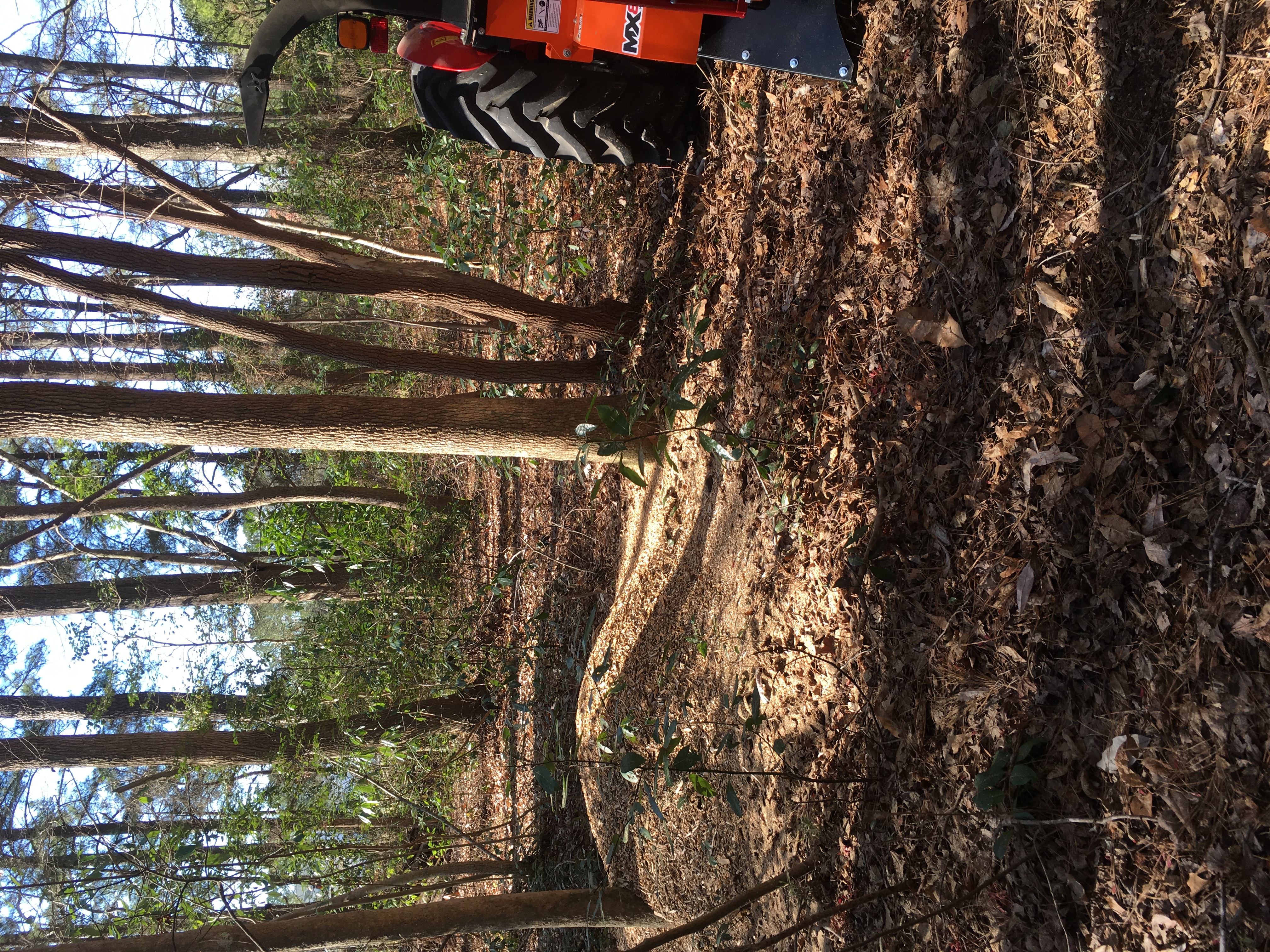

I made three piles like this before lunch, and cleaned up a lot of dead fall and junk the prior owner had thrown in the woods.
chipper ran great, speed adjustment for infeed a little touchy, not much range to go slow, likes to go fast, but I try to run as slow
as possible on larger hard wood. I believe I smelled the belts once today, gave it quite a workout and it just hummed right along.

Be careful chipping old/dead wood -- it can start a fire due to the heat/friction, and it's a *lot* tougher on your chipper knives than green wood. At the very least, alternate some green wood in periodically.
   / pto driven wood chippers #178
thank you, did not know that at all, yes, alternate with harder wood
I thought I smelled belts burning once, maybe it was the soft wood?
very good to know

It probably was the wood -- doesn't take a lot to get a whiff of something cooking when using a chipper. Old, dead, or dry wood is surprisingly easy to ignite from friction.
