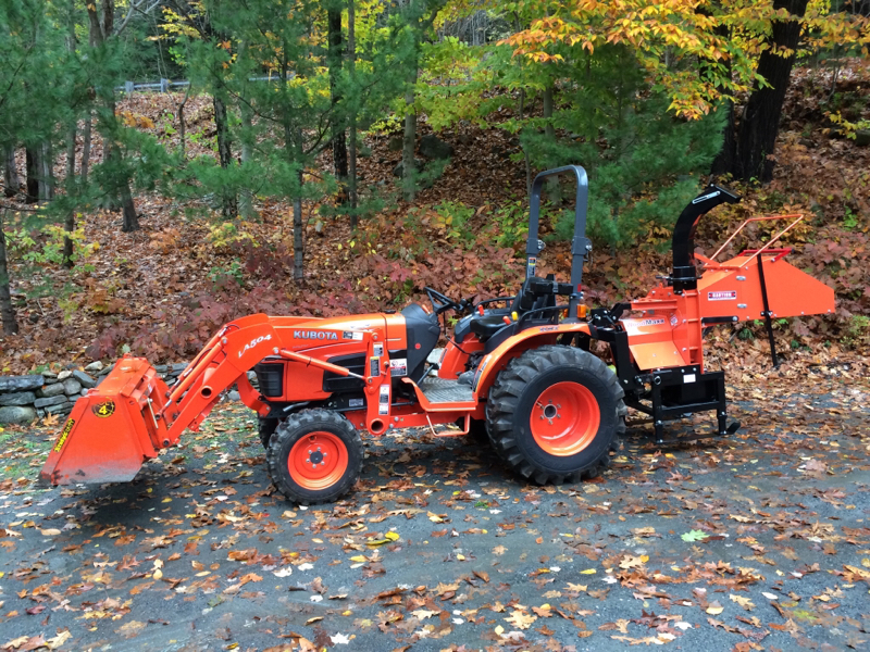

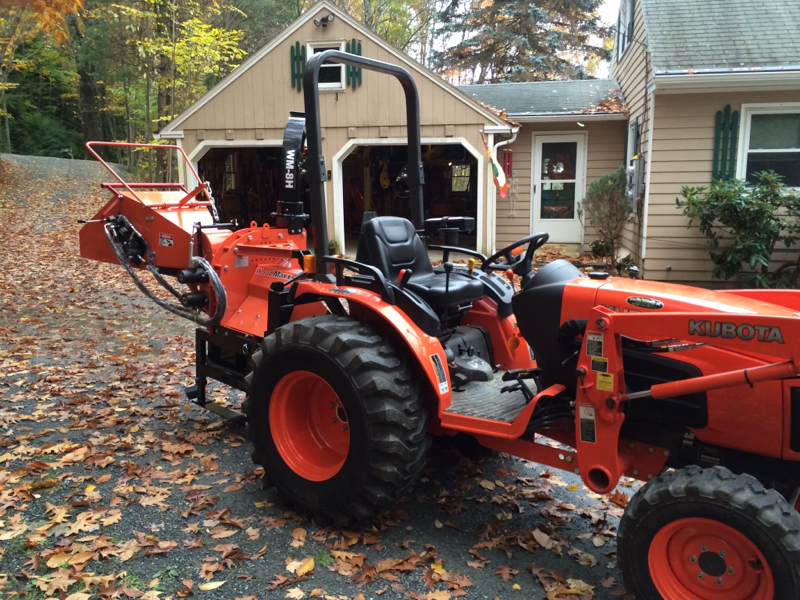

I was thinking of the 8" Woodmax and my brother offered to go in on it if I get the 9" Woodmax... he as the L3800
   / pto driven wood chippers #107
I am also looking at the hydraulic Woodmax. The reviews are good, the price is right, and there are some video reviews online.
I love mine!
