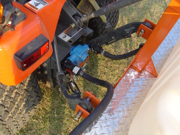

You can buy a roller pump from TSC. The attached picture shows the one I bought, its a HYPRO 6500 and ran about 80 - 90 bucks. They also sell a coupler. I've used this one to irrigate and also use it to run a sprayer.

Are you looking for volume or pressure? Suction or push more important? Always clean water or dirty water?
Different pump styles handle these things differently. You need to identify which you need.
Look to ag suppliers that supply spraying supplies to farmers. You will find whichever you need, in many sizes. Generally the small roller direct drive pumps provide pressure with little suction - the belt drive offer more volume, while some of the transfer pumps (more often on a 5hp B&S engine, but you can find pto units easy enough) provide a lot of volume and better suction. And there are styles in between.
--->Paul
/ PTO driven utility pump #5
The other guys are giving you good advice. Decide what kind of pump/pumping application you will be using.. and then get that pump.. I would gues sthat direct drive using some sort of lovejoy coupler onto the pto shaft would be a decent idea. Keep in mind that if you will be doing stationary pto work, to grease that zerk right above the pto shaft. The pto bearing / seal relies ont he oil slinger on the tranny to splash lube.. when you aren't driving, grease in the fitting does the job.

</font><font color="blue" class="small">( You can buy a roller pump from TSC. The attached picture shows the one I bought, its a HYPRO 6500 and ran about 80 - 90 bucks. They also sell a coupler. I've used this one to irrigate and also use it to run a sprayer. )</font>
I have a pump like that and it really sucks!!!!! /forums/images/graemlins/grin.gif /forums/images/graemlins/grin.gif
murph
/ PTO driven utility pump #10
It sure does. I found out real quick that the suction line needs to be "non-collapsing".
