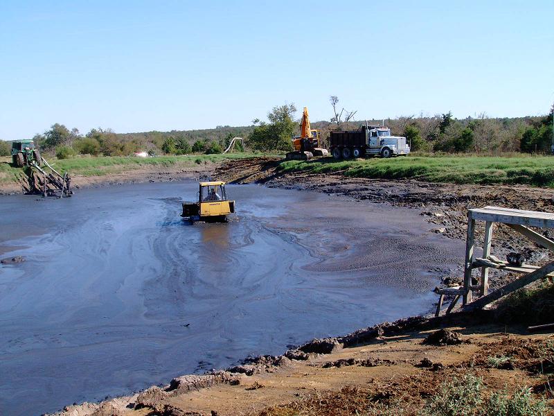

Some of the posts talked about using a trash pump. Those work well for dewatering but you are going to need a true sludge pump. There is nothing cheap or small about a true sludge pump. We had a hog lagoon cleaned out last year and I will tell you that sludge requires quite a bit of agitation and a really heavy duty pump to move it. This was all organic solids, but it still took a trackhoe, dozer and a couple of dumptrucks to get the last of it out. The company that cleaned my lagoon cleans out city waste lagoons, farm lagoons and waste ponds off of water treatment plants. My lagoon was 200'x200'x8'. The pump/agitator required 140 hp tractor just to run it and it could pump 4" to 5" solids.
Most ranchers around here have this done by a trackhoe with an extra long boom. The dam does not need to be breached and most usually the pond does not even need to be drained if the water isn't too deep. If you could divert the creek water and this really should just be a 1 day job for a pond this size and no bigger than the pond is he should be able to do a lot of it from the driveway. If you have any farms in your area you might check with your local NRCS office and see what kind of Ag contractors are in your area that do this type if work. Currently a trackhoe of this type can be hired locally for under $200 an hour and if you want a dump truck to move the debris that would be extra.
/ pto-driven sludge pump? #18
Here is a pic of the crew I used in action. Total depth of solids/sludge was 4' over the area when they started with about 3' of water. They are nearly done in this pic.
I have also done full pond cleanouts myself with a dozer. Dewater with a pump, allow the bottom to dry 2 to 3 weeks in July or August, and push everything out. I have seen people to small ponds with a FEL and a boxblade.
