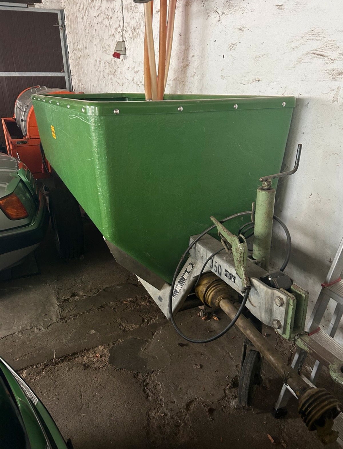

Thank you guys, much appreciate the input.i ordered some 3 pin Deutsch pigtails, they should plug right in when I unplug the original switch, it is easily removed… I will hardwire the wire in to the trailers, we have two. Use the original switch by making a easy removing mount.
I would not want the switch to be exposed to the weather while in storage, it has a original tarp but still.
Some photos of the trailers…
