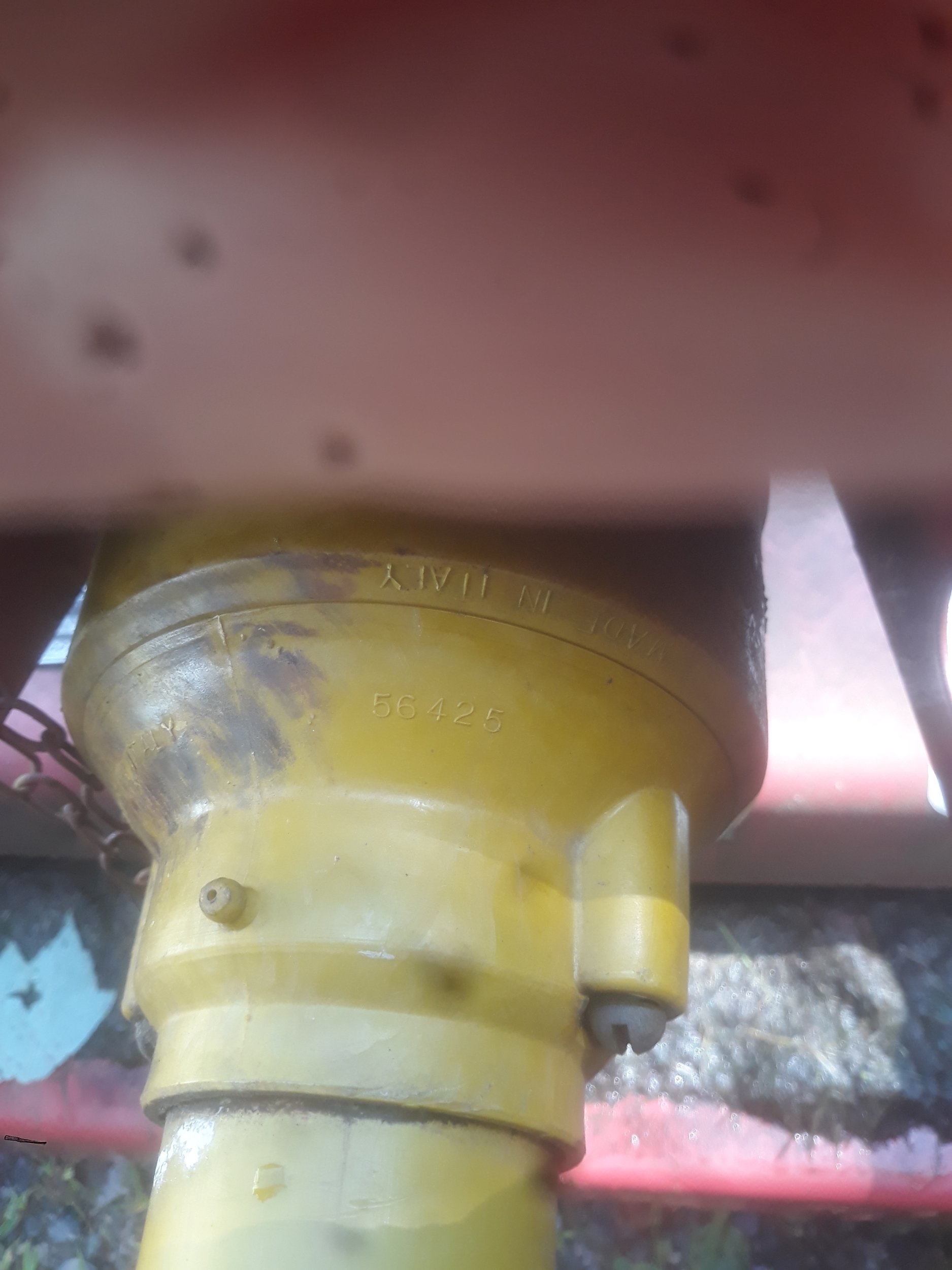

There are only two types of PTO latch.
1) Button 2) pull-back collar.
If you do not have the button, you have the pull-back collar type.
VIDEOS:
There is a third type. It's a collar type that the collar is knurled and the collar rotates instead of pulling back. I have a couple of this type.

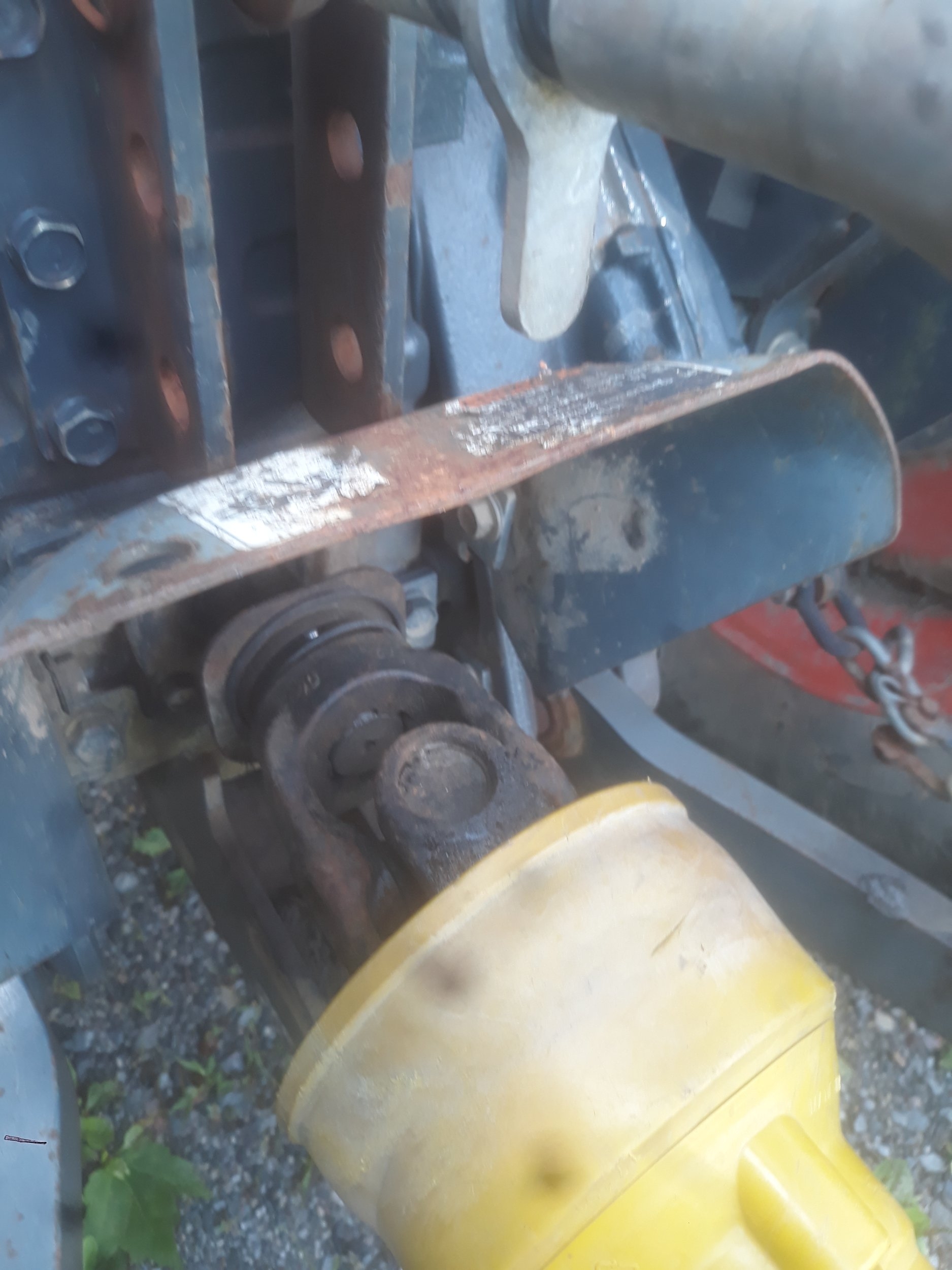

Pretty obvious: There is a bolt dropping directly down from the top link that is hitting the drive shaft. You can see the crease in the plastic. I can imagine the racket this makes with a rectangular shaft section internal to the plastic cover.
Rotate the top link so this bolt doesn't make contact no matter what position the lower links are in. My guess is that the bolt was added to help you rotate the top link in order to set height, angle, whatever, on other attachments. It may actually be locked in this position by a jam nut. Rotate the top link 90 degrees in either direction and try to find out how to now lock the thing from turning on it's own. Sometimes there is an oblong washer looking deal that is threaded and used to lock out any top link rotation.
The contact force may have been so severe that it pulled the shaft off of the tractor a bit, or even bent 1 or more parts.

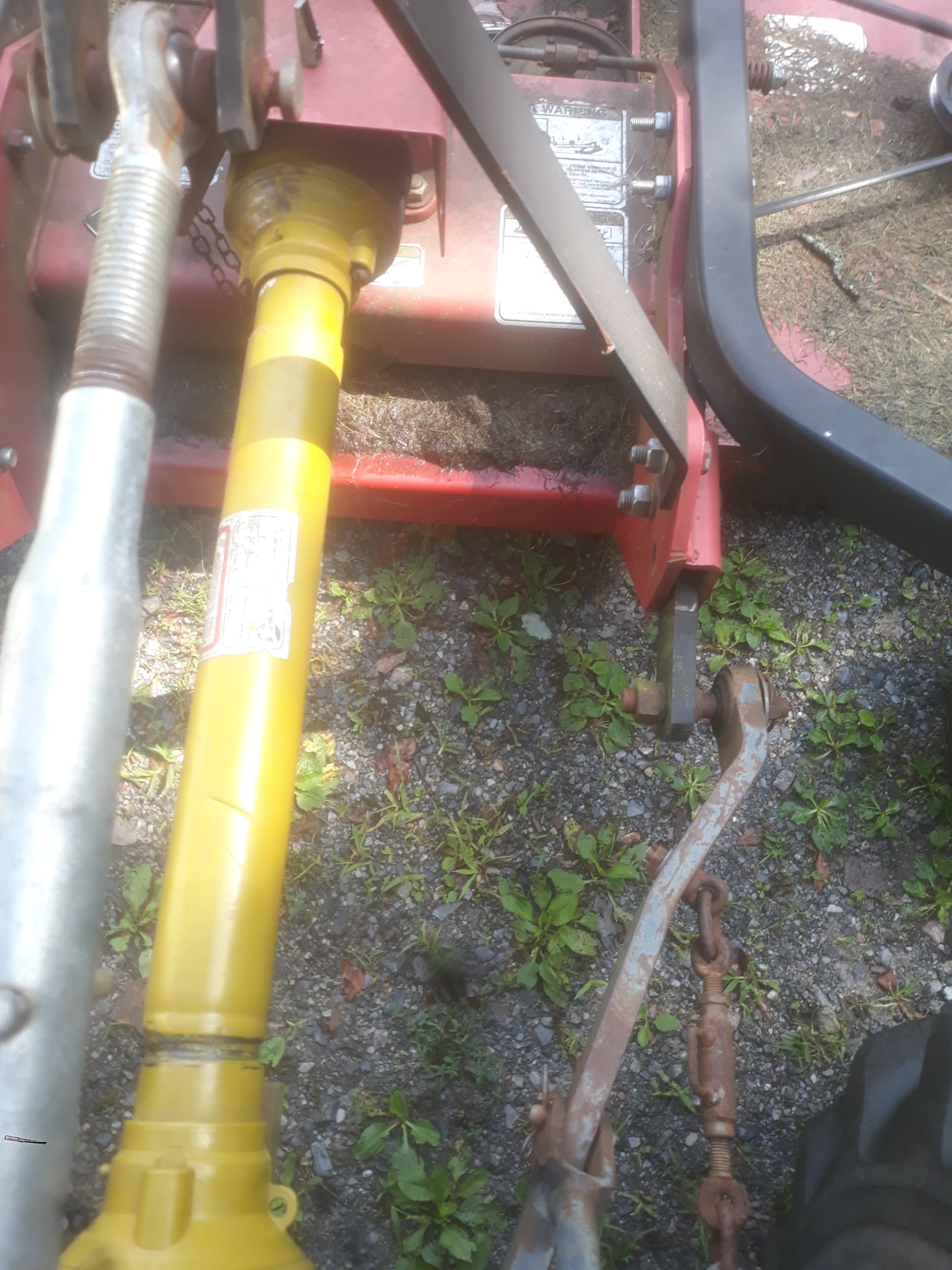

In the second picture it doesn't look like you have very much range of motion in the telescoping of the PTO shaft or at least the cover. There may be plenty but I would watch as you raise and lower it to make sure it isn't bottoming out.
This I don't understand but I will pass it along to the mechanic when he comes to replace the belt. This is a Kubota tractor mechanic and they don't sell Bush Hogs so that is why he is not familiar with my mower. In fact, I'm not even sure if he services any mowers, although the company he works from sells all sorts of farm machinery. Wonderful service!!
