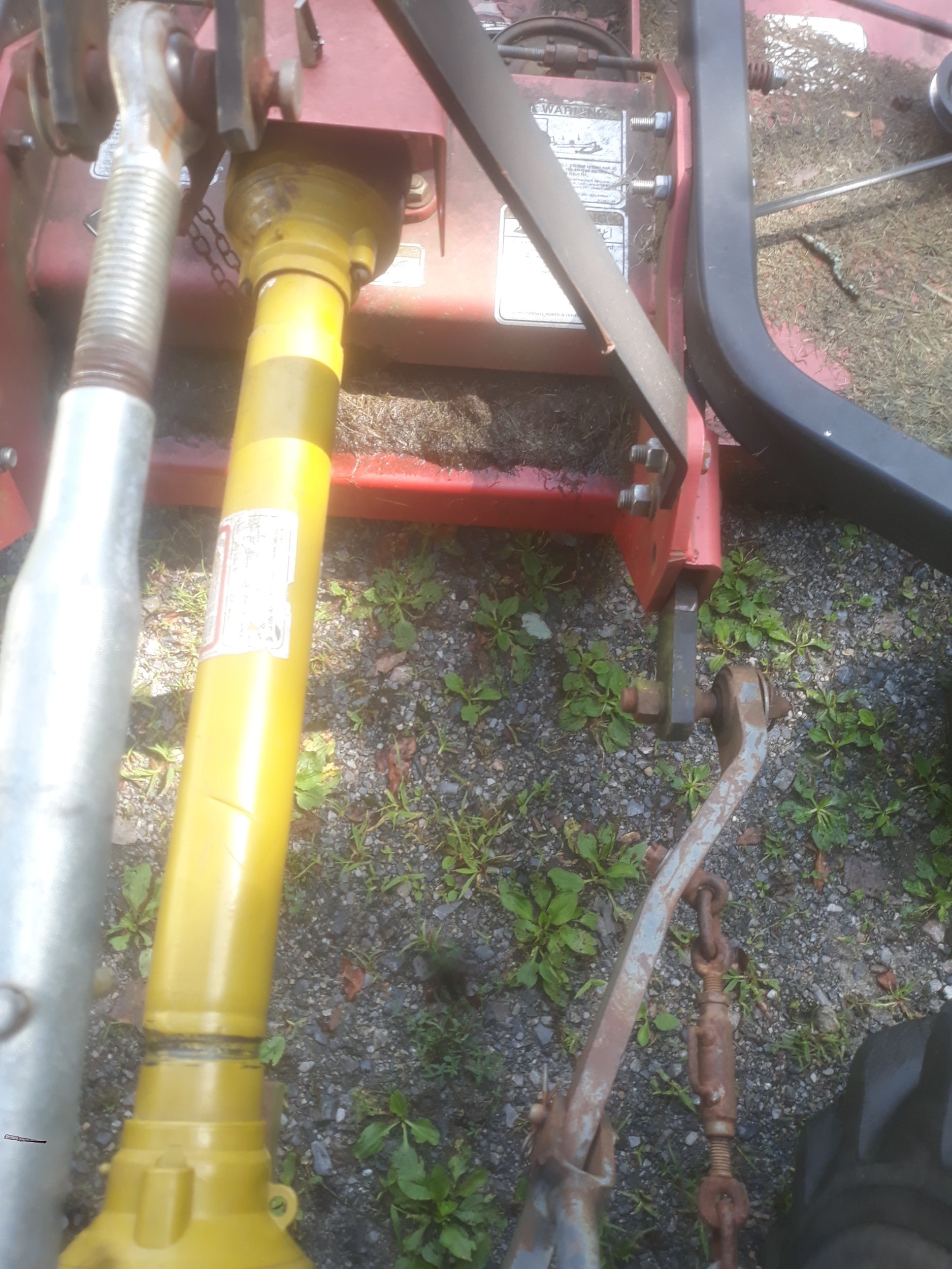

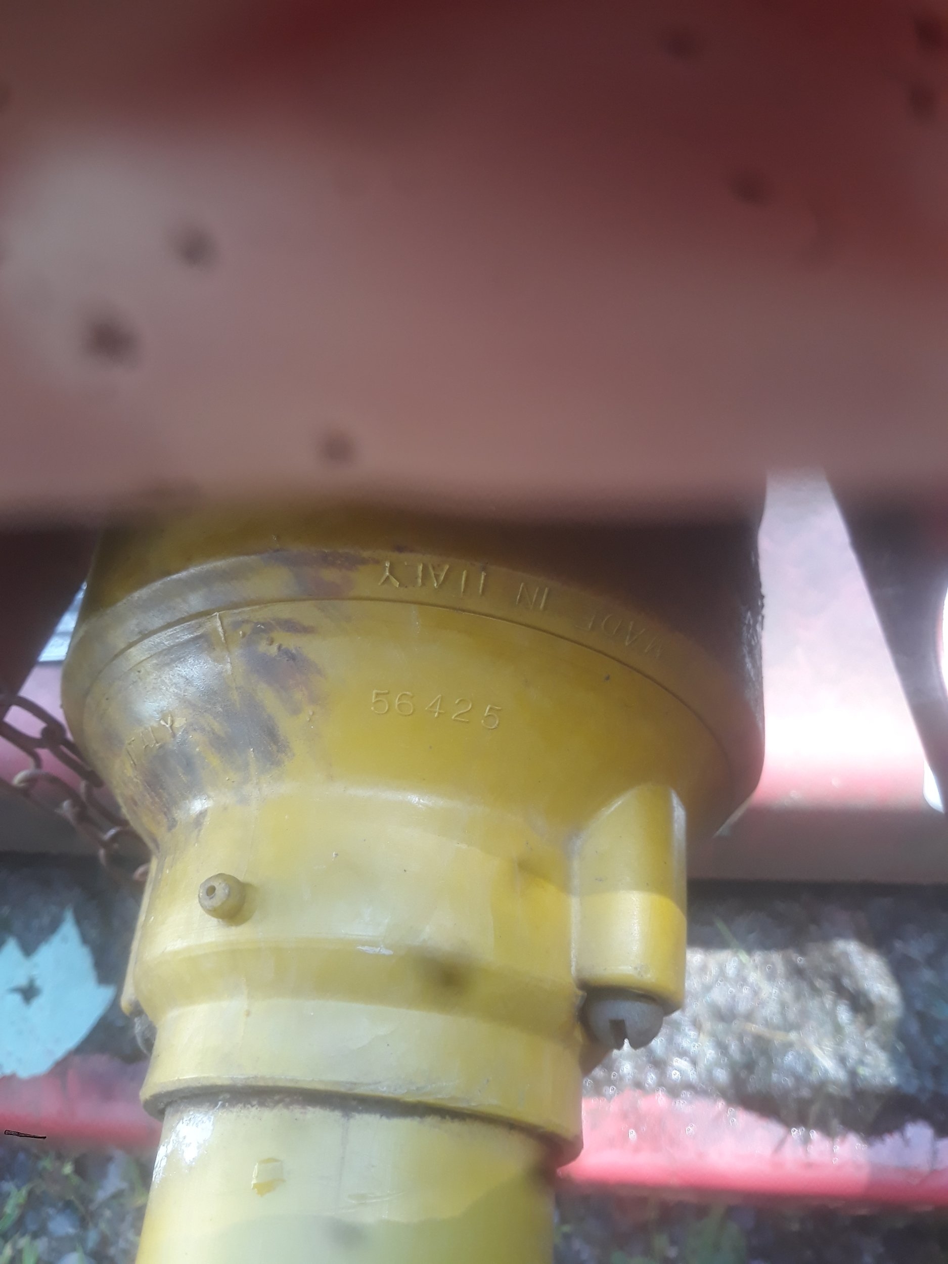

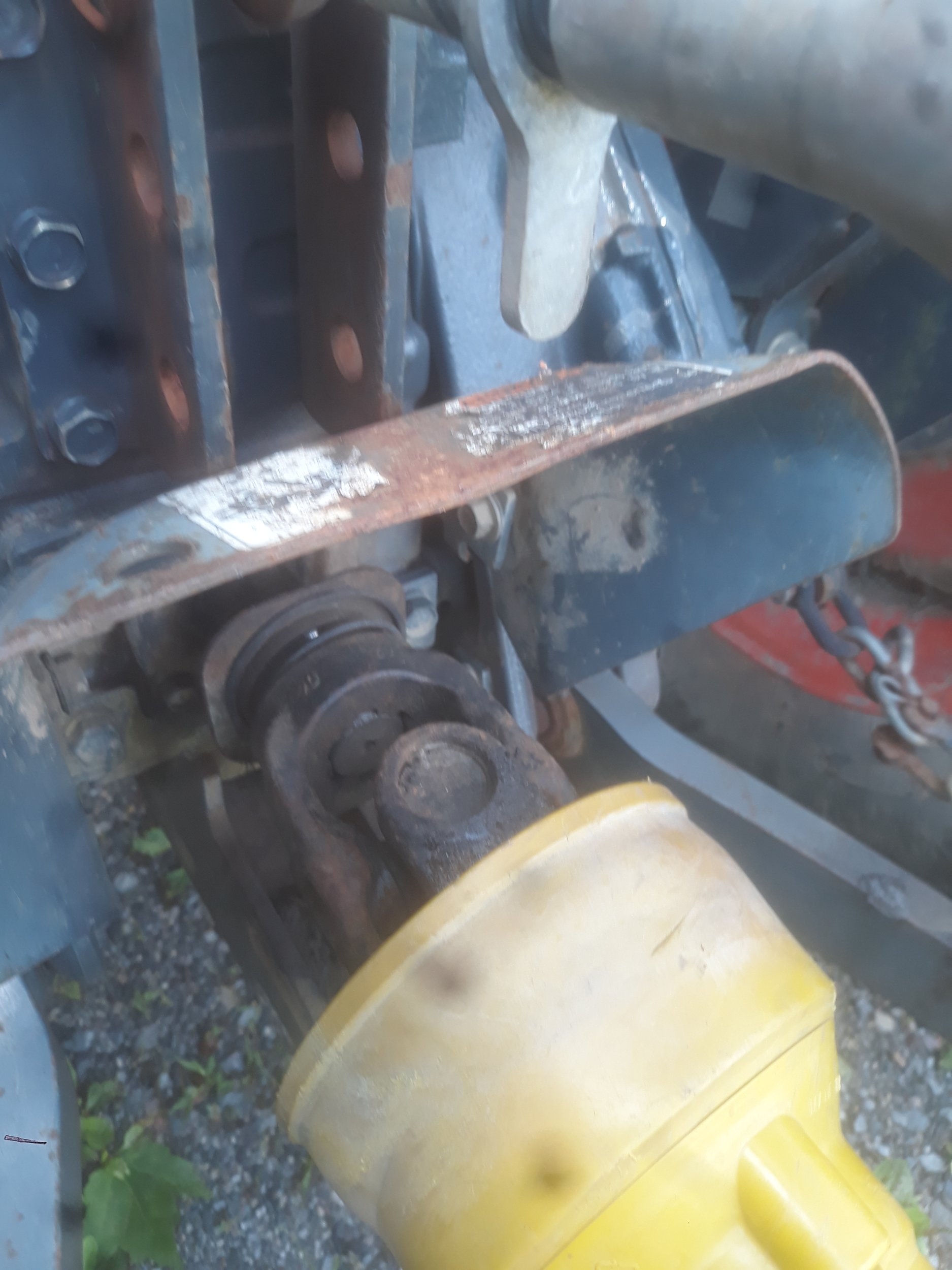

Here are three photos. It's hard to take pictures in this location. From here, tell me what angles you want. Note that there is no 'cover' on the tractor pto.
Also, can someone tell me what that chain on the shaft is for?

That helps. Where the shaft attaches to the tractor you have to pull back on the plate with the spring behind it closest to the tractor which will disengage the lock and then you can slid the coupler off. This may be difficult since it has been attached for so long.
The chain is to keep the plastic shield from spinning.

On your 3rd picture look at the flat plate/collar that is on the pto shaft that is closest to the tractor. That should pull back and allow the shaft to be able to be pulled back off the tractor’s spline

So that shaft should have a shear bolt located under the plastic shield where it connects to the mower. Is this where the handy man thought the noise was coming from?
If so, I would think it has sheared and the shear bolt needs to be replaced.
I'm not sure. He wasn't specific. I only let it run for a split second so that we could trying and identify the location.
The sheared bolt thing....I hope that's it. In any case, this is going to be another call to Kubota.

Shear bolts are intentionally weak/soft Grade 2 bolts.
Shear bolts for compact tractor implements, such as a Kubota L3400, are usually 7/16" in diameter. Length depends on the implement.
This is a common bolt-Grade and bolt-diameter readily available at hardware and farm supply stores for <$2.00 each.
