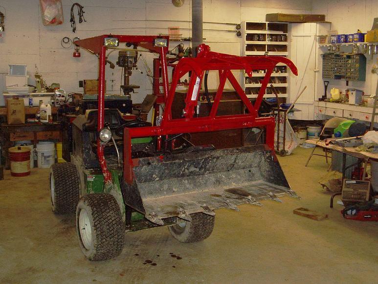

Moss I sure am looking forward to you getting your grapple done. I really wouldn't suggest anyone building a grapple the way I did. Hind sight I think that there would be much less welding, less material and labor to build one the way Power-Trac does. Mine seems to work just fine it just took about twice as much everything than it should have.

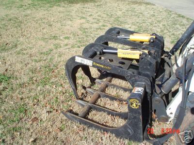

How about this grapple.

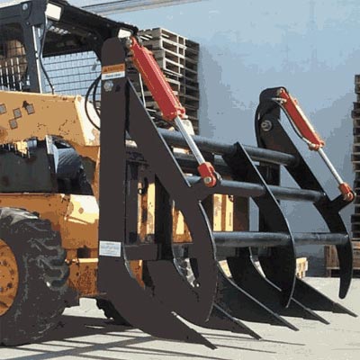

   / PT425 Grapple Build Project #96
If you have a torch and welder, this one would not be too hard to fabricate. Thickness of the steel could range from 1/4 in up to 3/4 in. Spacing would depend on what you are sifting.

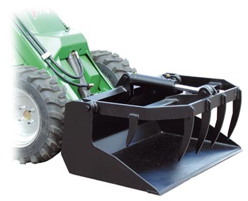

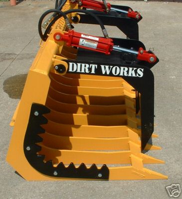

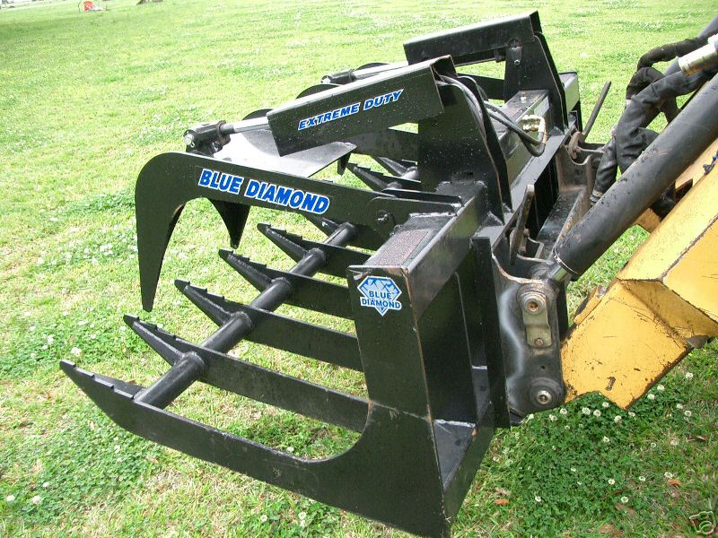

David, Check these pictures out and see if they help'
