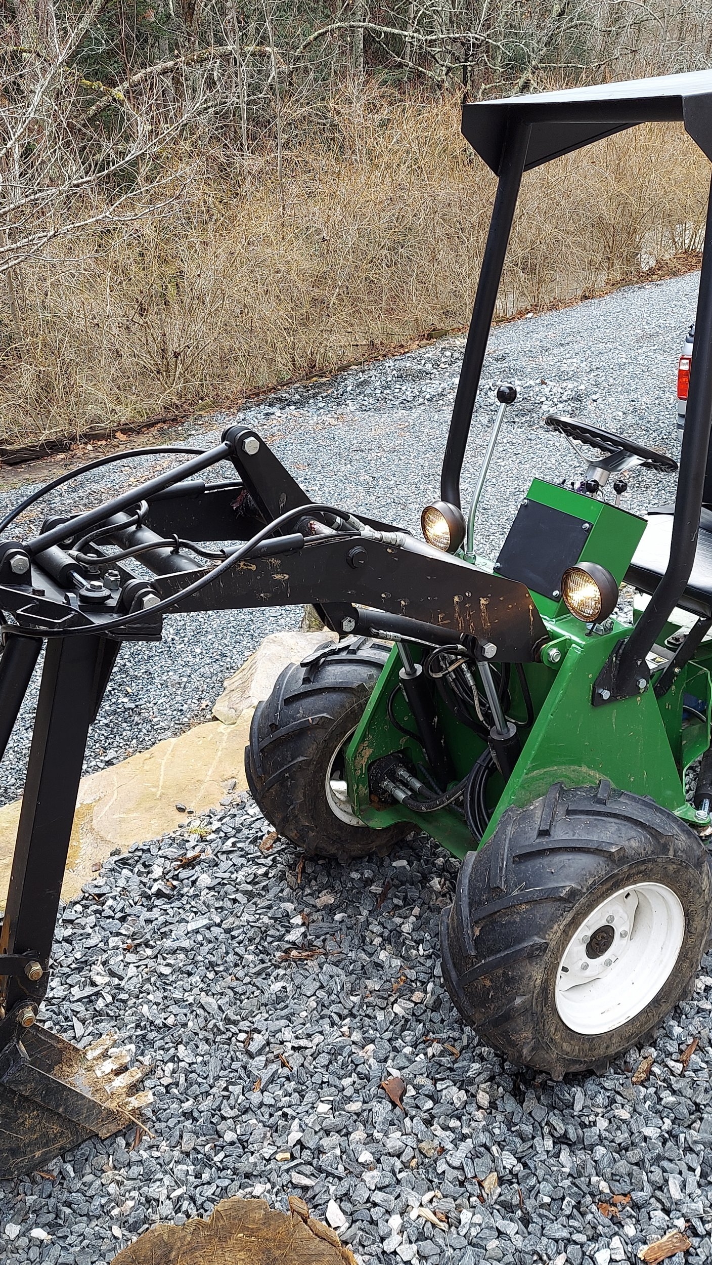

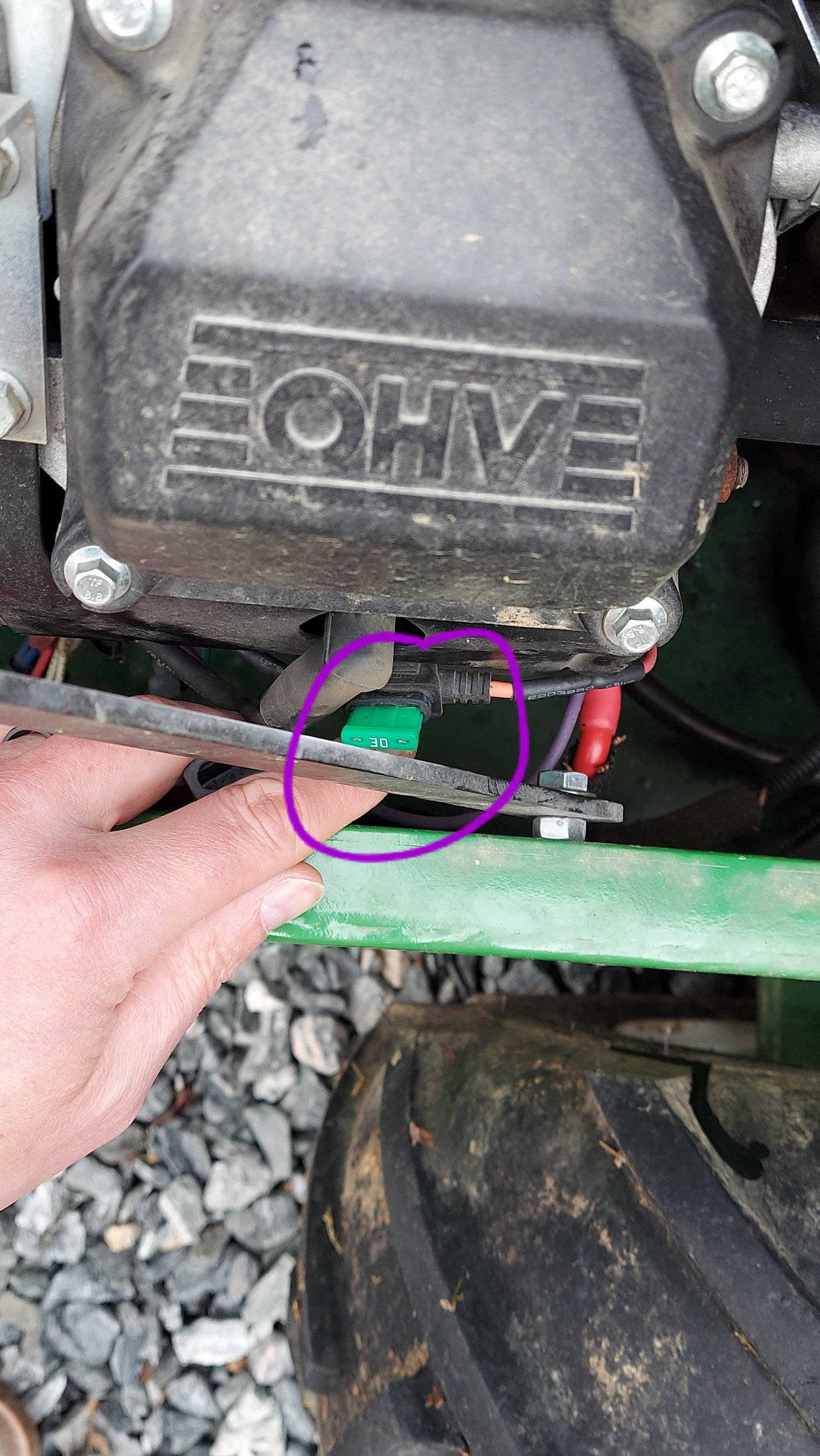

Thanks for the warm welcome guys. Great to be here. Also love how fast the response was... awrsome network of info here on TBN.
Got it figured out last night. The Kohler engine on the PT425 has a 30A fuse in place for this type of screw up. No breaker to reset on this lil puppy. Pulled the fuse and it was blown. Went to Napa today and put the new fuse in... she started right up. Napa had the bulb I needed too.
Pics of fuse and bright lights attached.
I also gave Terry a call this morning. He's sending over a new bulb and housing along with a 30A fuse. Great guy.
