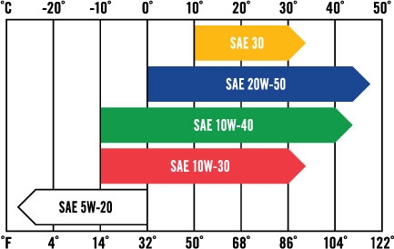

Yes it's the Kohler I just got it yesterday I ran what gas was in it out and put 5 fresh gallons in it after it cools it fires right up and runs maybe the Hydraulic oil is getting hott but I feel like the engine should run at least.. another thing do u know why it has motor oil instead of hydraulic oil just a side thought

Fixed hydraulic systems tend to run at a single temperature, and the system and oil is designed for that. e.g. a hydraulic elevator or a production line. Mobile equipment has to start under a wide variety of temperatures. Some manufacturers decouple the hydraulic system to start up the engine, and then have a warm up period before they recommend use of the equipment. This reduces the load on the starter, and the pumps. Power-Trac tractors don't have a clutch, so the starter has to spin the engine, and the pumps, with all of the cold oil, when starting. Switching from a "typical" 30W hydraulic oil to a 15W40 oil reduces the cold viscosity by a factor of 2-4 fold. That's a big deal. A 10W40 also has a much better high temperature viscosity compared to a 30W oil.
Would adding more oil cooling help a 30W oil survive? Sure, but it costs horsepower. A 30W would also basically require an engine/ oil heater when cold, adding user friction, and probably some weight. Some users, e.g. @MossRoad plan their snow days to start the PT and let it idle for a while (15 min?) to warm up while they do something else (like shovel some snow). Others have installed glue on heaters, or use torpedo heaters when it is cold. Whatever works best for the owner; we all live in different climates. On my 1445, below 40F, I take it easy for 10-15 minutes, and I'm prepared for the hydraulic controls to be a bit sluggish until the oil warms up. Cold weather starting would be a lot worse with a straight 30W hydraulic oil.
So, I think using motor oil is Power-Trac's way to thread a couple of conflicting constraints. I change my hydraulic oil every six or seven years, mainly because I view it as really inexpensive insurance. Changing the fluid gets new antiwear compounds, new antioxidants, and gets rid of any fine suspended particles. I do try to always use brake cleaner to clean couplings before attaching them, and when not in use, I try to keep covers on the hose ends, or have them coupled together.
