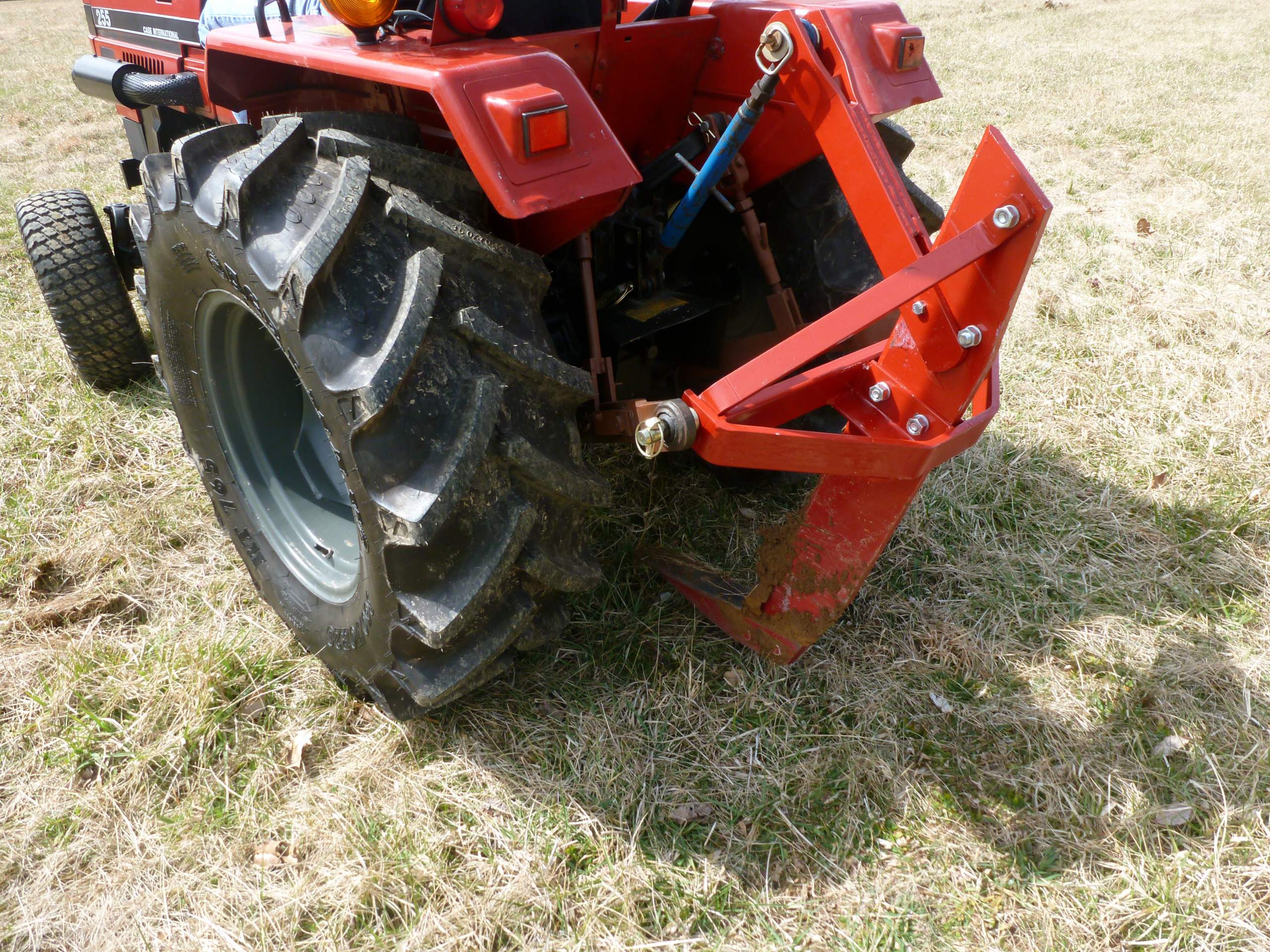

Seriously oversize R1 tires on the rear and new turf tires on the front, which really should be tri-rib or something else with better lateral grip. I am also installing a 300 pound weight box in front shortly.

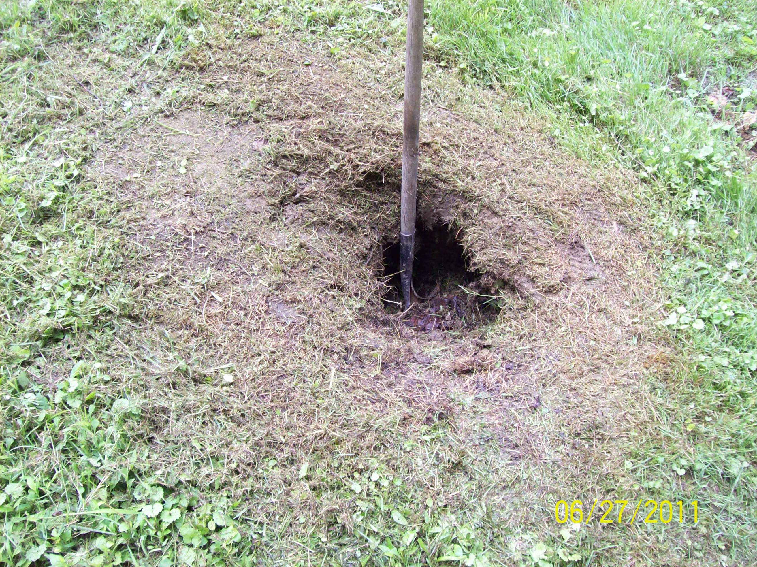

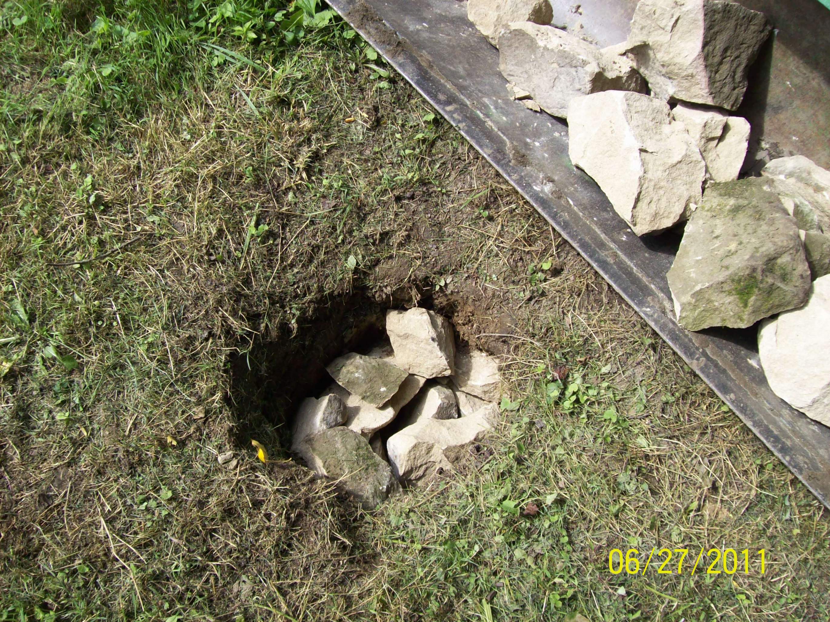

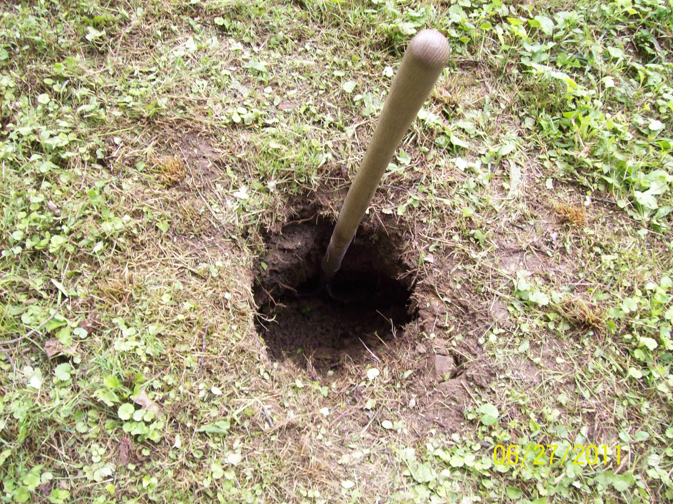

Here's a picture of one of the hills that I have to back up when mowing.. (It's steeper than what it appears in the picture).... Also, pictures of some holes where some old stumps was on the hill... I filled them full of rock and then filled dirt over the rocks! :)

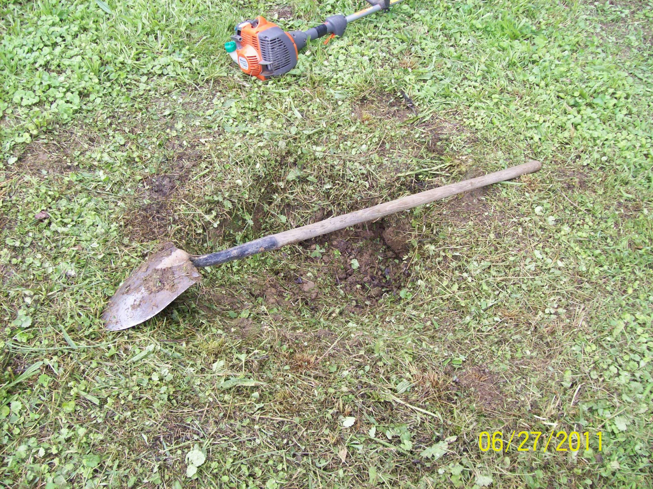

And I found some pics I took to illustrate why even shallow slopes can be super dangerous if the ground gives out underneath you. My retired doctor friend was very lucky to crawl out from the bottom of his pond, and I do mean crawl with many broken bones including his back. Do not do this at home...
