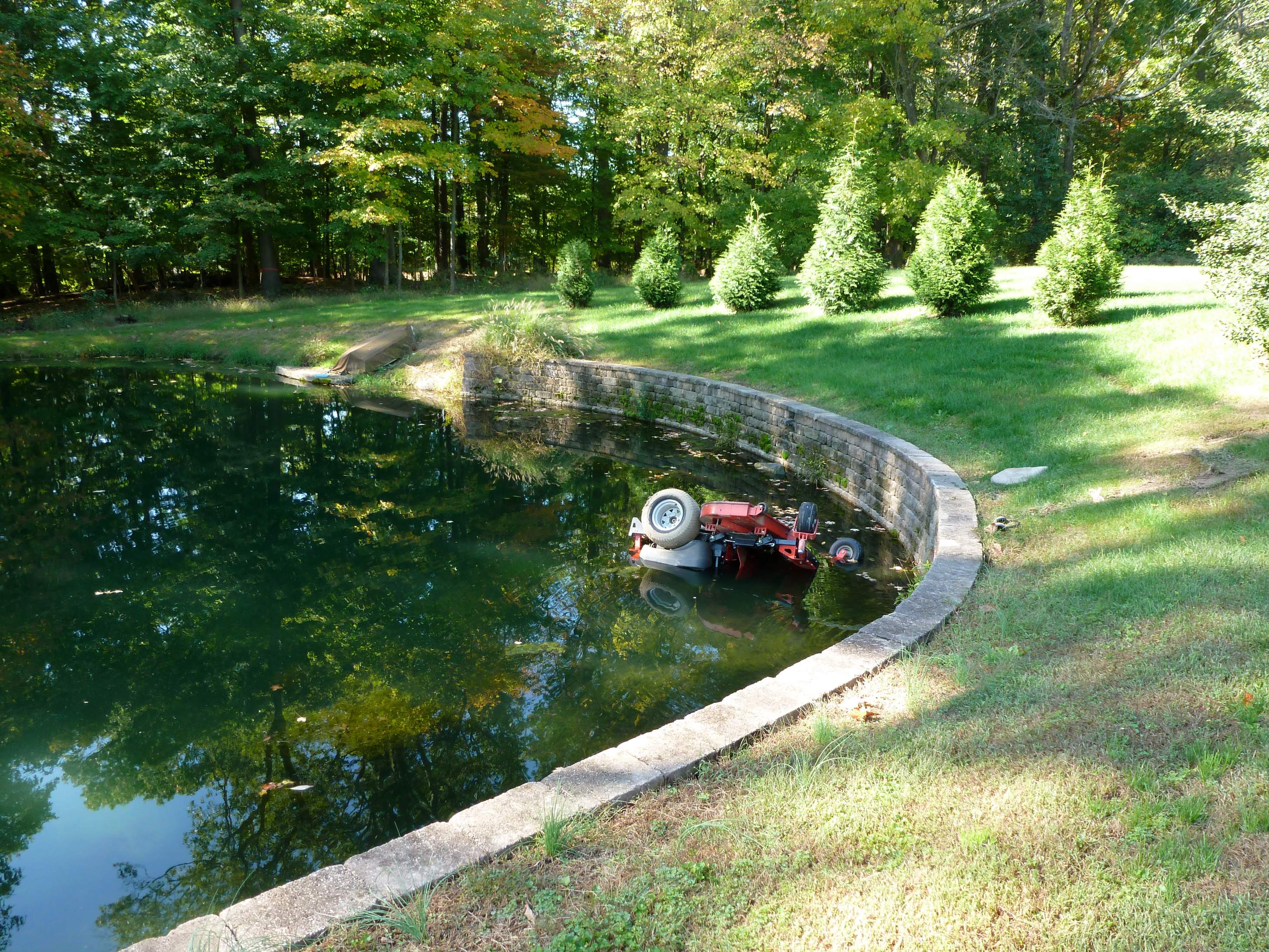

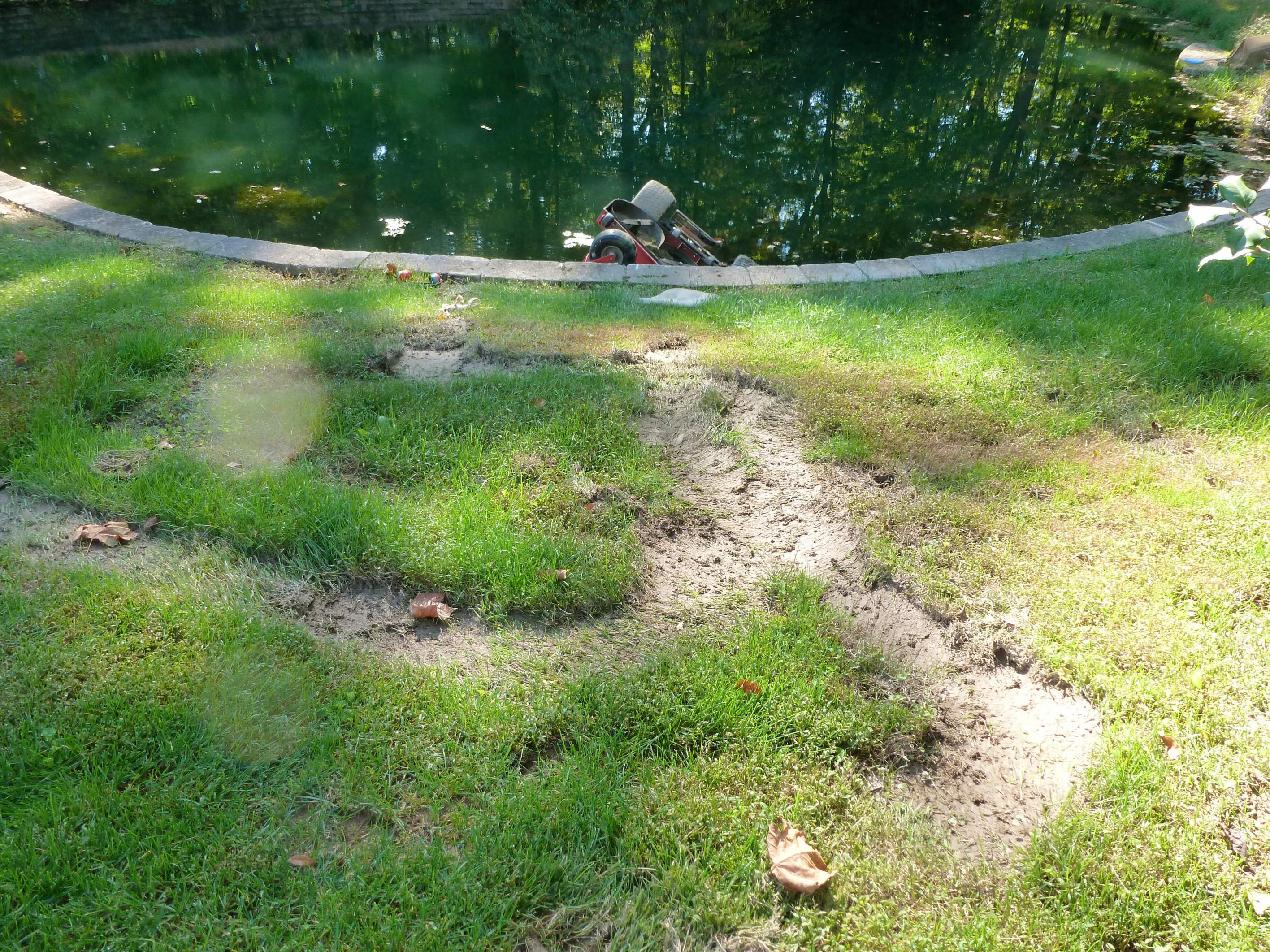

Looks like some tracks in the photos from sliding or spinning wheels, and looks pretty steep. I would back up the hill if I mowed it at all with a tractor.
/ Safe mowing on slopes #22
Not much you can do when the turf breaks loose due to ground saturation. Best thing is stay off sandy soil when saturated with water regardless of what you are riding on or even walking on it can cause you some slip and fall.

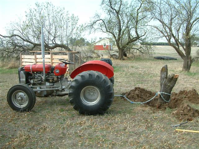

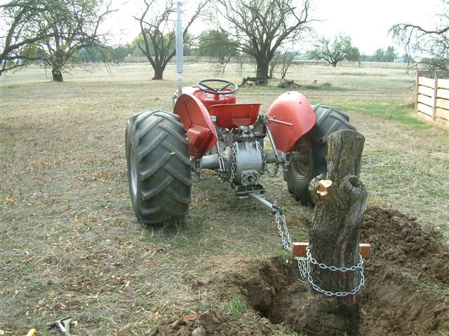

Measure the width W of the rear wheels (to the outside of the tire) and the height H of the axle centerline. The squat ratio W/H should be greater than 3.5 for stability on slopes. My 1964 MF135 diesel is a field tractor modified to squat low for use in an olive orchard and has a squat ratio of 4.15.
The normal rear wheels (28-36" dia) have been replaced by 16" dia rims carrying Goodrich 18.4-16A rubber (18" wide, 16" rim, 40" high overall) and the front axle spindles have been shortened to keep the tractor level. The front and rears are filled with water (no need for antifreeze around here since winter temps rarely fall below 32F).
My place is 10 acres of flat pasture so I haven't bothered to add a ROPS to the 135 (they're available aftermarket). If I had your situation, I'd consider a full roll cage like those on pulling tractors (unlimited category).
ROLL CAGE KITS
Cheaper than a trip to the ER. Better safe than sorry.
Good luck and be careful out there.
