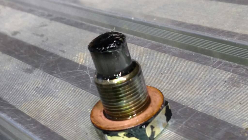

I got the hydraulic fluid and filters done.
The large drain plugs require a 30 mm.
I drained and replaced just shy of 10 gallons.
I was surprised how the drain plugs looked.
Rear plug
Yes there are 2 distinct shavings on that magnet.
Front plug
The front axle I used a crescent wrench and replaced the Teflon tape on the fill and drain plugs.
It was a real pain in the butt to refill it.
I only cycled the hydraulics to purge them, I did not get to drive it around to see how the Kubota fluid works.
   / Proud owner of a new owner's manual #54
There should not have been any Teflon tape on that straight thread, the copper gasket provides the seal.
Only tighten enough that it doesn't leak

The axle only uses pipe treaded plugs with a square head.

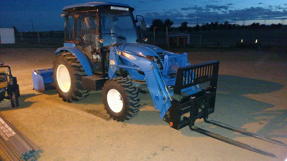

I always wanted pallet forks but good gosh these things are a must have, top of the list first thing type of attachment!!
It just sucks that I only bought them because were moving in the next 2 months to Germany and I needed a way to load my 40x60 shop into a semi trailer for storage.
So sadly I will be selling the XR4046HC to some lucky guy/gal
When we come back in 2-5 years I will be buying a new one by then I think the very few items that LS is missing (RPM matching) will be addressed.
