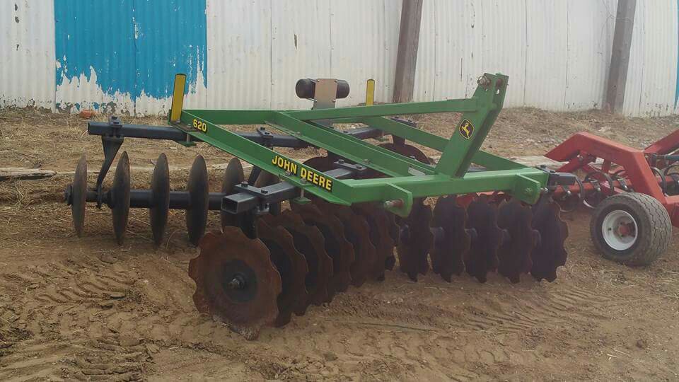

Picked these up today.
$1300 total.
Like new both only used once.
   / Proud owner of a new owner's manual #42

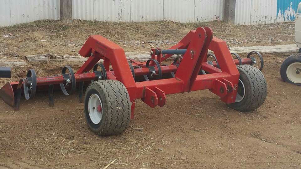

I give up? What is the red thing Adam?

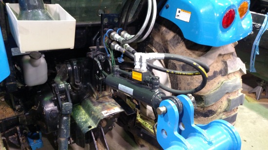

Side link, only after I get some splitters.
Adam;
If you get a hydraulic side link, move the adjustable side link over to left side. This will give you a lot of adjustability.
What does the check valve do for you on your upper link?
Sent from my iPad using TractorByNet

Arena groomer. I'm also going to see how it works on the driveway.
From what I've read, it prevents it from moving when you set it. Since we don't have a float function that's why I choose this one.
   / Proud owner of a new owner's manual #47
Yep, I wish one of my rear remotes had float. I may see if I can add a check valve to my hydraulic side link.
FWIW, I have been pressing LS, thru my dealer, to complete their 3rd remote kit for the XR4046HC. LS had been promising it for almost a year. I'll find the thread I started on that and update you. I need 3rd remote for angle adjust on my LandPride 96" rear blade. I adjust tilt with my hydraulic side link.

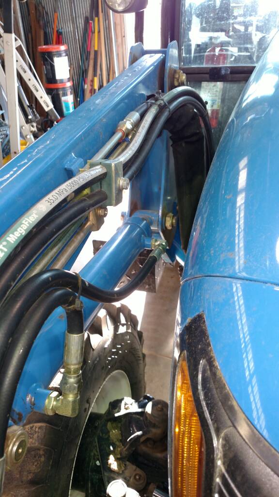

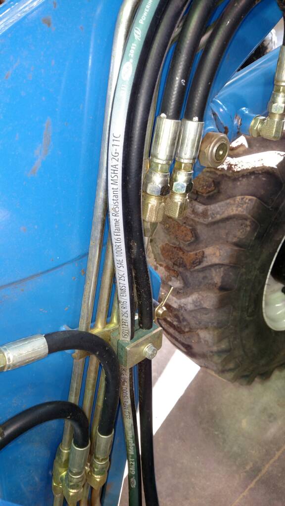

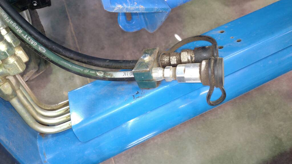

I realized that I did not post pics of when I cleaned up my front hoses.uploadfromtaptalk1458528463098.jpguploadfromtaptalk1458528472391.jpguploadfromtaptalk1458528478389.jpg
Bought the clamps off eBay as they had free shipping and got some longer metric bolts from the local farm supply.
I think in the future I will up the hose size to 1/2" to increase the flow.

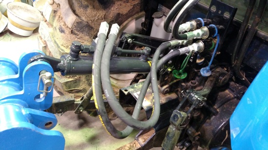

Re: Added Hydro top link
I added a hydraulic top link to the girl tonight it took about an hour to Teflon seal, tighten all the fittings, and route the hoses.
I have not tested it out yet but so far it looks to work pretty good.
Just curious, what is the reason that you mounted the hydraulic top link backwards?
#50
Better interface with the hoses. Otherwise I would have a loop that would either be pinched or to tight of a bend.
