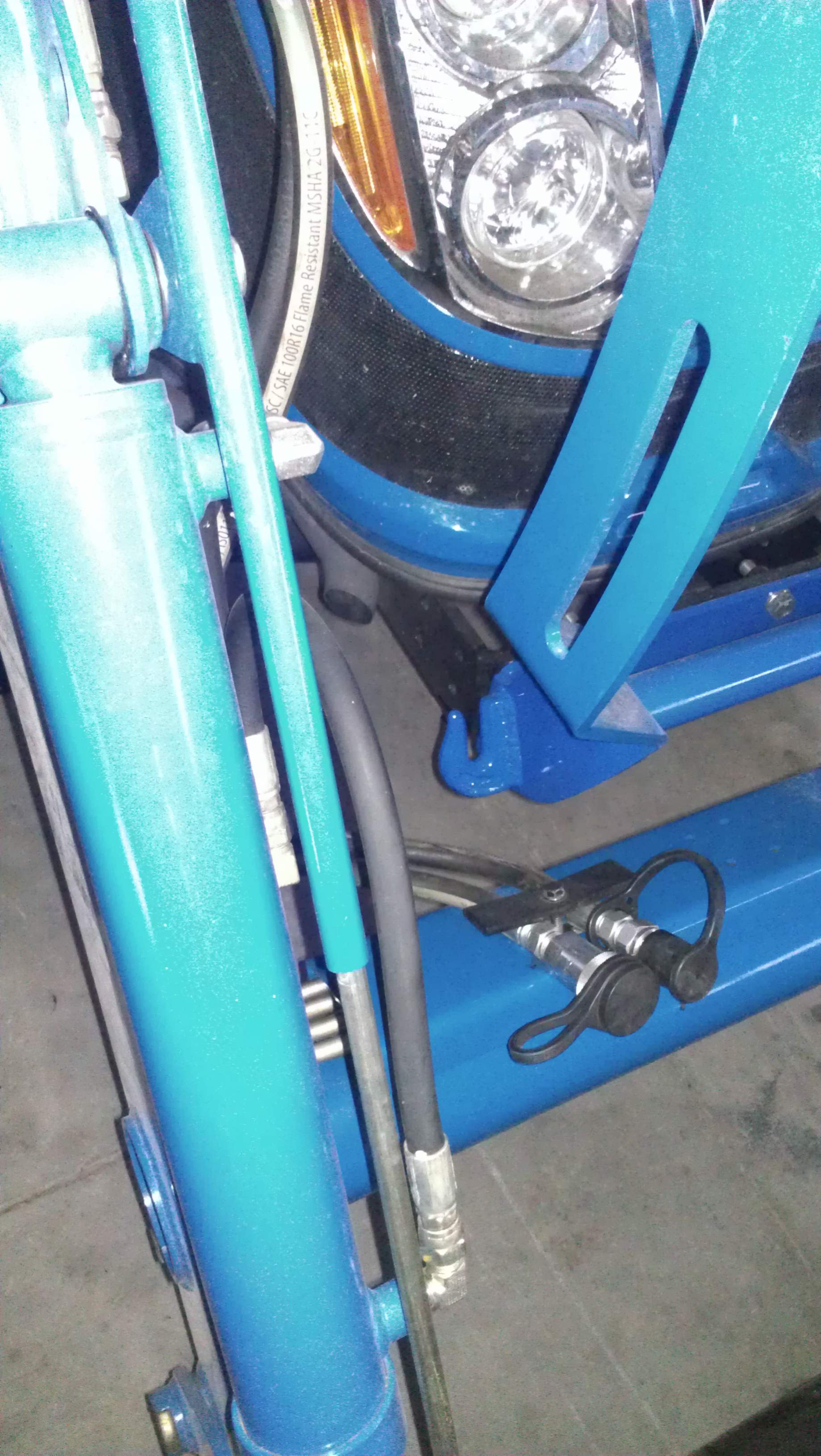

Over 14h now, I finally got to do some welding
I also added two 3/8" hooks to the front brush guard so as I have a sold tie-down point for transport.
View attachment 385983View attachment 385984
Watch those tie downs that far forward. I was running a chain right behind the grill guard and saw that when i cinched the over center binders, the frame tweaked quite a bit. Being i transport on a lot of rough dirt roads i saw this as an issue because as the trailer would flex it would pull on this area even more. I ended up making plates and bolting them to the double frame over the axle and it don't move at all....... http://www.tractorbynet.com/forums/ls-tractors/319273-xr3037c-front-tie-downs.html

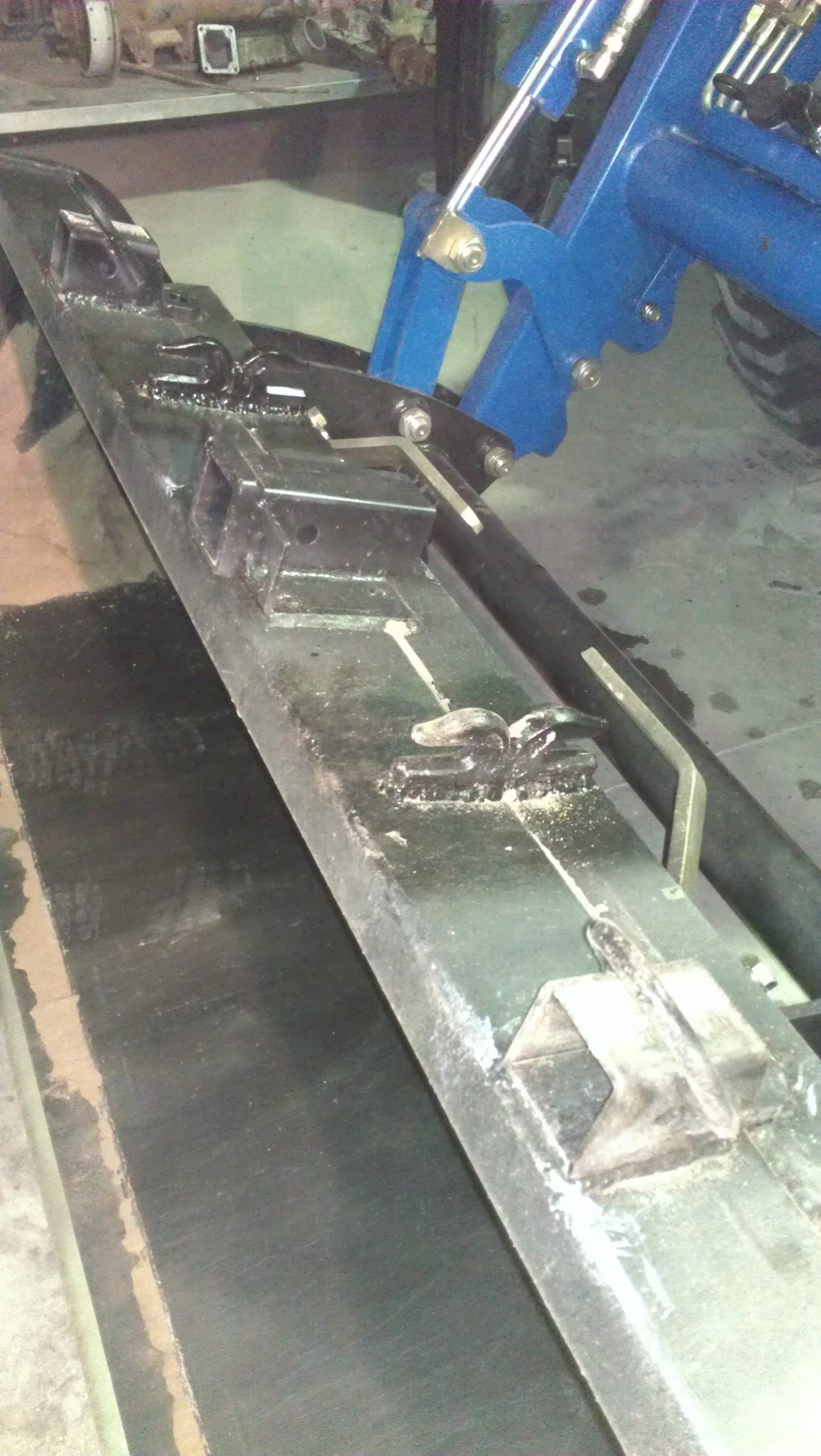

I added four 3/8" hooks to the bucket and three 2" hitch receivers. I have the hooks facing forward and back so I can place the chain anyway I please.
The 5/16 chain hooks fit through the receiver openings but the 3/8" chain will not but the give me a good termination point if needed.

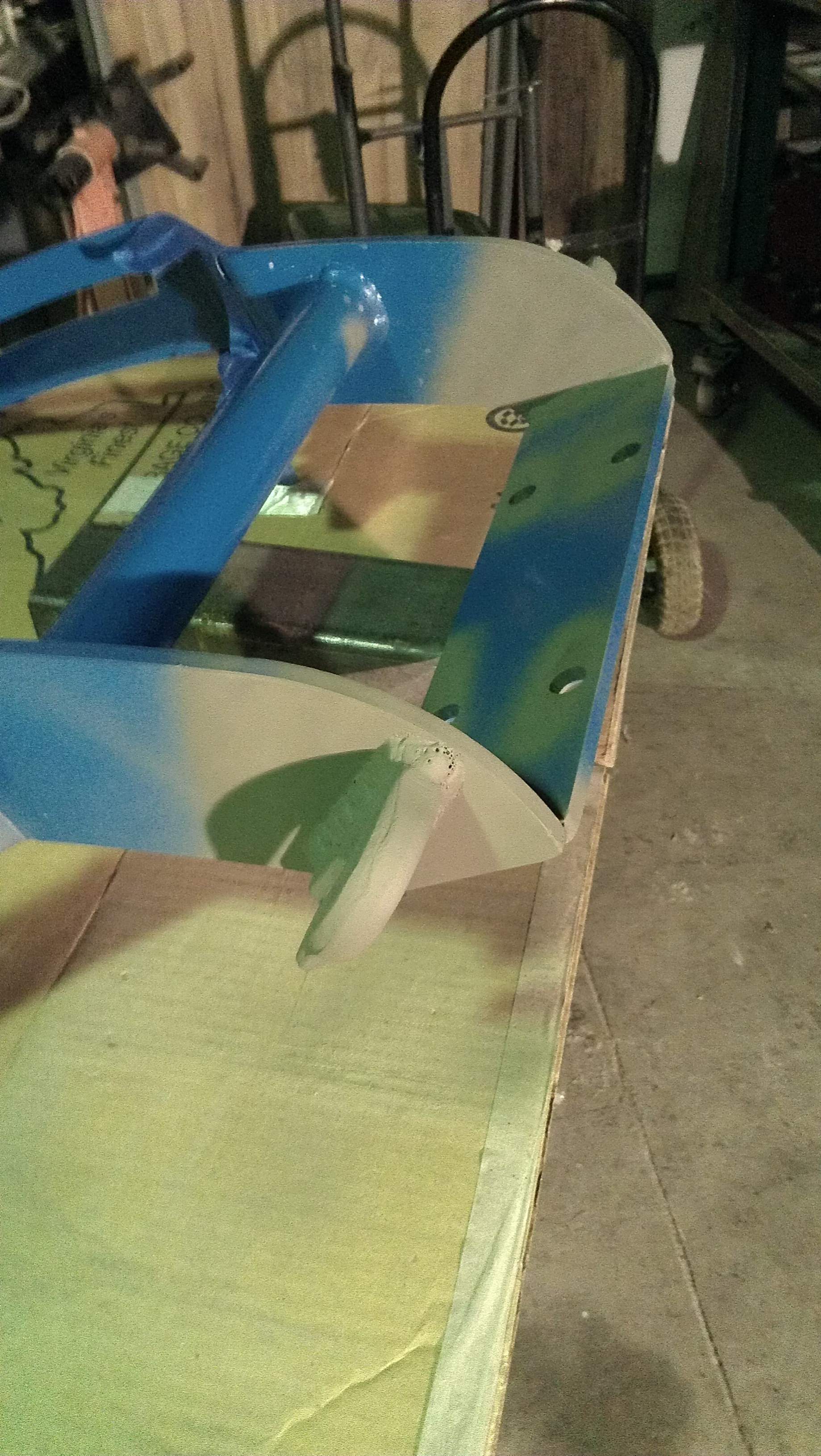

That is sail blue.
   / Proud owner of a new owner's manual #14
That is sail blue.

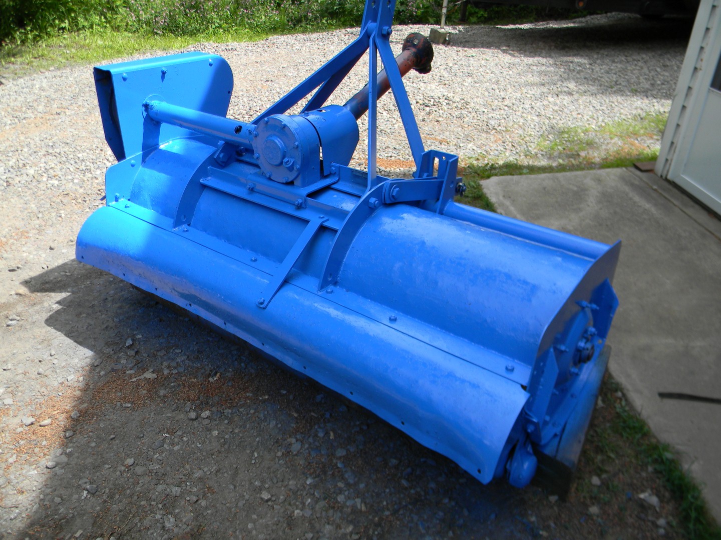

It must be the camera or lighting that makes it look darker. here's the comparison pics. I used Sail Blue from Rustoleum quart can to spray my mower. The spray can of Sail Blue is the same. Yours looks darker, more like Navy Blue.

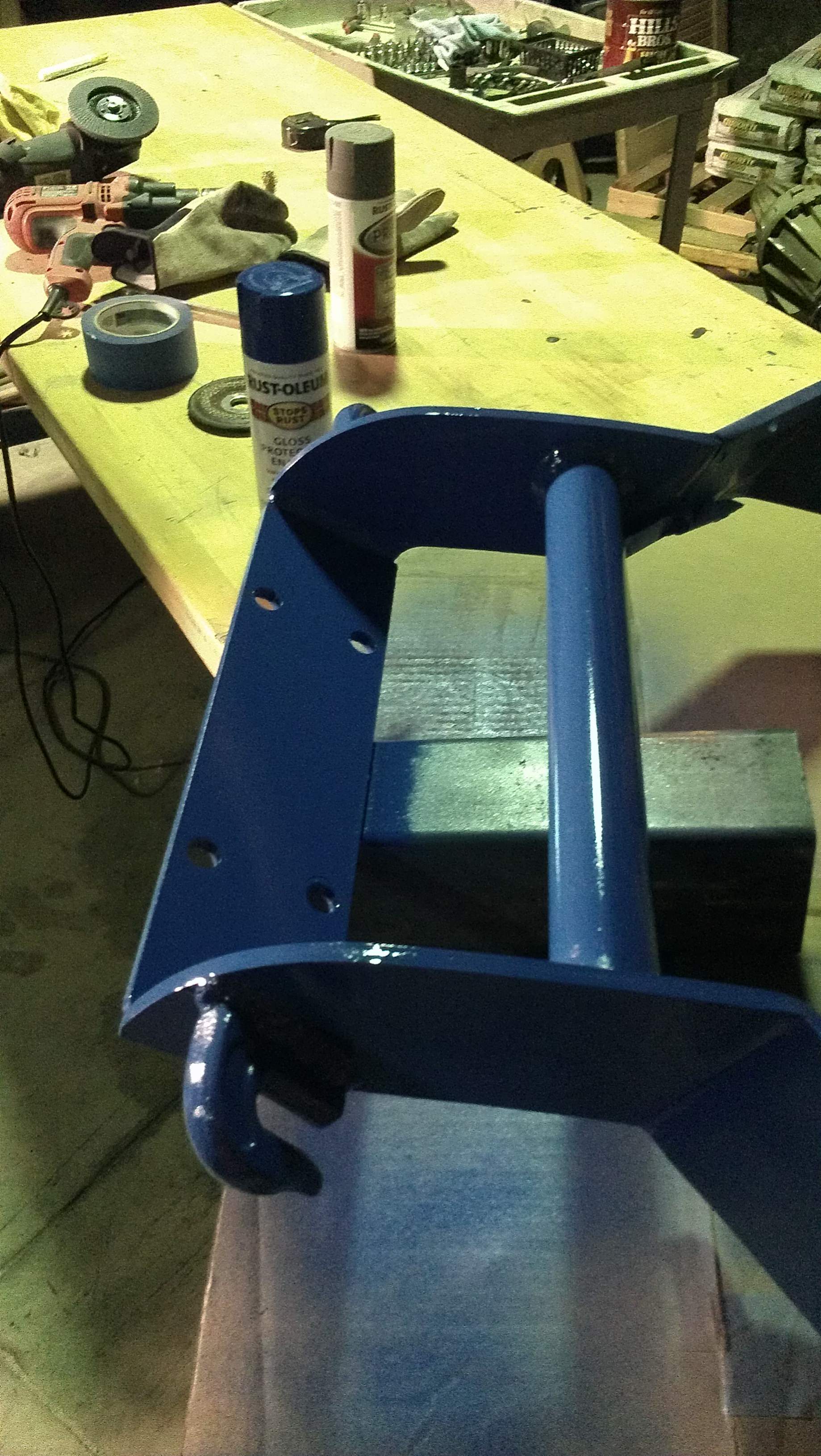

Here is a better picture

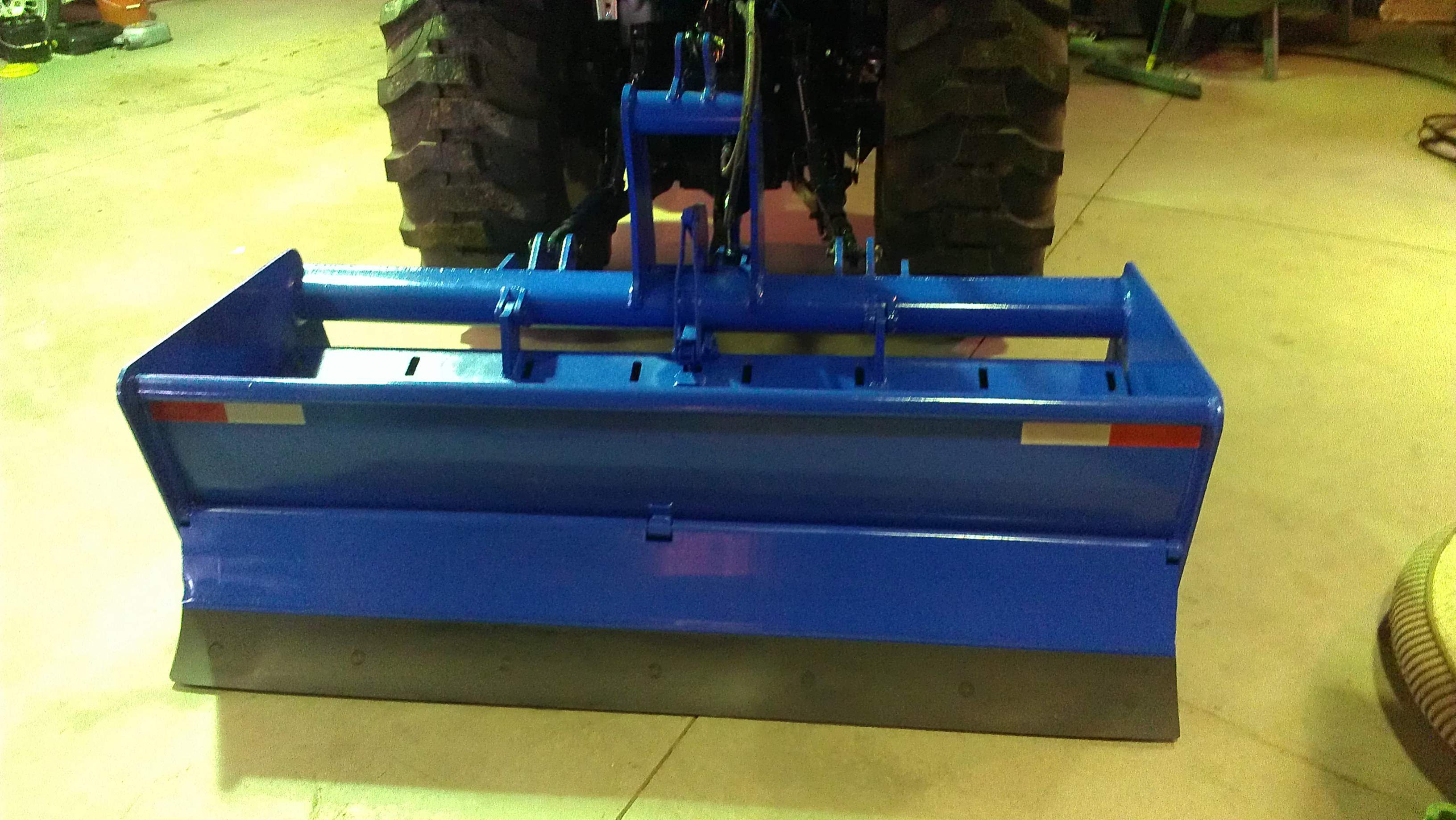

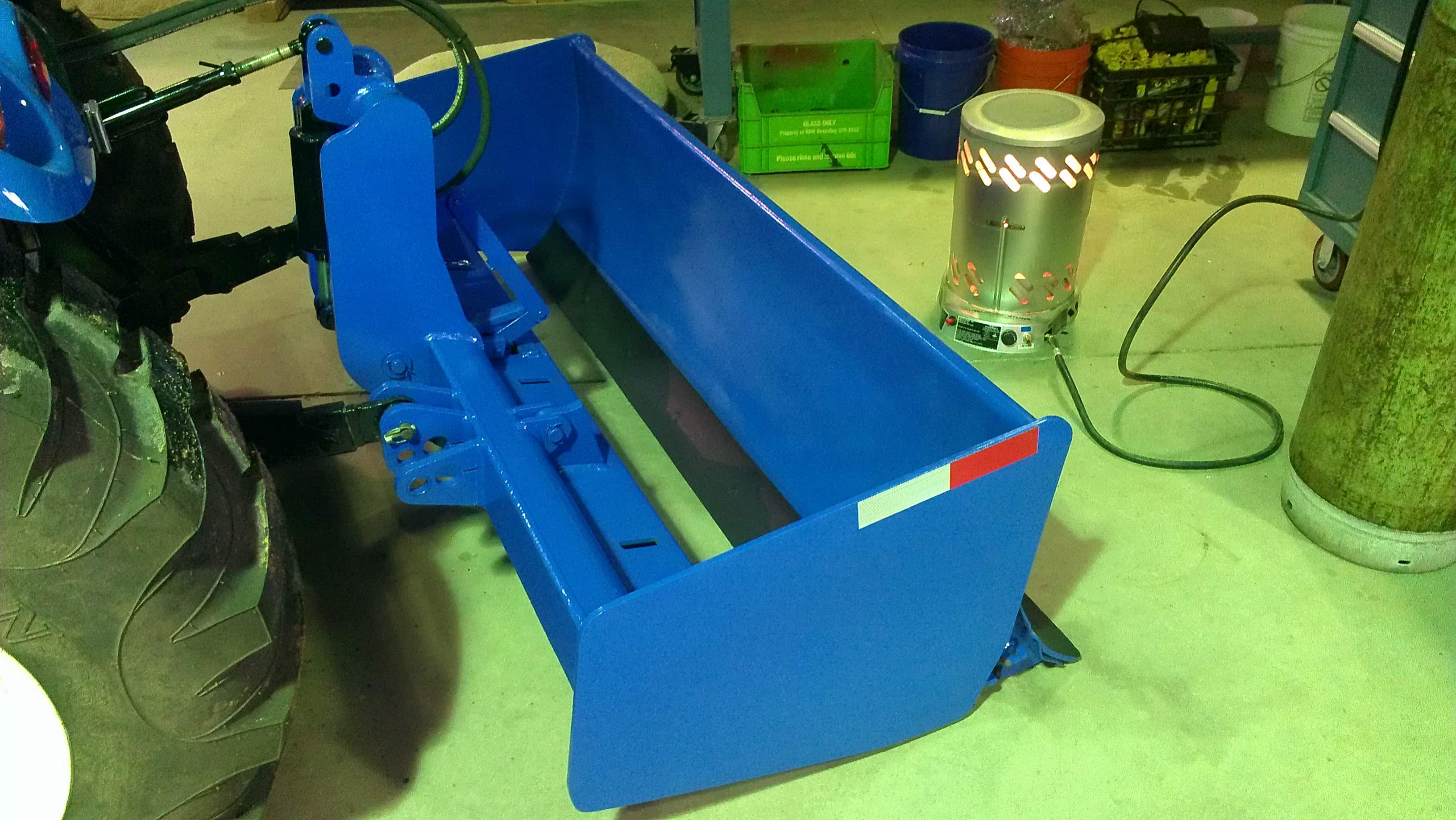

Finished painting the box blade.

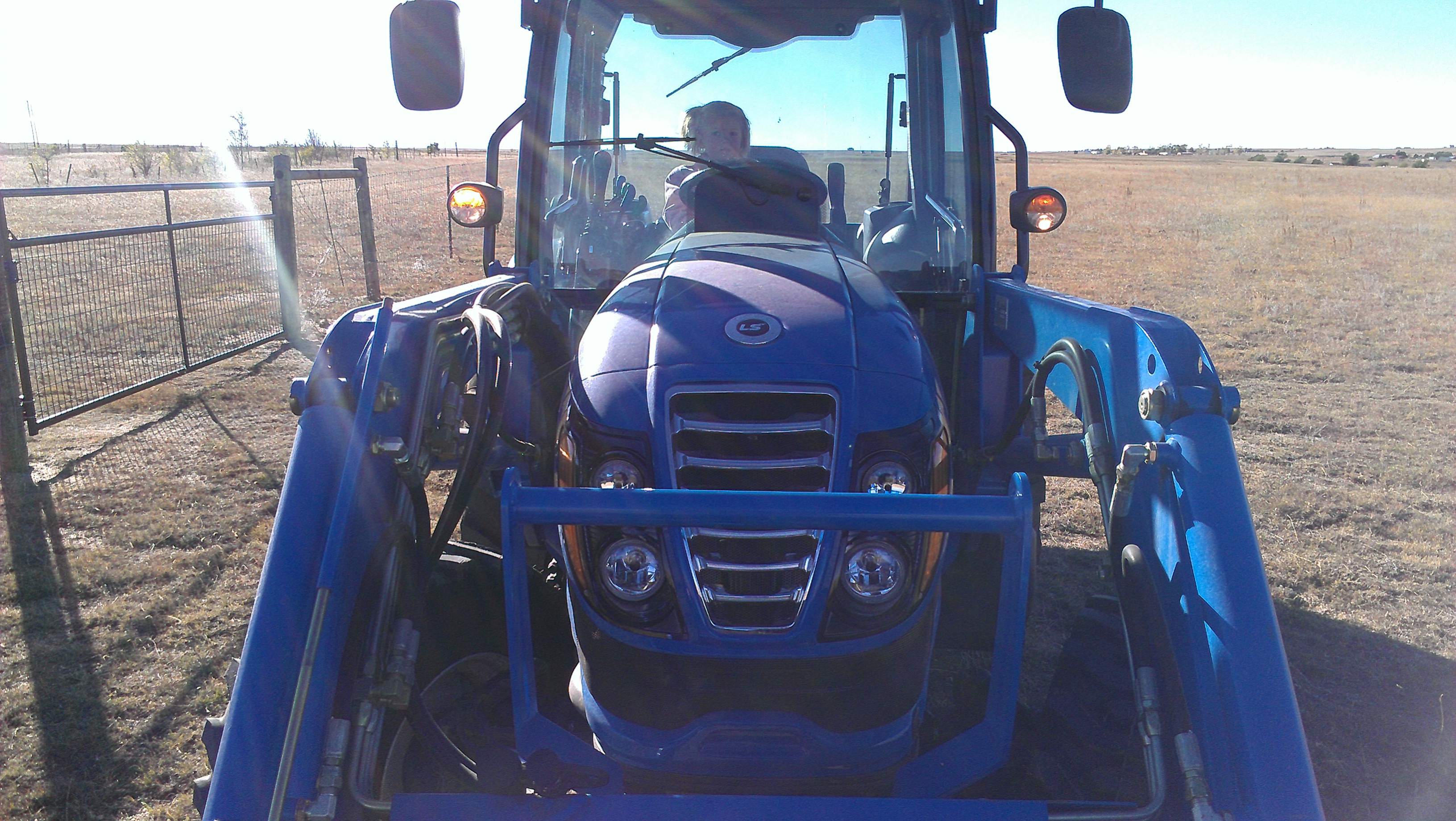

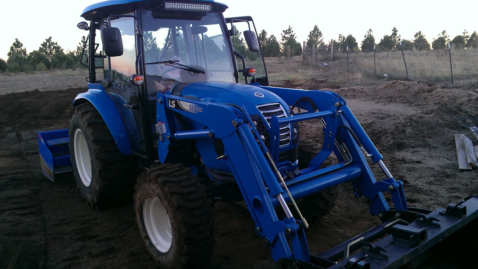

Not sure if you can tell but I tinted the head light bezels, looks much better I think. I wanted to remove the grill also and paint it also but its much more difficult to remove. It uses push and lock type of washers/retainers.

nvmyhd. Wow, you have half as many hours as I do and you have already customized your rig! I have not welded hooks, upgrades speakers, or made up hydraulic lines to run to the front of my loader on the P7010C. I have just been catching up on work that has been piling up between when my Farmall died and I received the P7010C.

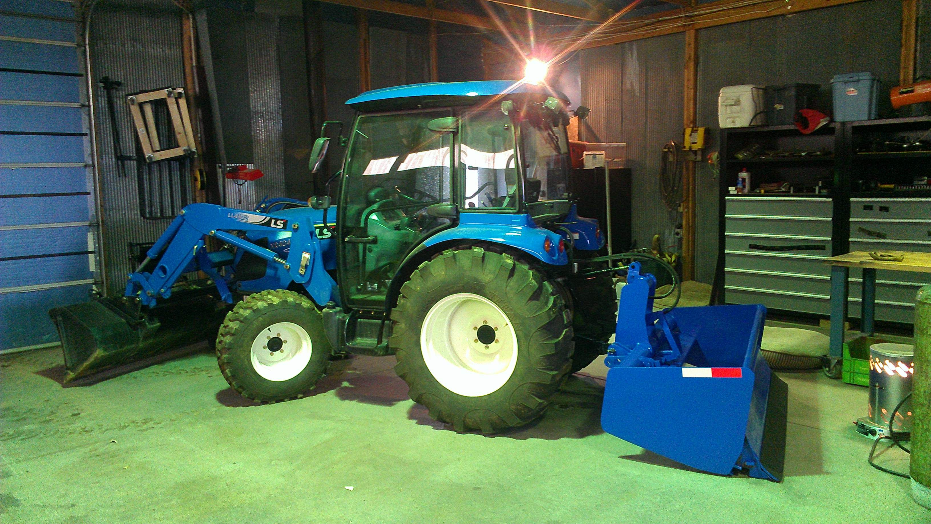

Sharp looking tractor! :licking:
How do you like the light bars?
CT
#19
I'm at 36 hours now. When it comes to lights you can never have enough. I'm happy with the front LED bar, the two 2x2 in the back are ok but I think I will replace the front bar with a larger unit and move it to the rear.
   / Proud owner of a new owner's manual #20
I would like to replace both the front and rear work lights with light bars. I have some 4" LED's like you put on the rear installed on another open station tractor and our ZTR. They are "ok". The OEM lights are better than I imagined they would be. My concern with the light bars are, Side lighting and edge of beam cutoff? My experience with LED lights with reflectors have a VERY sharp side cut off and make it difficult to see past that point. Are the center LED's spot and the sides diffused floods?
