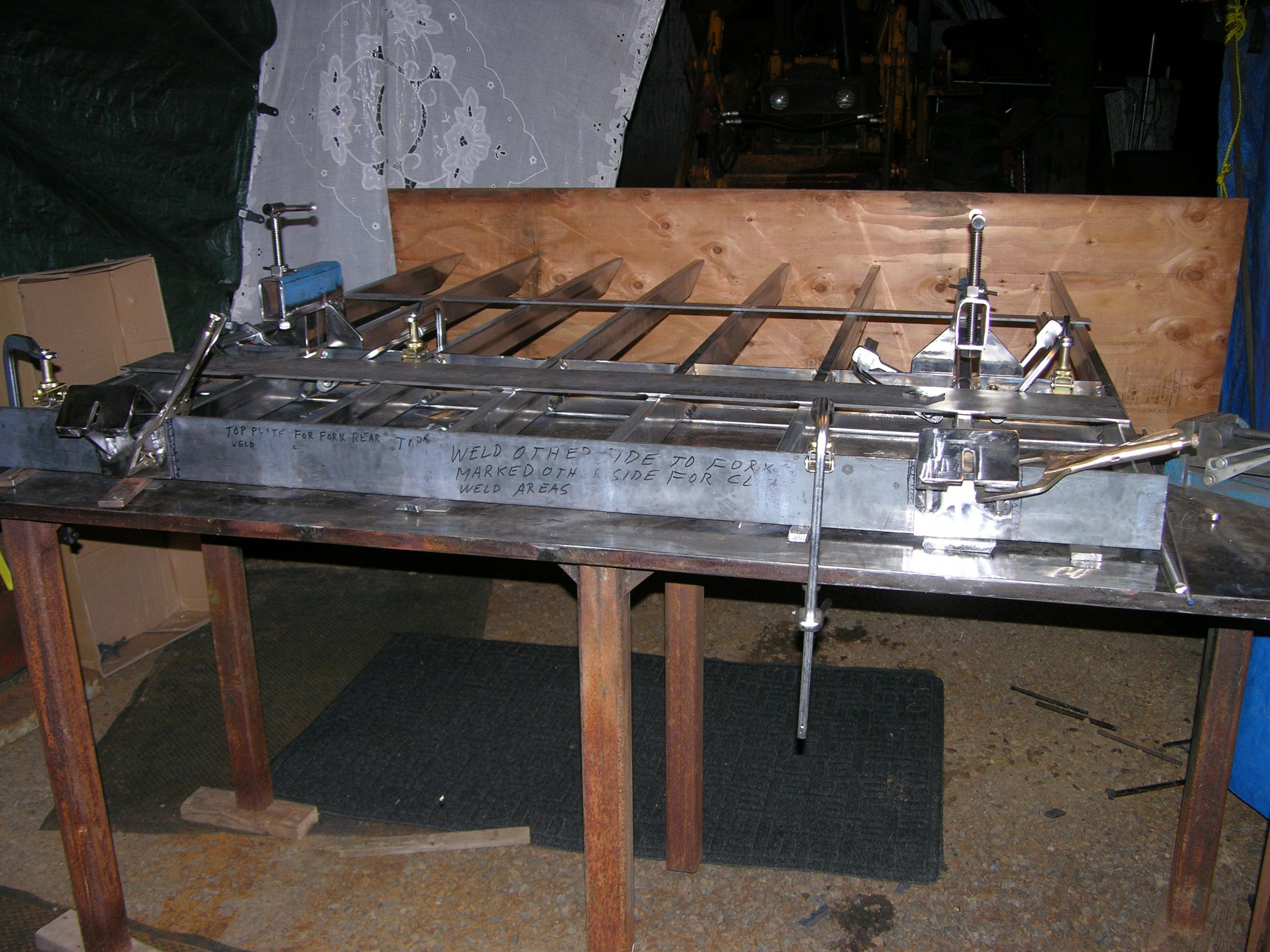

"If it gets spattered or a bit of corrosion, I belt sand it. Easy peasy."
Just another reason for starting with a 1" (or more) thick top 😈
This one's 3'x7'x1", a CL find for $200 about 10 years ago - weighs just over 1000 lbs including the legs - seller actually DELIVERED it, couldn't complain... Steve
