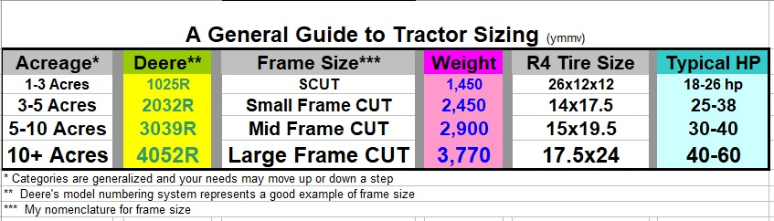

I like these HP tied to acreage charts. They make me giggle.
Seriously, probably a good idea for a first time buyer to look at so they can narrow their research but beyond that I think it quickly looses its utility because there are so many other variables. The primary uses of the tractor far outweigh the number of acres the tractor is used on.
The point of that chart is to get newbies to consider factors other than HP, like frame size, weight and tire diameter = TRACTION and ground clearance. It also says YMMV
Darned, I only had 16 HP for 68 acres. Lots of rocks, big trees, [pine spruce,oak, maple, beach and so on. Lots of 20 degree slopes with about six acres of farmable land. Just a bucket and backblade to work with. Moved a lot of dirt, rocks felled trees and made trails. Made out okay. Now I got a 24HP with backhoe and figure its just the perfect size. Musta missed something somewhere??
   / Prospective purchase for the mountains. #78
Yep. I did a lot of work with my 15hp Shibaura. Liked my 24hp John Deere better. Liked my 34hp New Holland even better. Really like my 40 hp large frame New Holland. Just makes things easier. I'm not saying my chart is an absolute, just pointing out there is more to tractor capability than just hp. YMMV
I see lots of CUTs traded back in for a larger CUT. If you don't think there is a difference in capability with frame size, you're just spinning your wheels. ;)
