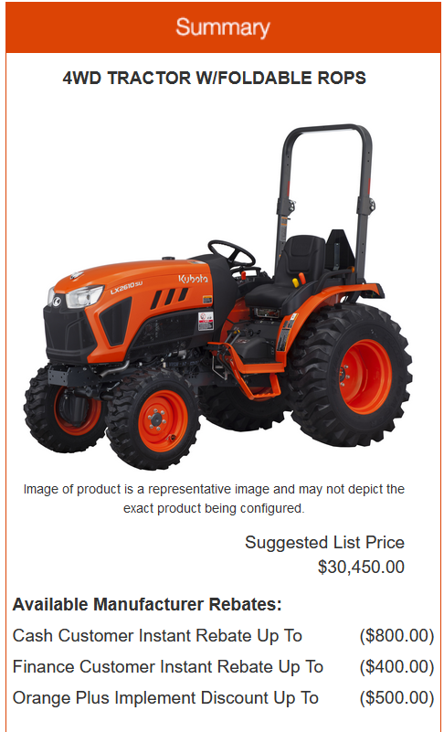

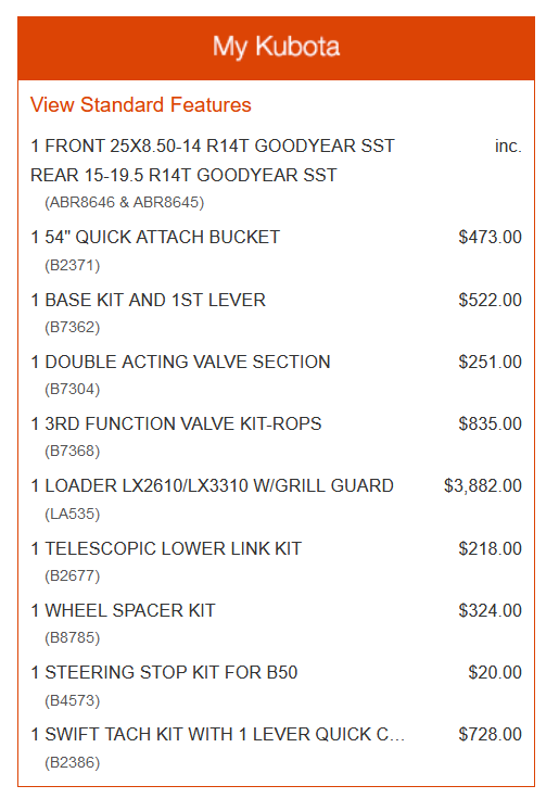

About $30k would get you a Kubota LX3310 before rebates. it's comparable to the John Deere 2038R. Either is smaller than I would like, but it could manage your tasks (rough cut mowing saplings, box blade and rear blade road/trail maintenance, grapple work). It would be fine for your first tractor.
