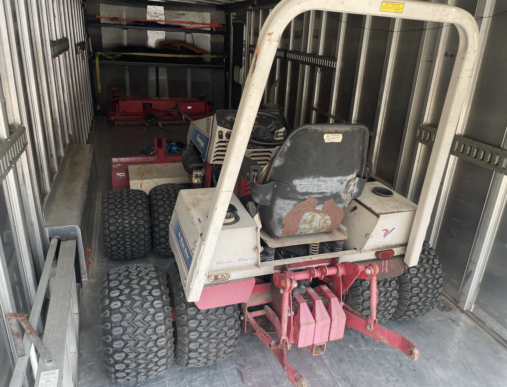

picked her up today. Not the best condition, but it'll do the job and give something to clean up!

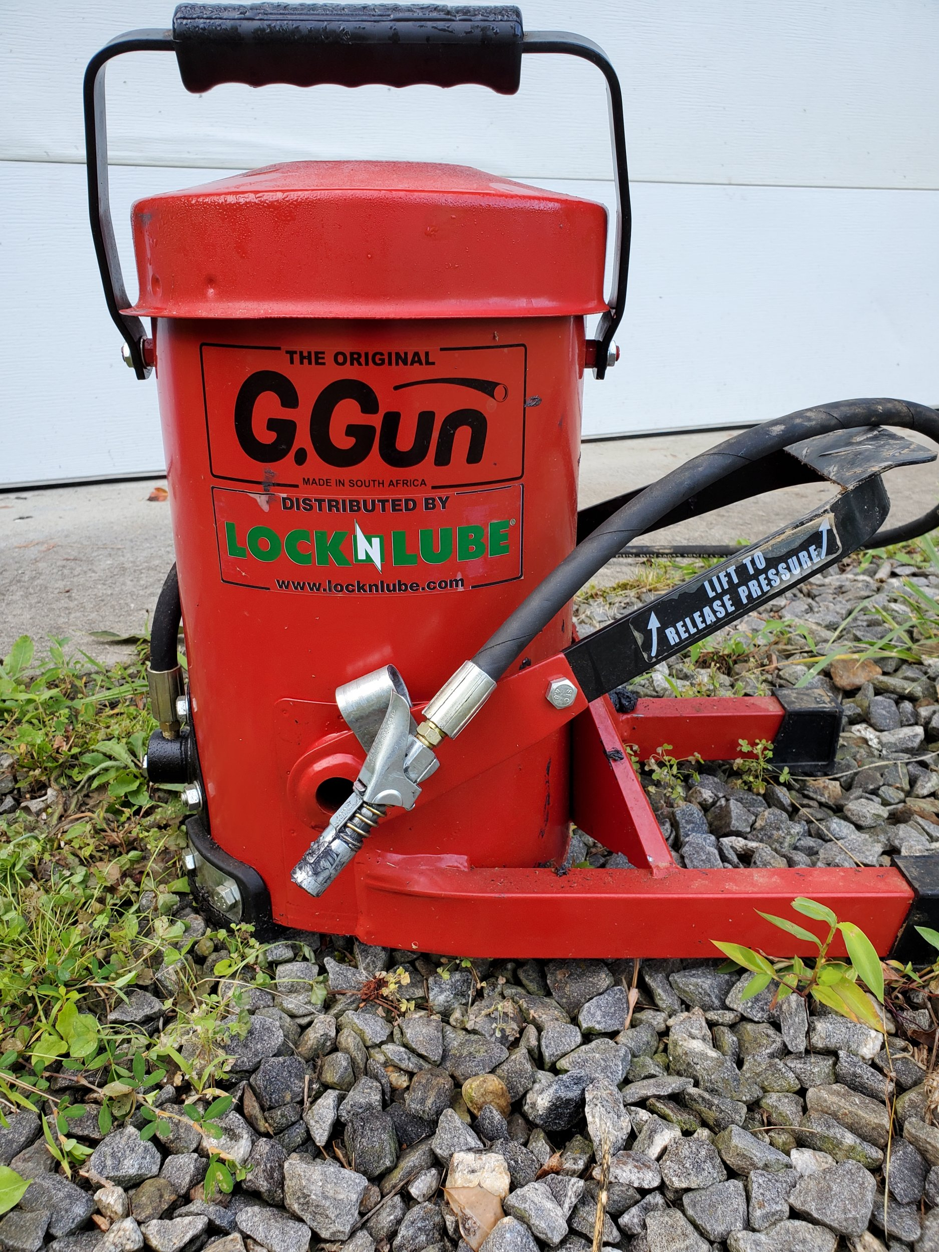

One more piece of advice.
Grease ( Molybdenum Disulfide ) is your best friend and too many machines get ruined because they don't get greased frequently enough. The combination of high pressure/ high loads, dirt, sand water, and dry rotating surfaces will quickly turn a good machine into junk. Get a grease pump with locking tip and buy grease in 5 gallon buckets. You will save massive amounts of time and money and the machine will get properly greased and live a long useful life because this setup makes it easy and less costly. Cartridge grease is 5-10 times cost of bucket grease. The tip locks onto the grease nipple so no need to press it on by hand.
Use water and a spray nozzle to wash the old grease, dirt, etc away from the grease nipples before greasing. Wash grease fittings and grease where family members or pets won't be walking.

Boozie-what IS that?
The last thing I need is something else to "clean up"...

Picked her up today. Not the best condition, but it'll do the job.
I eagerly anticipate your impressions after two or three days experience operating the Ventrac:
1) How well does the Ventrac perform relative to your requirements in Post #1.
2) How well does the Ventrac perform relative to all the recommendations here.
3) After factoring in your early Ventrac experience any change to your plan for a heavier machine in the future?
Where did you buy the Ventrac? Dealer? Golf Course? Private owner?
Great picture. I am jealous too.
