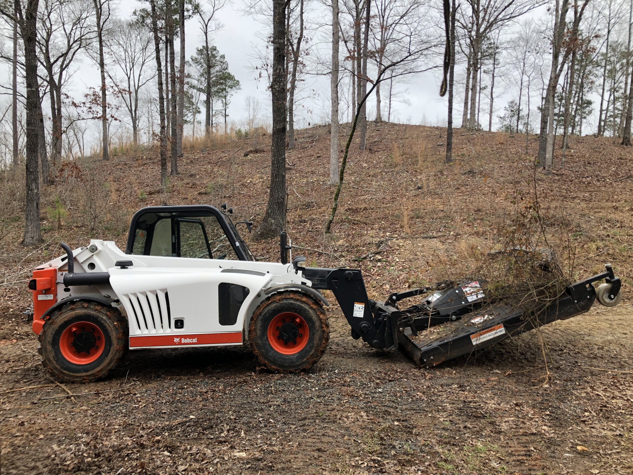

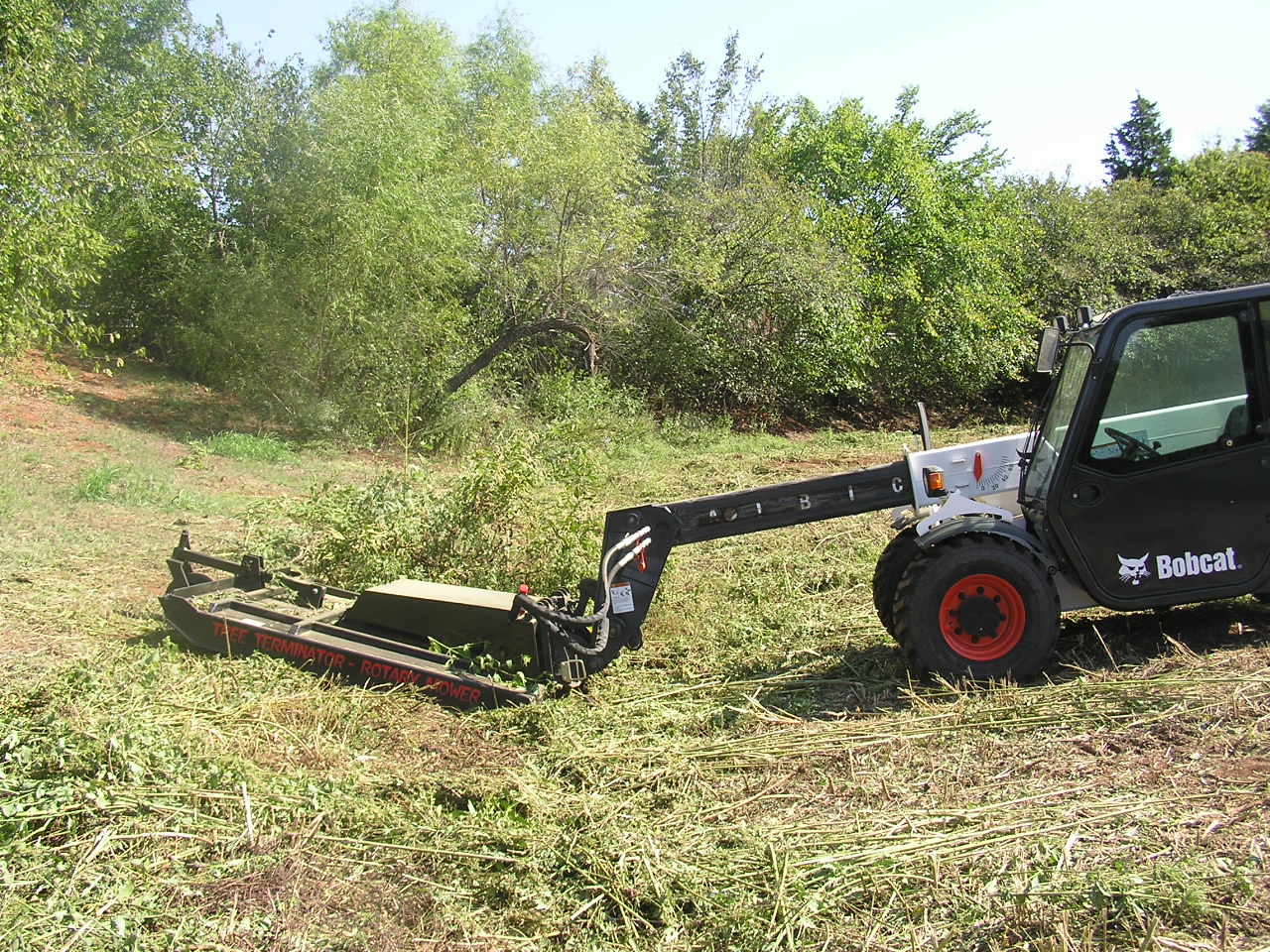

I own 200 ac in piedmont of GA-i too had min to no experience with tractors. I watched a few YouTube videos of tractor rollovers on slopes(and many also of people using them correctly, daily, on slopes) and realized I was too ignorant at the time to purchase one(went thru exhaustive research to find a “mountain” vehicle, and like another poster commented, they were all European, or out of my price range. I also looked at track steers, but was worried about tracks popping off on a hill back in the woods, on a Sun right before i was to leave for long trip home
Certainly, I could have spent the time thats needed to learn, but i dont have that kind of margin in my life right now.
so i bought a telehandler.
Mower, tooth bucket, stump bucket and grapple followed. For me, it was, and has proven to be, the most user-friendly for someone of my limited knowledge (though I did manage to get an unstuckable machine stuck, if that tells you anything). It’s been a lot of fun learning about it, doing some minor maintenance on it, and thinking about what job/implement I need to do/buy next. I also agree, a backhoe would be really cool to have for jobs that probably take me a lot longer with my telehandler. You can get an idea of the slopes i keep cleared…

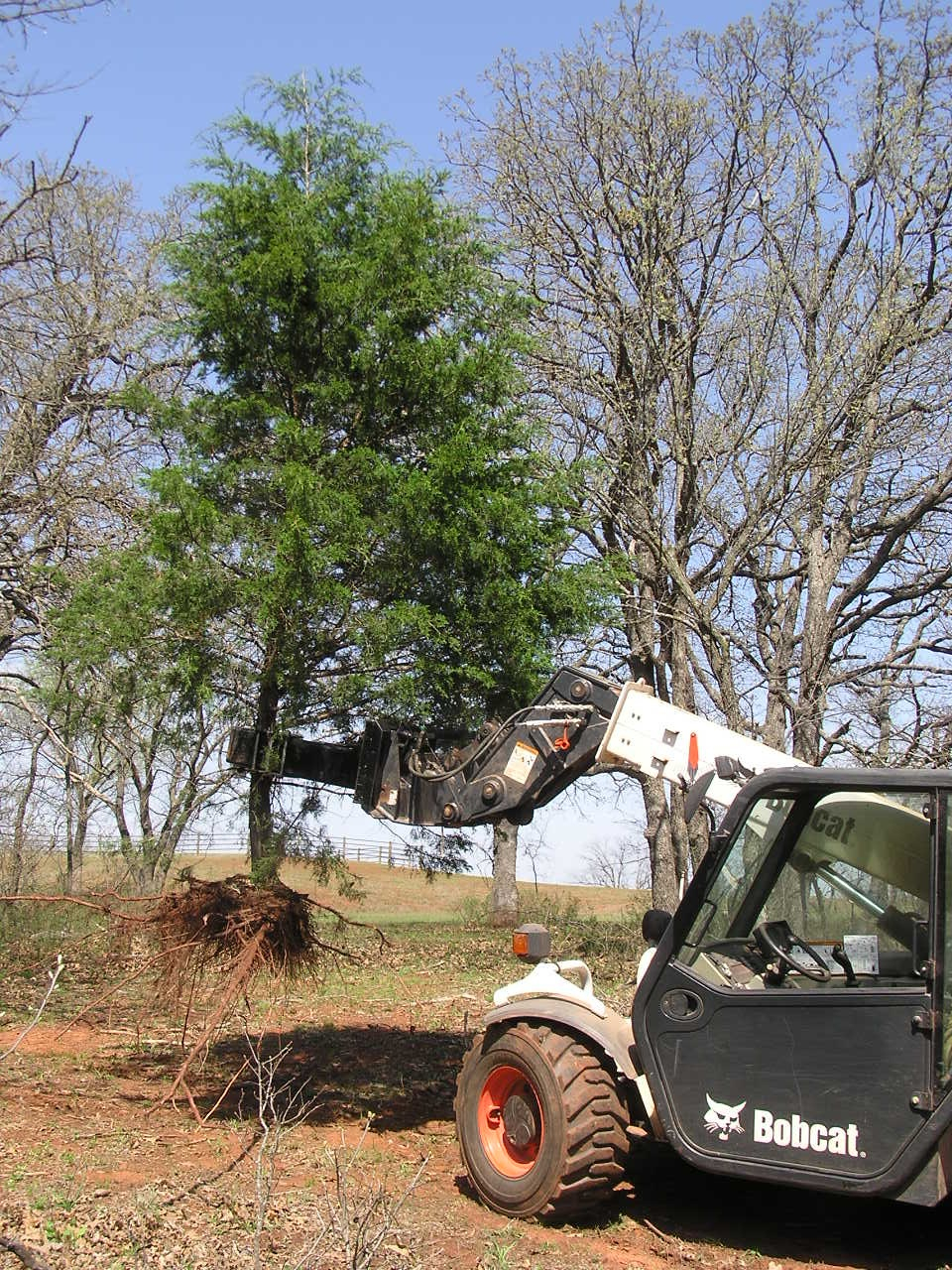

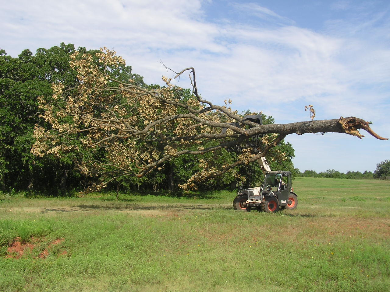

   / Prospective purchase for the mountains. #84

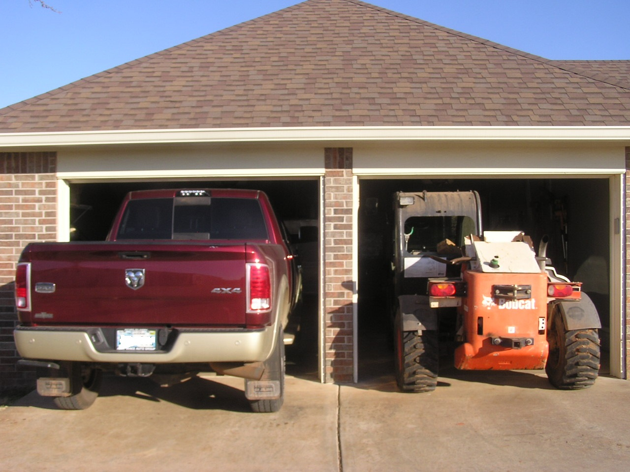

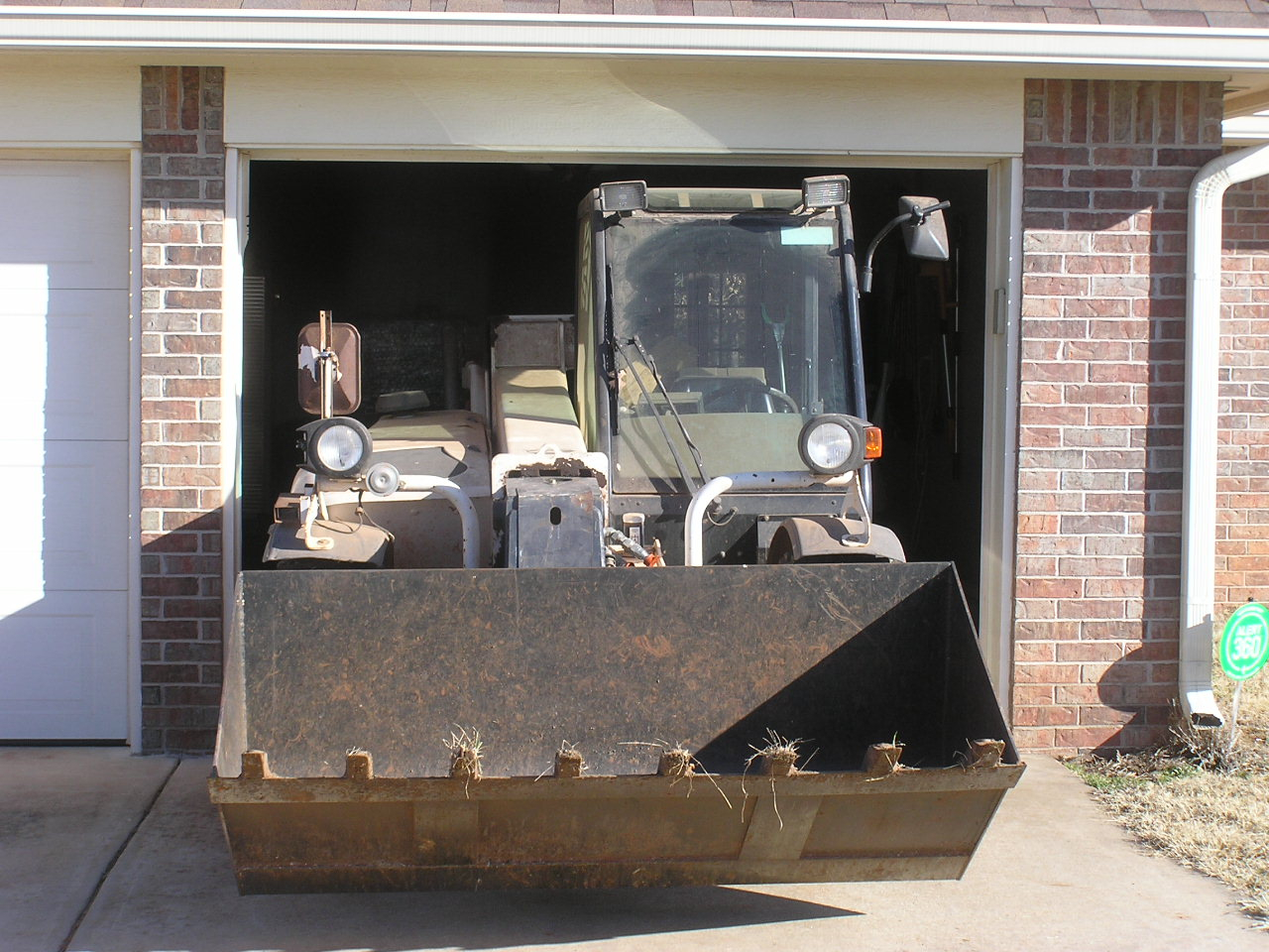

Just to clarify icnu's post it is a compact telehandler, as in small:
But it does big jobs:
