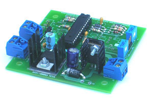

If you want to do it electronically you'll want a servo valve. The valves I've seen in 12V flavors usually require 1/2 to 1 amp for full flow.
The trick is getting the pot on the joy stick to control the current. The pots are far too small to handle that current directly. The low level of energy in the joystick must be converted to a high level for the valve.
PWM is the most common method because it is very efficient and does not generate much heat like a linear amplifier would.
Most designs today use a processor to accomplish this. The processor output drives an FET (field effect transistor) that switches the 12 volts on/off to the valve. This happens at some higher frequency. The longer the on time the more current flows in the valve. The inductance of the valve filters the frequency to a DC level.
This can be done without a processor. It still requires circuit design. A ramp generator and comparator can convert the joystick to a PWM also.
I have not seen (does not mean there isn't one) a card that takes an analog voltage from a joystick and will drive a solenoid proportionally. There is probably not much call for that since most applications require other features so the designer accomplishes the PWM in the uP. Our system also controls a salt spreader and heads up display as well as 4 PWM outputs and a float solenoid. It has to read vehicle speed as well.
If you want a bi-directional control, I assume you do, you would need to provide a plus and minus power supply to the joystick. Then you could get, say +10 to -10 with 0 at center. A linear amplifier that could accept a +/- 10 volt input and drive the high current +/- 12 volts to the valve would work. There should be some amps like that around.
Our system requires the operator to press a "shoot" button on the stick when moving the stick. That enables the blocking solenoid valve to feed the servo valve. Without that the servo valve will tend to creep when at zero due to small offsets in the circuit and valve. This could be adjusted to zero but it will change with temperature. A blocking valve is safest. Also, if the servo valve spool sticks, as mentioned above, releasing the button on the stick drops the blocking valve and stops motion.
The best approach may be to try to scavange something from an existing machine. That probably isn't so easy either.
You're right. The Otto switches run at 32mA, with a 40mA max. I'm actually going to stick with the mechanical joystick I have now, I'm just going to have a custom grip made with the Hall Effect proportional switches to control the featherable circuits I'd like to add, and the one reversible on/off circuit for the blower/broom/auger.
Maybe it could control the missile lock I've been wanting too...???!! Do you know of a source for these?? Actually, I think I just found one........
Scorpion Technologies LTD. - Driver Cards
Would that work??
I do, for sure. The Otto switches look to run from +0.5V to +4.5V.
Scorpion is actually quite close to wear I live, so I think they'll be a good resource.
Really appreciate all the help here.
-Jer.
