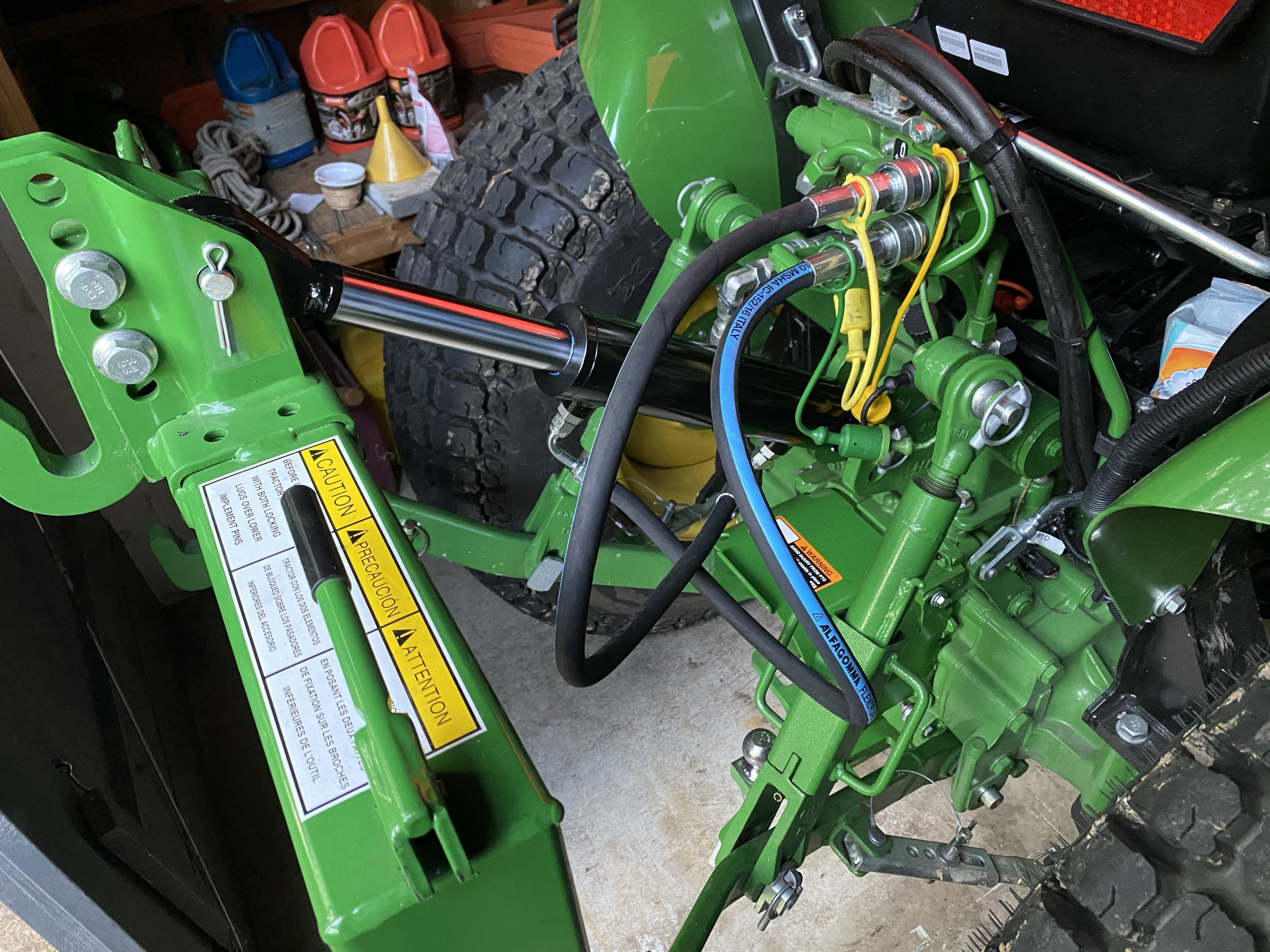

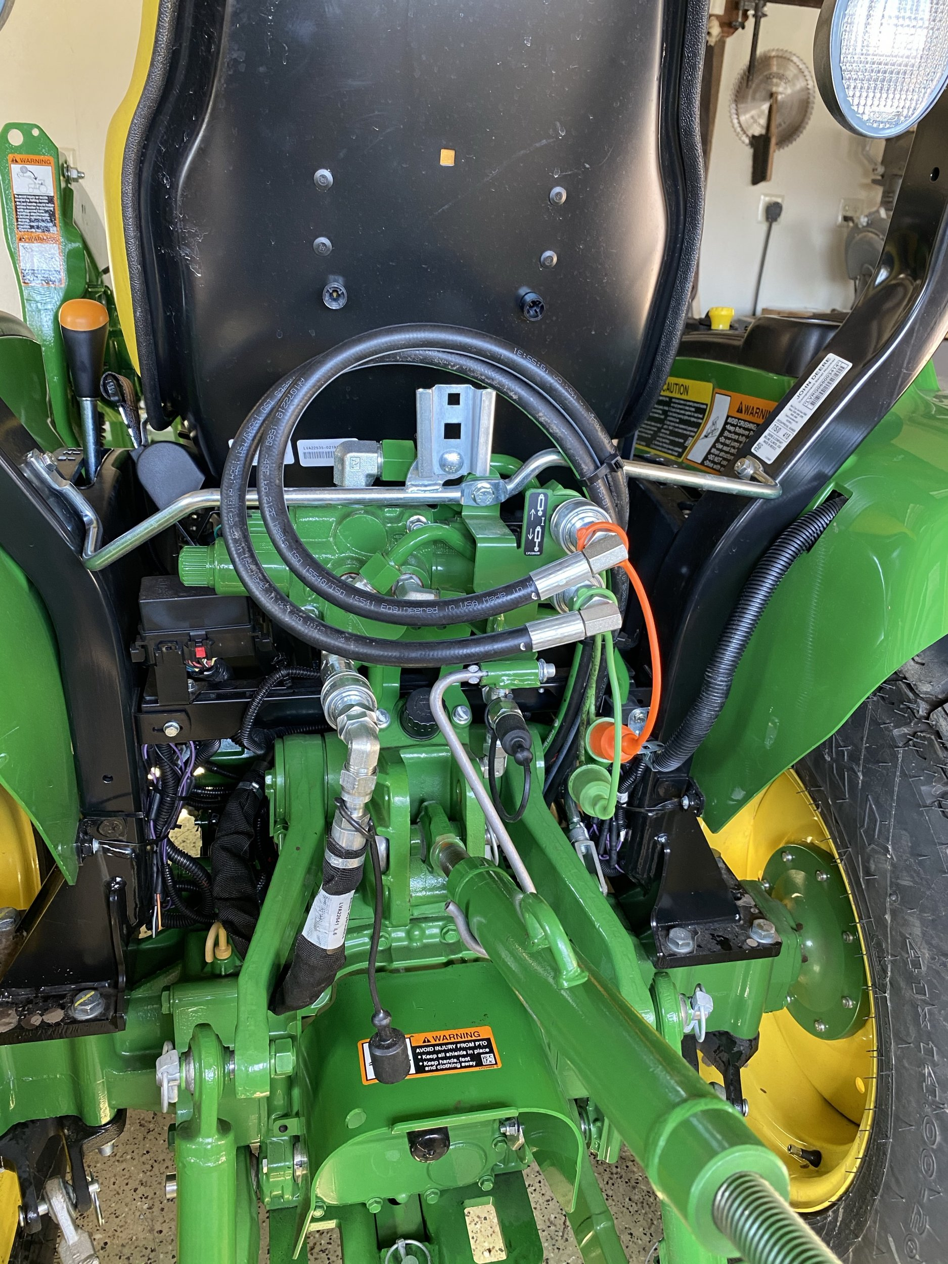

I'm hoping so. It's presently installed as a solenoid-operated valve, located behind the seat, atop the 3-point top link connection, but there's no proportional control of it (or even a simple needle valve flow control) that I can find:
/ JD 3-series 3rd function valve #4
Proportional might require replacing the complete section. Possibly just the pilot head but suspect spool could be different also to provide the metering.
Would also have to verify no space constraints since proportional control might be longer than bang, bang coils.
Yeah, definitely no room between solenoid and QC fittings. But I'm thinking there might be a place to valve between pump and solenoid.
If Deere doesn't sell an option for this, I will probably just add flow controls to the implements themselves, rather than tearing apart and customizing such a new tractor. The downside to valving on the implement is that most wouldn't be adjustable from the seat, and also that I have more than one implement that would benefit from this.
