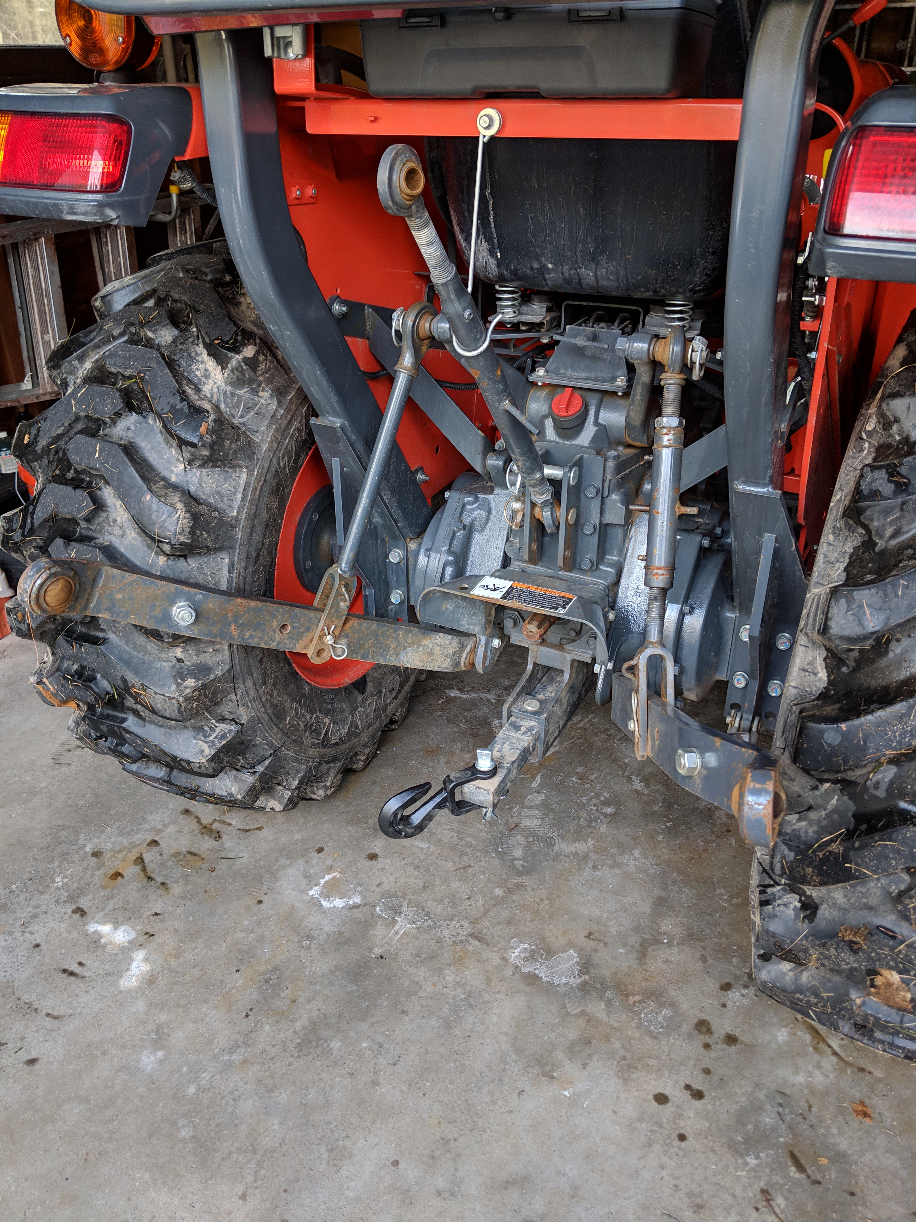

I bought a used Kubota L3800 and it arrived Friday.
Looks like the hitch and shaft have been left to the elements a little and no visible lubrication on there or the ballbearings etc.
My questions as a new owner are:
How do I clean this level of rust off?
What is the proper way maintain these, what lubricants and how often and how to apply them?
/ Properly maintaining hitch and pto #2
All I use on mine is a spray of Fluid Film. As for the rust, it appears to be just surface, nothing a wire brush wouldn't clean off.........Mike
/ Properly maintaining hitch and pto #4
You do not want to lubricate these things, dry rust dosent let all kinds of dirt stick to it. Have tractors that had regular use the last 50 years and there are no wear going dry.
/ Properly maintaining hitch and pto #5
I do lube my PTO shaft and 3 point swivel balls. Take the parts apart, wet with a penetrating spray, then thoroughly lube them with used motor oil or even better, marine grease. Be sure to roll the balls around to get them coated good.
/ Properly maintaining hitch and pto #6
PTO shaft I do but the ball ends? Get them full of dirt?

I agree that dry rust is better than sticky grease, especially if you intend to use the machine without anything on the back in dusty conditions. Keep a little grease on the PTO side of each implement yoke and that will take care of itself. Get a PTO shaft cap if you can find one, once the shaft is greased it becomes a dirt magnet. I'd use fluid film or something similar on the balls, if anything at all.

Anything that attracts and holds dirt such as oil or grease will increase wear over leaving dry.
/ Properly maintaining hitch and pto #11
I keep all of the ball and socket joints lubed on my machines. Usually smear them with grease, or a spray type grease. Once in a while I'll soak them good with WD-40 spray to clean it all off and re lube.

I lube the 3-point ball ends with sticky old grease. Same with the PTO stub. I have a cover that slips over the PTO stub. My ball ends have never been bothered with a build up of dirt or dust. Probably because I don't have or use a bush hog. I do nothing that would raise acres of dust.
/ Properly maintaining hitch and pto #20
Seems many tractor and implement dealers just toss the rubber sleeve / caps for the pto shaft in the trash. Ask yours or get them to order you one. A lightly greased and CLEAN pto shaft sure makes things easier.
The balls on the 3 point I can see going either way on the leave dry or keep greased school of thoughts.
