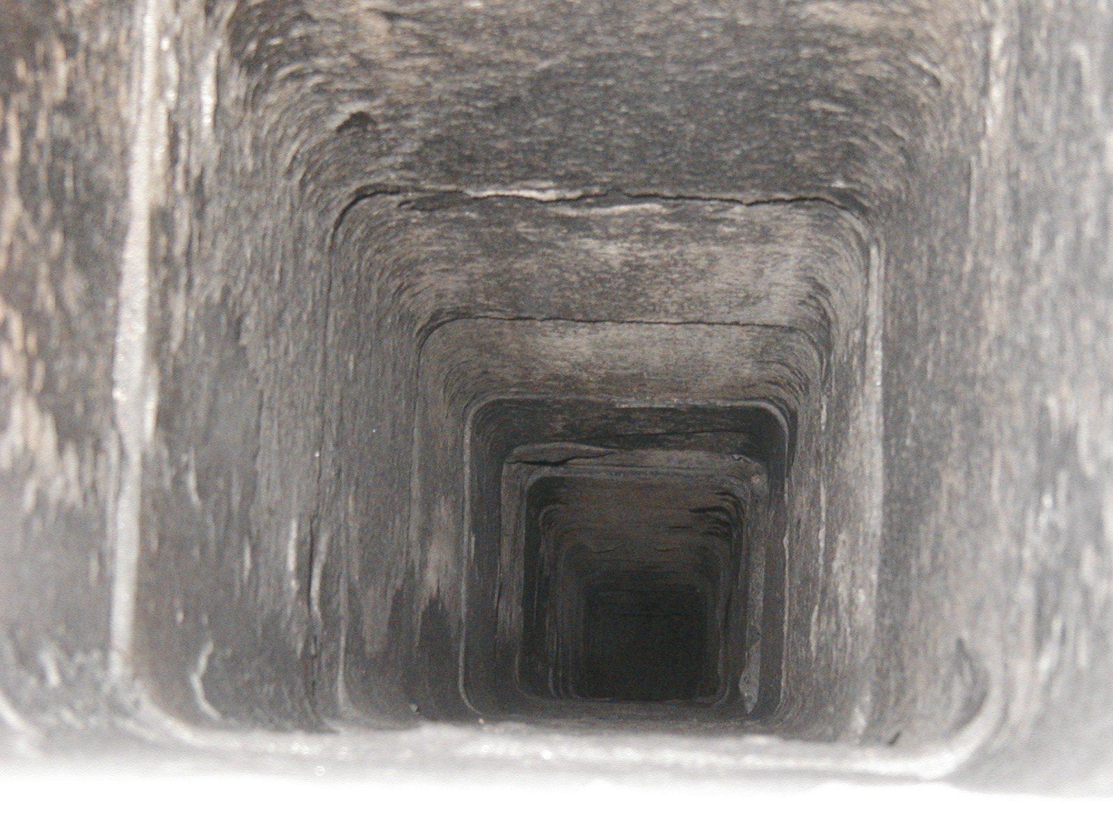

I just had my chimney lined. The original chimney was only a year old but the morter between the 8X8 clays failed. I got the same confusing information.
How did you know the mortar was failing? Did chunks fall down on the inside of your chimney? On my chimney, I have no idea how I'd ever know the condition of the chimney tile unless I called in an inspector with a camera. My tiles are very large (see photo), but I have no idea of how to check them for quality of the mortar joints.

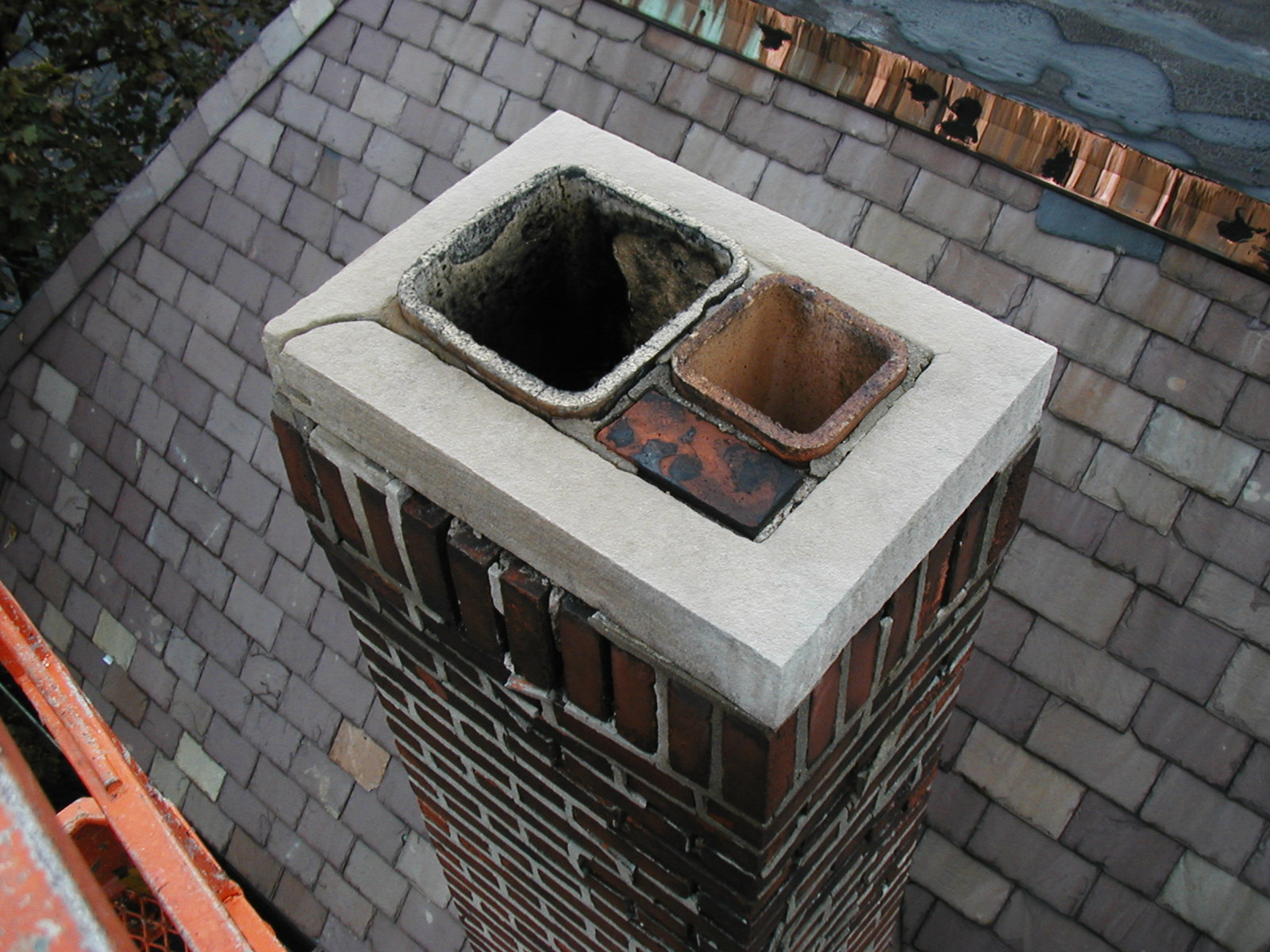

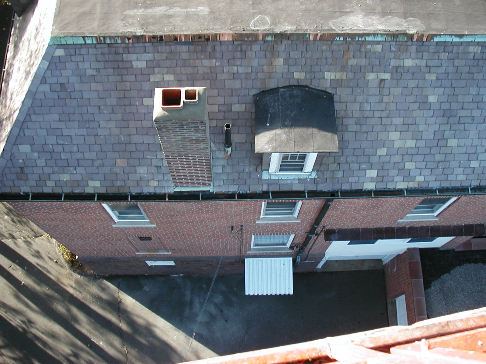

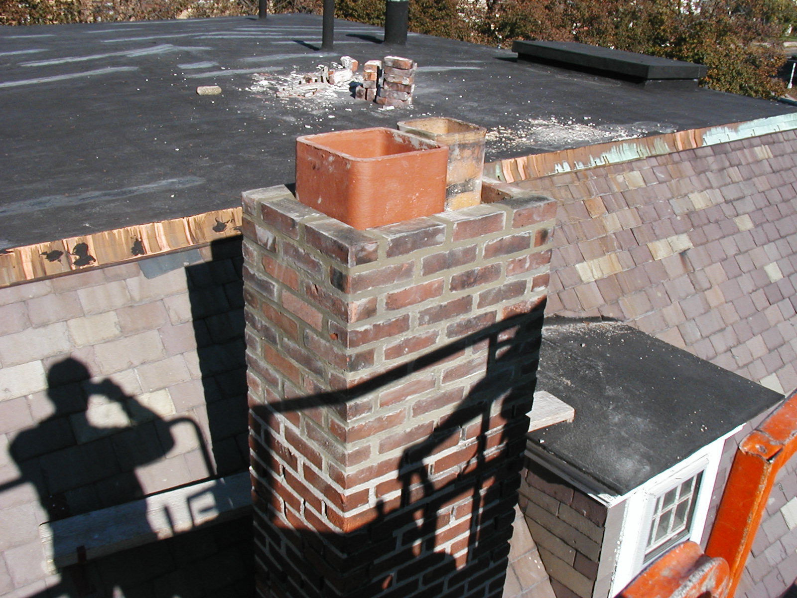

You can simply look up and down the inside of the chimney to get a pretty good idea, can't see every joint of course but with straight flues you should be able to see if something was really wrong.
If the criteria for needing a chimney liner was the condition of those mortared flue joints every 2 feet, then I can tell you from experience that almost every chimney needs to be relined. Don't forget the chimney is still a minimum 4" masonry wall, plenty of older chimneys I've worked on have no flue at all. The heat and gases tend to follow the path of least resistance and go out the big hole at the top. the worry of smaller openings in the flue passage would be if a blockage occured, then the exhaust would be forced through those openings.
That would normally be accompanied by back-up in the house so obvious it would not be possible to ignore.
I think for non catalytic stove the liner alone would be more than adequate and stack temps and draft would be within specs.
I have no experience with the new EPA stoves.
There is a pour in insulation that's added after the liner is put in, it's not as even an insulation but may be something to consider, as I'm sure it would help keep the flue hotter than without.
I have probably a thousand pictures of chimneys in all states of damage and repair, but all are before the digital age.
JB.
