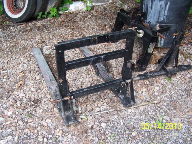

I like a big slide hook, centered on the top of the bucket, and grab hooks on the top corners. If you want to pull from the center, you can just flip the chain over the slide hook and drop it into one of the grab hooks. If the chain doesn't have enough slack to reach the grab hooks, then just hook back to the chain. I love this system.
This is a picture from when I was building my bucket forks. I used the same configuration as I have on my buckets.
These pics were to show my bucket receiver hitches, but they also show the slide hooks.

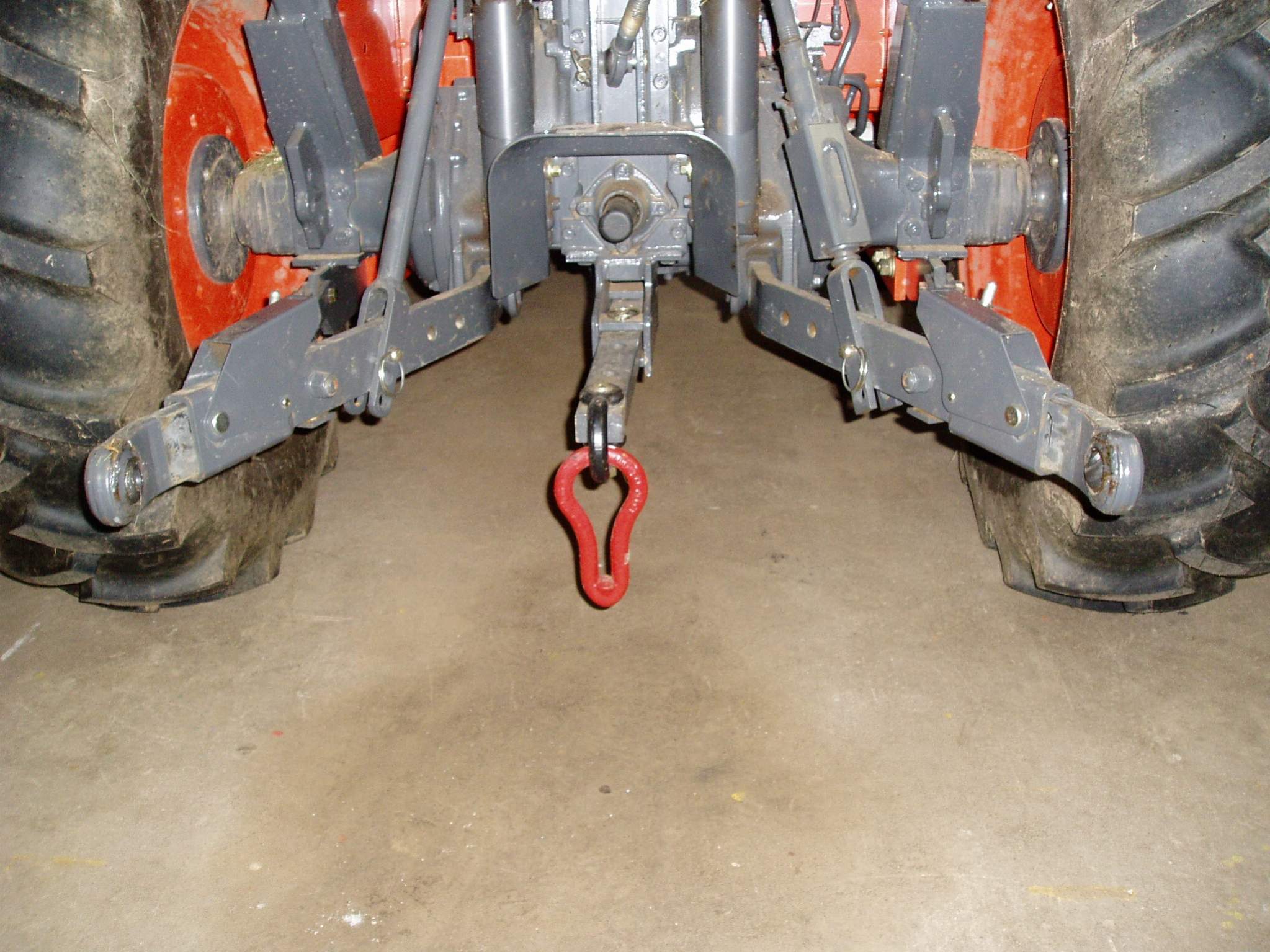

A clevis with a grab link on your drawbar will allow you to grab just the right length of chain quickly and safely:

I'm not the handiest guy in the world. What's a grab link and how does it work?
/ Proper way to connect chain #7
See babygrands pic. The chain goes through the large hole then slides down into the slotted area of the grab link grabbing the chain by a link of it.
Same would be true of a grab hook. the hook is built in a way that it grabs a link of the chain you put in it.
