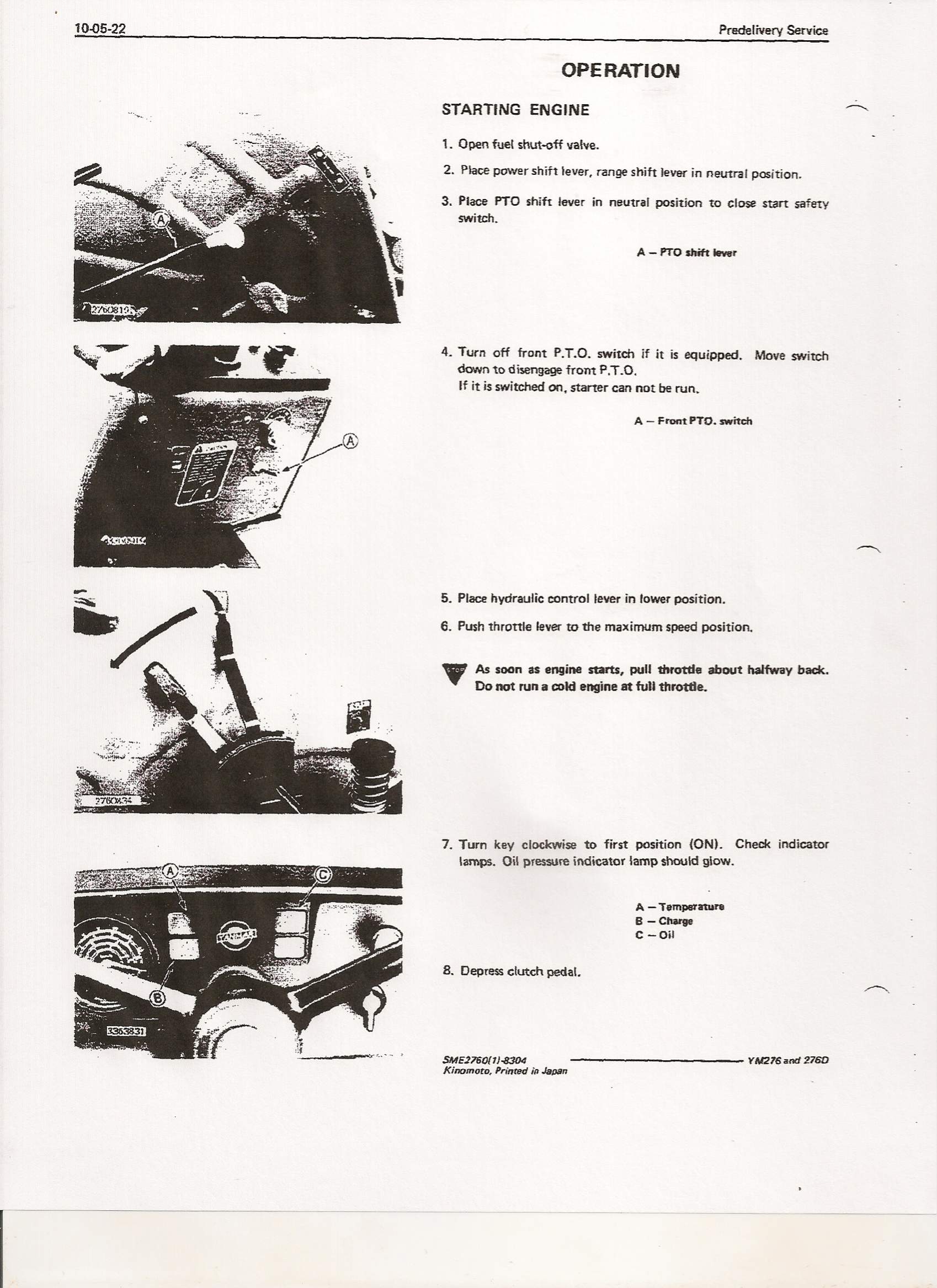

Page out of the YM276 service manual. For what it is worth (nothing) I never start my former Yanmar or my current Bobcat with the throttle in the wide open position. They both crank up immediately with throttle at idle. If that wasn't so I would use higher throttle. I wil have to conclude I don't think it is a Yanmar misprint.

/ Proper Cold Weather Starting #66
And Full throttle. If you click on the 1300 with the loader.

It seems to me, that opening the throttle to full allowing as much fuel to get into the cylinders as possibly lubricating the cylinders, allowing more fuel and then cranking the engine to receive compression and then ignition. Then immediately bring it down to the half throttle makes sense. One thing that we forget is that we also have a foot throttle we can use when we are starting. I set the hand throttle to half or high idle but push the foot throttle to the floor. As soon as i let go of the foot throttle the hand throttle setting takes over. That allows me to use one hand for decompression and the other for thermostart and starter switch.
/ Proper Cold Weather Starting #69
I was waiting for this to come up. My Foot throttle will not open up any were near Full Throttle. I've straightened the connecting rod as straight as it will go to get the Max. movement from the pedal. Any straighter and it won't connect properly or at all for that matter. Even added to the pedal. Opening all the way is Not a problem for me. I'm not starting my starting my 2000 Wide open. If you have to you have a compression problem. And Yes Scotty The Lubrication I agree with. But I get that with using the Decompression. With the Valves held open and no combustion it's not blowing all the Fuel out. Plus you get the oil pressure up before running. That's the only time I ever see that much Blk. Smoke when starting it. And Norm I thought you were through??

I tried the full throttle start on the YM186D yesterday. (40 degree weather).
I didn't like how hard it accelerated or the high rpm attained, in the moment before I could get the throttle reduced.
Won't do that again.
