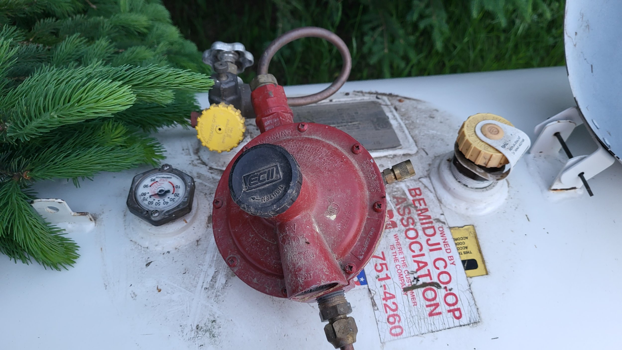

I currently have a 200 gallon propane tank. It supplies my kitchen range and my furnace, although the furnace isn't used because of the wood stove.
I am thinking about getting a propane conversion kit for my 9KW gasoline powered generator. The conversion kit comes with a regulator that is plumbed to the carb. The company's video showed the generator connected to a 20# propane bottle when they ran the generator for the demo.
My first question....the pic below is the top of my propane tank. I assume this is some type of regulator to drop tank pressure to a lower pressure?

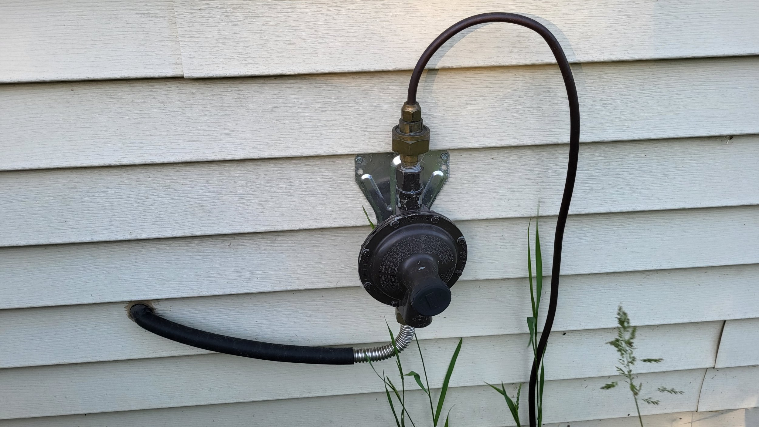

This next photo shows what is connected to the other end of the copper line when it gets to my house. The corrugated line going into the house and feeds both the range and furnace as I mentioned.
Assuming I can use the same copper line coming from the tank, how would one connect the regulator for the generator? A "Tee" on the input of the above item and a hose going to the gen's regulator?
I don't have a problem having one of the guys from the co-op come out to do this but would like to understand what he would be doing prior to discussing this with them on the phone. I can build a custom wiring harness for a vehicle tranny computer swap or build a 40' loafing shed but haven't done any gas work.

Being that you are in Mn. and judging by size of line from tank to house,odds are regulator on tank is sending gas at a pressure less than tank pressure to house regulator where pressure is farther reduced to that required by appliances. Were you in Texas where temps rarly get below 20f and stay more than 24 hours,the regulator on tank would reduce pressure to that required by appliances and send to house via a larger line. To reduce pressure at tank to that required by appliances would require a much larger (think expensive) line during long periods Mn. Winter temperature. If your conversion kit come's with a regulator capable of operating at 20 lb tank pressure as in demonstration, tee off BEFORE house regulator. The conversion regulator will work fine when connected AFTER house regulator but could starve appliances when all are in operation in cold weather. If things ran off water,the tank regulator would drop 100 psi tank pressure to 20 psi and send it to house regulator via 1/2" pipe where house regulator dropped 20psi to 8 psi then send to appliances via 1" pipe. An engine MUST be fed 0 psi via large line or regulator internal to carburetor to allow engine vacuum pull gas as needed. Your conversion kit regulator reduces whatever pressure it's fed to 0 psi.

It's ounces of pressure in the house.

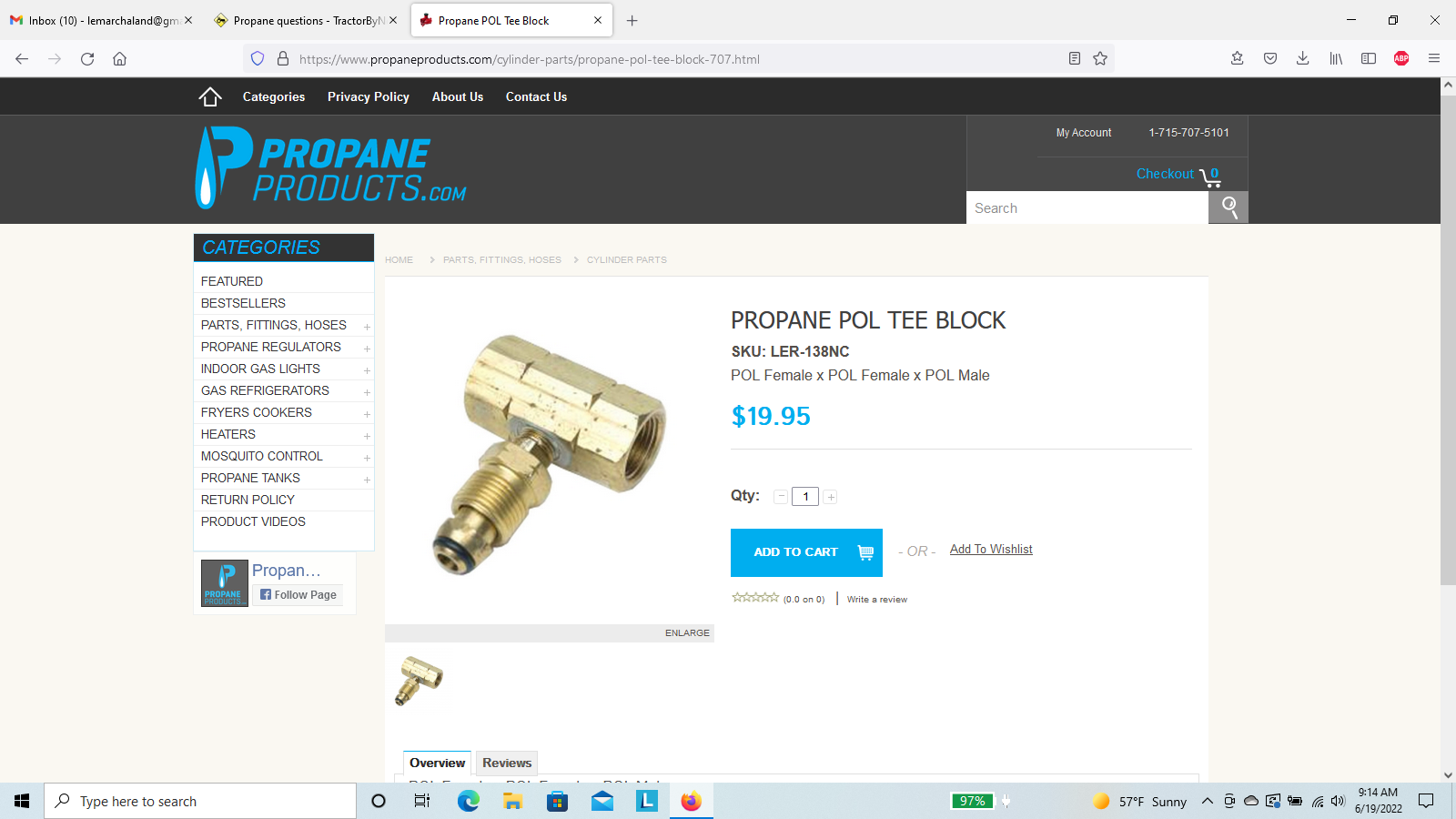

If the propane carburation kit you are looking at was feed directly from a 20 pound propane bottle,
simple get a tee for your propane tank and install it before the first regulator and run a feed to the kit.

There is more than one way to do that. But I would bet that the propane dealer would use a manifold. Entering fuel from the tank into the manifold and with two or three (or more plugged) exits. If that is the case, they will install another regulator that feeds the generator.
OR:
the regulator you are now using is a two-stage regulator. If the existing regulator on the house has the capacity to add the generator, that might be possible if the generator runs at the same pressure. But I don't think they would do that.
I am wondering - is it two stage because of a long distance to the house?

Yes, I did read his post. I am very knowledgeable on propane, and what propane can do when it is not properly set up. He has a two regulator system. The first regulator decreases the pressure down from the tank pressure so it doesn't blow out the supply line. The regulator at the house takes it down to the pressure required for the house appliances.

Yes, that is correct... appliances require 8-11 oz of pressure. That is probably not enough to supply the generator. Was the regulator that came WITH the generator specified.... no it wasn't. So why do you think that didn't help?
I have a tankless 199K BTU water heater. It REQUIRES a 1" gas line and 14 oz of gas pressure. Totally different from every other appliance in the house! Is the generator the same? Don't know.....

What you have is a typical twin stage system red regulator ( 1st stage ) takes the vapor from tank psi to 10PSI before it goes through the through the 3/8 copper. Second regulator brown Rego takes it from 10PSI to 11-13" of water column before it go's in the house. The rest of the answers depends on where you want the generator to sit. I would guess somewhere outside near the electrical panel ? I agree the smartest move is to have your LP supplier come out and give you a quote before doing the install. The liability of doing it yourself is much greater than the cost.
