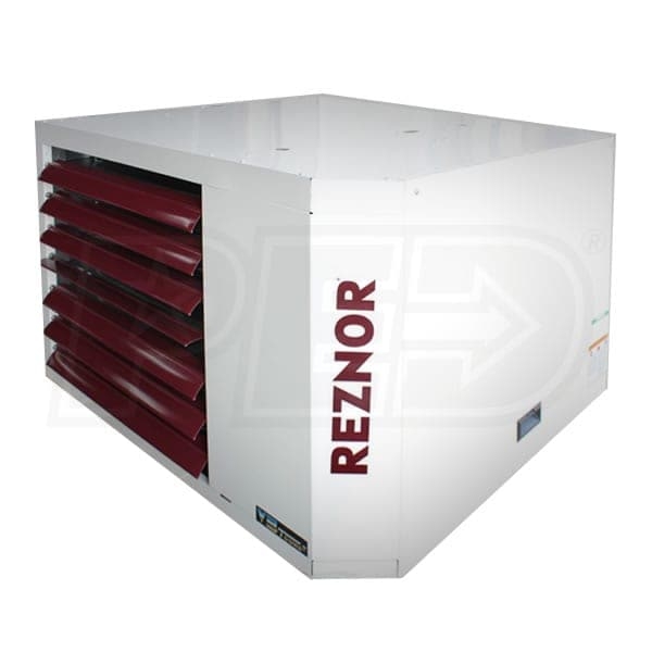

I have a 36x48x14 tall pole barn and i actually have a Reznor forced air heater and also a radiant tube heater. They perform very different and can consume a lot of energy depending on circumstances. My personal choice is the Radiant heat. There is no substitute IMO. Only downfall I feel with the Radiant tube heater is you need to maintain a certain temp in order to use less energy. (I know sounds backwards) It will suck a lot of propane if you are trying to heat a cold shop with it. I mostly turn mine on in early October when the concrete and all the steel in the shop is still warm and i maintain it throughout the year.
Forced air in a cold shop and the top half of you will be warm and the bottom half will be freezing along with your tools and everything else. It takes a very long time for a forced air heater to heat a shop evenly.
I attached a pic with both of them in the shop.
