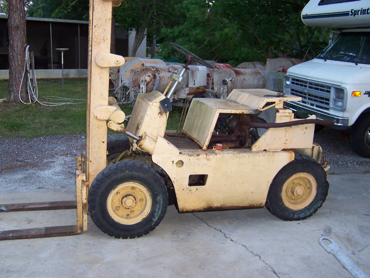

I found those mast bearings on ebay a few years ago for a good price.
I bought this Jewel (???) from a junkyard for $200. about 10 years ago and brought it back to life.
Counter weight, seat and side doors were already scrapped.
It would still lift about 2000 lbs.
I bought another complete one off of CL for $800. and sold the pictured one.

Here is my replacement Lift.
I got this for $800. It didn't run and had stuck valves and distributor was froze and could not adjust timing.
#4 cylinder is dead but it still has enough power to move on flat ground.
I haven't pulled the head out of fear what I will find and have to go deaper.
Good thing it both run on GAS and have large tires, very hard to find.

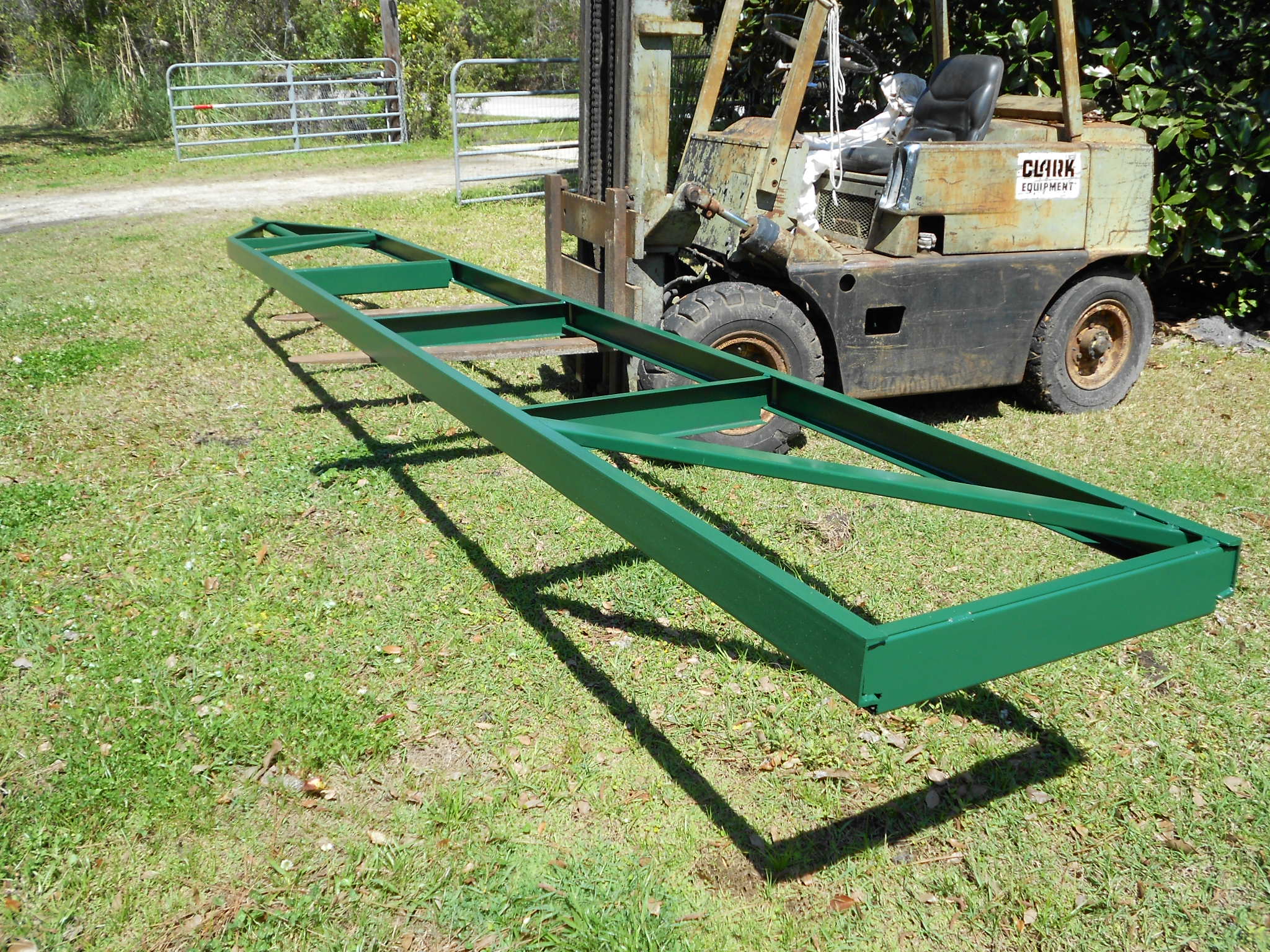

Ok well I picked up some 6' fork extensions from the local scrapyard. 162lbsx0.40$
They need some work. Started cutting out the damage and will weld in patches. I am on the lookout for a fork boom pole too
/ Project Clark forklift #20
Those must have been used on some pretty stubby forks to have that much wear in the middle. I looked for ages to find material to make fork extensions, finally found a couple 7' 4x8 I beams on craigslist and got them for $40, along with a nice chunk of 9x.250 flat bar that I used to extend the tips to 8' and make the bottom plates. True, they're about an inch and a half thicker than proper channel forks, but when you get into that size you're not sticking pallets anyway.
