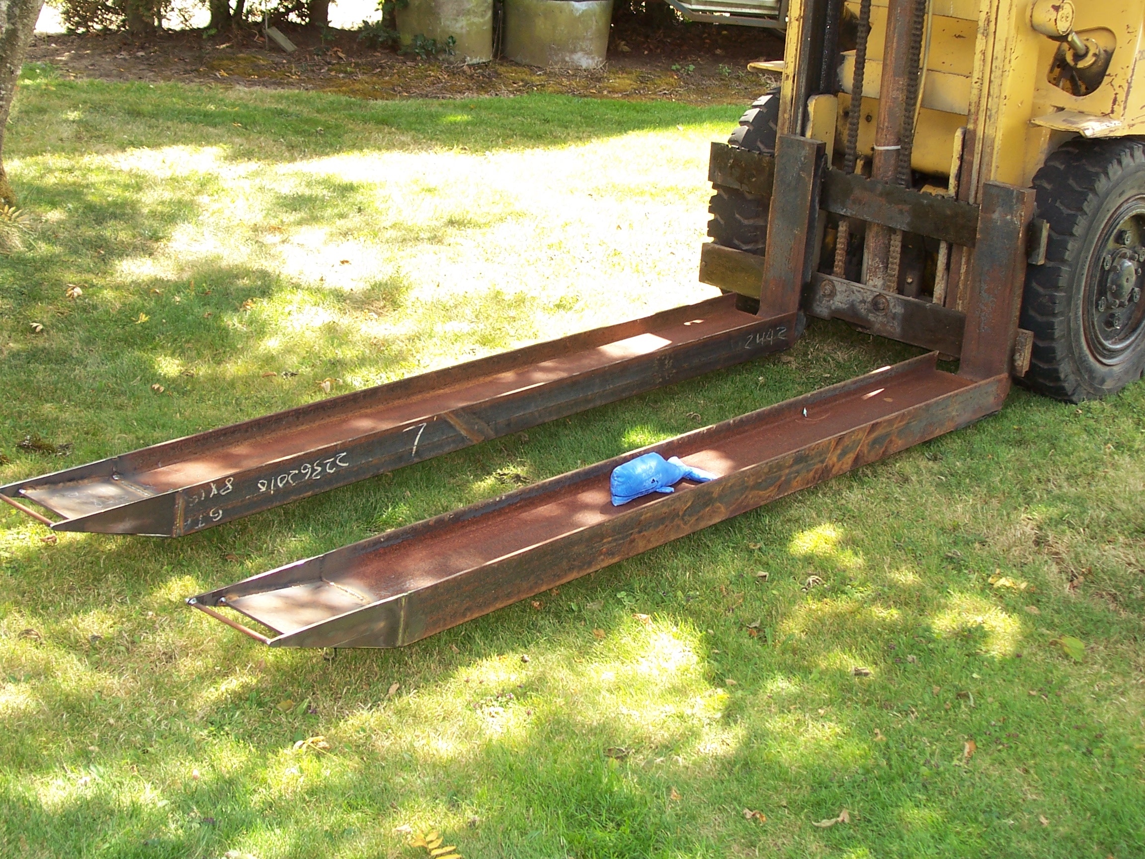

Ya I'm not sure. Years of grinding on hard surfaces did them in. I straightened out the tabs on the one to the left tonight. Off to the scrap yard tomorrow for some plate

Patches cut and fit, nice patina match!
Welded
Ground smooth
Nice increase in length
/ Project Clark forklift #23
Looks good, those have the proper taper and everything. Having the extra length comes in handy sometimes, especially on big bulky items like pickup toppers or beds. I picked a whole S-10 Blazer body off the frame without a bit of damage, would have been nearly impossible without the longs.

Well u did some nice work on those custom forks!

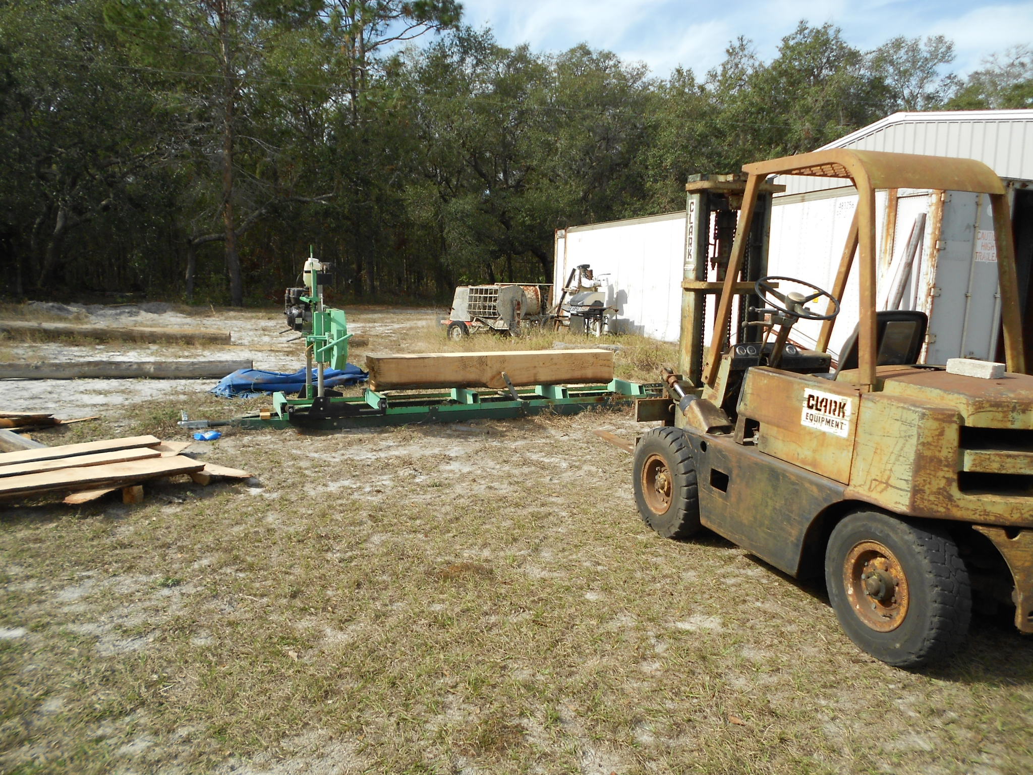

Nice to have the Clark back and the extensions are great. Good to move the crawler out of the scrap pile. Time to pull off the pto from the parts machine and sell the rest

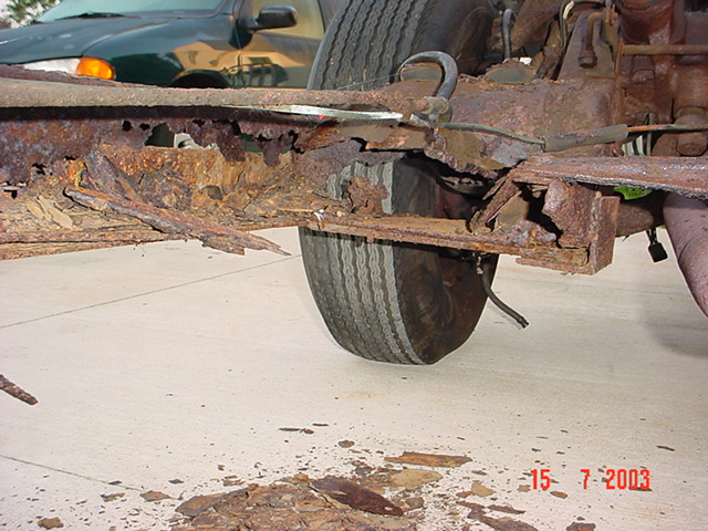

hmm, i'll be sure to check everything out before pulling the engine, but shes definitely puking engine oil and ATF, seems the seals are most likely the reason...worked on it some more today, new coil with correct terminals, cleaned up some wiring, removed about 100 wire ties that were haphazard holding everything in a jumbled mess, adjusted the mixer a little, it runs like a top! put a couple tons on it, went up/down ramp to check slippage/brakes, one bake locks easier than the other, but heck, it runs/works fine...weathering a couple years didnt seem to harm it, other than ignition crap from getting rained/snowed on...think only got 200 in parts in it, and confident its driveable enough to get on a trailer and off at home...just calling to find someone to haul a 9900 pound chunk, or someone with a heavy equipment trailer to haul it home. found engine overhaul kits are pretty cheap(mits 4g63 2.4l near as i can tell), but it runs good enough, might just do seals only(will def check out breatheres and such like you mentioned- might get lucky!) figure maybe 500 for paint/seat/decals,couple hundred for a few loose steering parts, seals, should be able to have it looking like new again for not much cost, but a little elbow grease...love saving stuff from scrapyard demise...dont always make sense, but its a hobby, and hopefully my kids great grandkids might still be able to use some of this crap 50 yrs after i'm gone- some of this stuff can last forever with just minor upkeep/service...might be 'old' by todays standards, but not necessarily a bad thing...other save is a little scissor lift thing, should be handy for putting up garage ceiling- its been outside like 5 years, is gonna need fully rewired, one cyl wasnt retracted will need rod/seals from rust, rest looks like will just need tore apart, polished up and new seals... I got a pair of little scissor tables like 20 yrs ago, salvaged them, put 120v drill motors to change from 3 phase pumps, made a nice setup for pulling the body off a old ford... heres some before/after pics of past 'scrap' that was brought back from the brink...that Galaxie was a bear...
