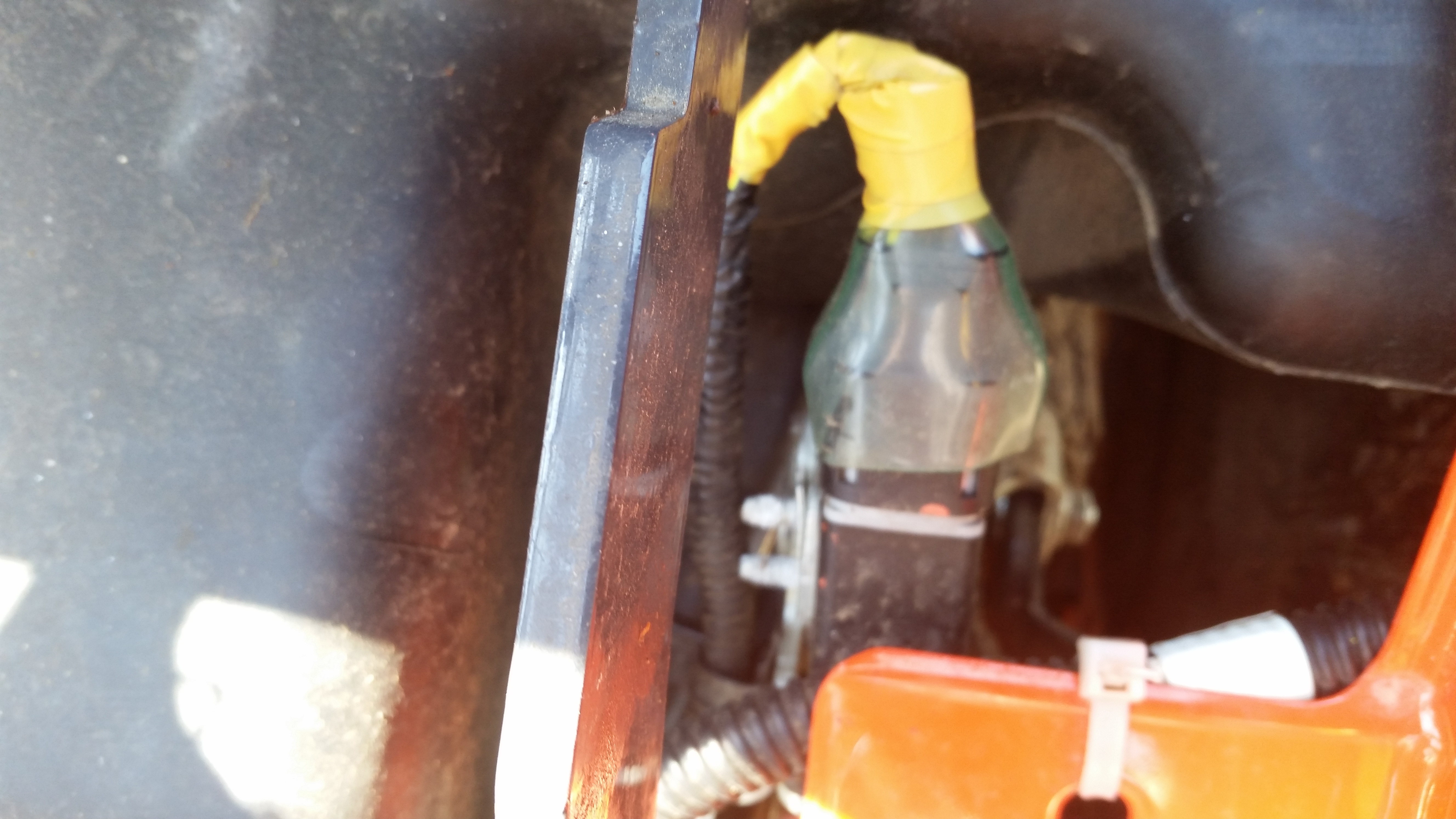

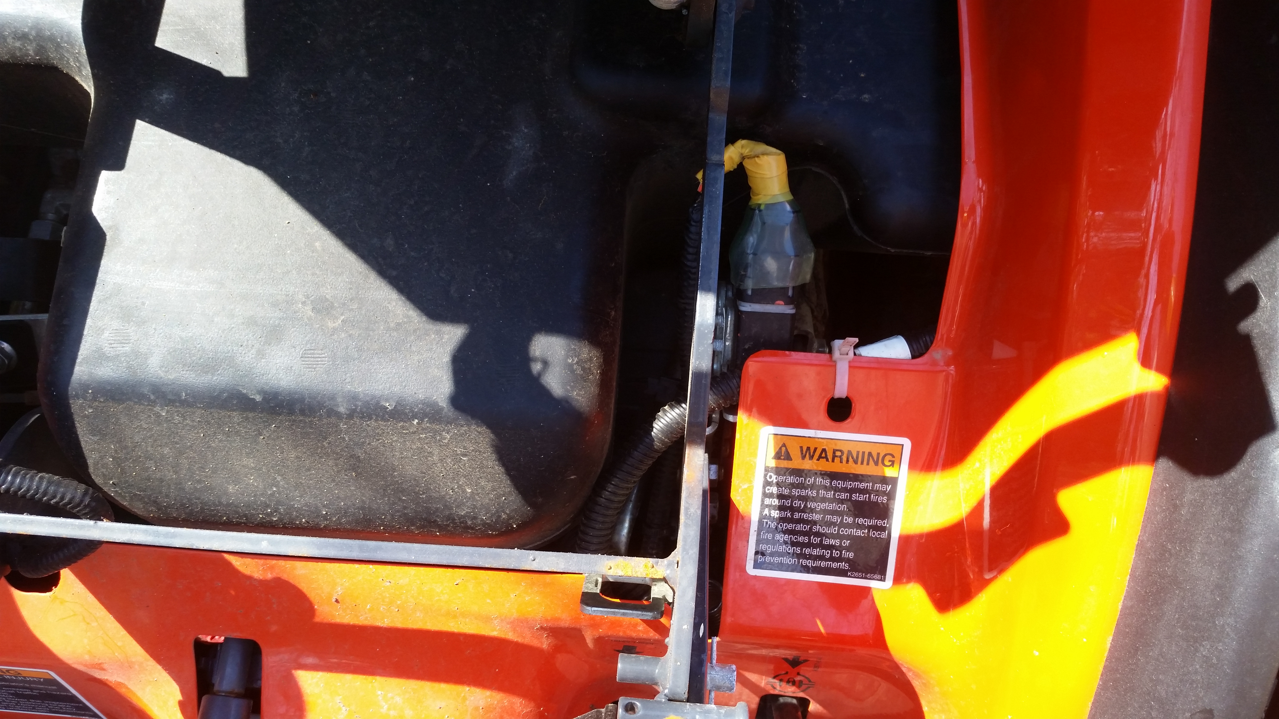

I got this tractor a month ago . It has 7.8 hrs on it.last Thursday the seat release lever fell off. On Friday I put it back on and found a electrical connector that looks like it was done by a kid. The wire is so tight I cant move it and fell like this is going to be a problem down the road. Well I started digging with the back hoe and oil started spraying out.The dealer is coming out to bring replacement parts for the seat and I will ask him about the oil leak and the electrical connector then. I will post pics of the connector and my question is would this have happened at factory or the dealer ship? Thanks Roger

/ problems with new kubota bx23s #2
That is hilarious... you are right -- looks like some kid did it.
Hopefully the dealer will repair with like OEM. Trust me, you don't want seat switches haunting you down the road.

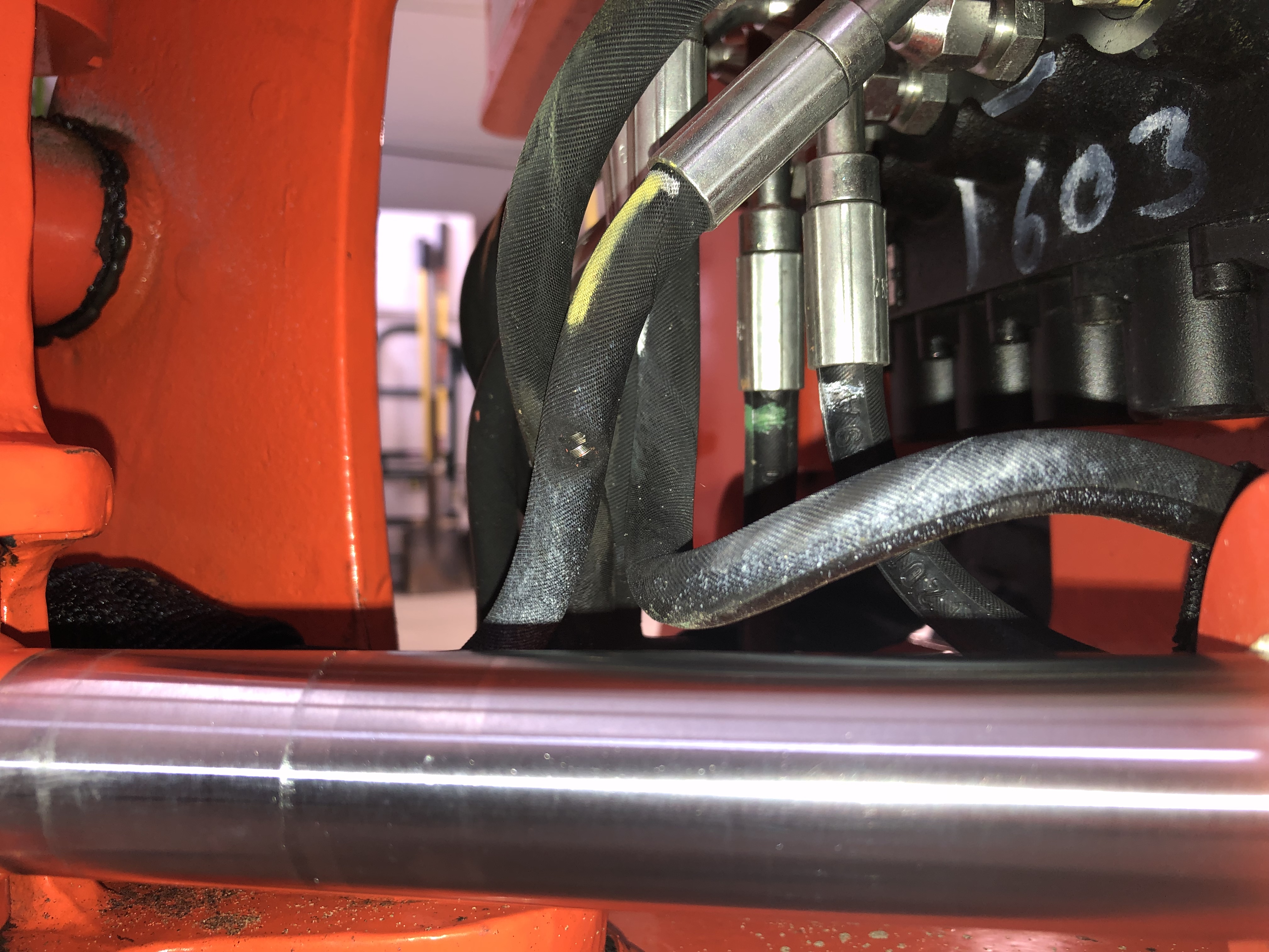

Hydraulic leak is probably from a misaligned swing cylinder hose that got pinched. It is a FACTORY problem that has been going on for well over half a year. We have to reposition the swing cylinder rod end elbow on every BX23S that we receive.

I tightened the fitting on the swing cylinder and the leak seems to have stopped. Took a pic of hose to check the clearance and wow, its rubbing.

Ok dealer came out and replaced the hose for the swing arm. I told him about the post that says to move the angle of fitting (thanks RickB) so it don't rub and he agreed. Problem resolved. On the tape job on the seat switch, we untapped it and there was nothing wrong with the wire or switch but someone thought it was better to tape it up to keep water or what ever out and just didnt do a good job. I retaped and dont think there will be a problem with that.The seat lever I think the whole problem was the cotter pins they use on the Kubota tractors will add pic.I put the old fashion cotter pin back in. seat should be good.
