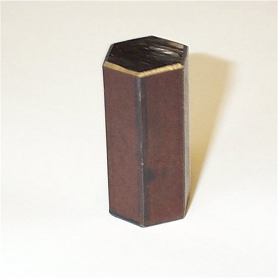

Hey guys,
Put the new battery in and am waiting for the block heater to arrive from Tractorsmart. How bout a lead on where to get one of those 17mm hex nut wrenches. Thanks
John
/ Problem starting TLB in the cold #24
I got mine from Sears, its a Craftsman. Came in a nice plastic carrying case.

Ok guys got the block heater in. I contacted a TBN member that has the 17mm hex bit to see if I can get it. If not I will try my local Sears. Fungus, Just one other question. Where did you get that nifty little black cover for the block heater for when the AC plug is disconnected? My block heater did not come with one. Thanks
John D.

B21nut, I would be happy to loan you my 17MM bit but I think the shipping would cost more than it.
