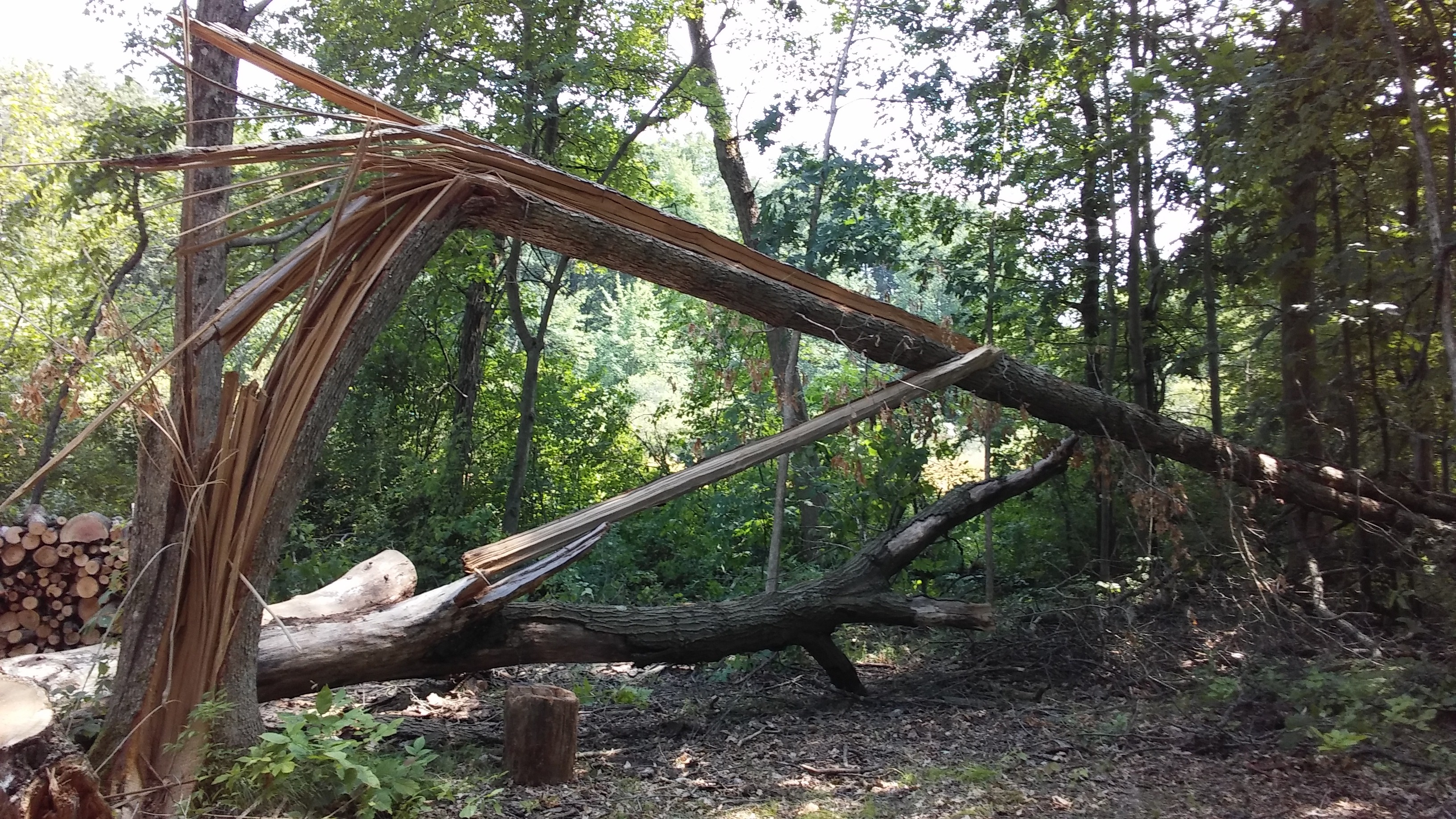

White Oak snapped over when Red Oak behind i was cut.
~ 2' dia and the hinge is ~ 8-10' high.
It needs to come down so clean up can continue.
How do I go about cutting it down without getting the saw caught or killing myself?
Access to the back side is restricted by the Red Oak behind it.

This could be a pretty "touchy" situation to comment on. Reason - no idea what could happen when you start to do something. I would start by "chunking up" the horizontal portion. If you can get to the horizontal portion - saw off short chunks - starting at the top of the tree. When that is done or you have reached a point where you can no longer cut chunks - make several shallow cuts into the vertical portion. Idea being - slowly relieve any stress in that vertical section.
Be very careful. Best if you have another person there with you when this is being done.

-I'm not a pro, but I did stay in a Holiday Inn once-
Like Oosik says, start chunking at the top of the tree.
If weight is being supported by top of tree, most of your cuts need to made upwards (bottom-to-top) through log. This is harder than cutting downwards. Or, if cutting downwards, use wedges so trunk pinches wedge and not saw bar.
Think through and pay attention if 'kerf' is opening up or pinching down before saw gets completely hung up. Have more wedges and a big hammer nearby for miscalculations.
As you chunk up the top, if shredded "hinge" is weak enough to keep bending, the new "end" you create at the top with each cut will continue to rest on ground as trunk gets shorter, and trunk's angle gets steeper.
If eventually only the hinge end supports the whole shortened trunk (top end is off ground), you can weaken the hinge, or create a new (proper) one below it, by backcutting just a little at a time (i.e. not all the way through) to pivot trunk more to keep lowering the top in a controlled manner; or if you feel safe enough, to eventually cut trunk completely off at stump.

I would throw a chain around the truck near the hinge point and pull it, chances are you might just snap it. If that doesn't work then move the chain further away on the intact trunk to get some leverage and start pulling and possibly twist on and snap the hingepoint.

You are going to need to cut that on the inside of the butt a bit, notch it slowly with a chain on it. Don't bind the saw though..
/ Pro Loggers - More advice needed #9
Get a chain and toss it over the butt end just in front of the hinge. Tie it off to something heavy and back at a safe distance, like your tractor. This is to prevent that hinge from snapping back while you take chunks off the top of the tree. Once you get to a point where you think there is not a lot of weight on the top of the tree, try and ease the tension off the chain slowly to see if it will snap back some. Then you know you have the stored energy in the tree, weight, somewhat reduced.
Then you have to deal relieving the stress on the compression side of the tree, the tension side is all splinters. I would reposition the the chain on the tree and keep tension via the chain to make sure there is downward force acting on the top end, it dosen't have to be a lot, you just want to keep it in the bent over position while cutting. Then, very carefully, make cuts in the compression side until it breaks. Don't get panicky and in a hurry, just take your time and work with a purpose, it will come down.

The suggestions make sense to me.
Thanks
It's gonna take some clean up of fallen, broken branches and trimmings before I can get to any serious "chunking".
Already got 6 trailer loads of chips from what I have cleaned up so far.
And a good amount of firewood stacked up ready to split.

I would nibble at the upright part with my pole chain saw from about 10 feet away. Maybe cut the top half of the tree off first.

IF I had a pole saw, I might have tried that but.......I don't.

Amateur tree cutter here... I've done about 50-60 trees per year for the past 10 years for firewood. Most 1/2 the diameter of that. But the same principles apply when a tree gets hung up, or I'm clearing wind downed trees. Just giving some examples and disclaiming any suggestion that I know what I'm doing or giving advice. So there you go. :laughing:
If it was my place and me doing the work, I'd start way over at the far right of that picture, and as others have mentioned, I'd start cutting from the top of the tree and work my way towards the stump. I'd do all of the cuts on the main stem from the underside, as the top of the tree is putting pressure on the upper side of the stem. Underside cuts will open naturally and not pinch the bar as the stem falls down to the ground with each undercut. Watch my feet, and watch for possible rolling of the main stem. Work slow and methodically, etc.... I'd make cuts about every 4' and keep dropping the main stem to the ground with each cut. Eventually, it would get to a point where that shattered part of the stem will not fall any further down, and that's when I'd tackle the main trunk like a normal tree, and again, as someone mentioned, I might wrap a chain around the shattered main trunk to keep it from shattering any much further.
Anyhow, if you're not comfortable doing it, you could always try and pull it over with a tractor, truck, winch, come alongs, cables, etc... or hire someone to drop it for you.
Good luck with your project. Take your time and think if over. :thumbsup:

It is impossible to say from a photo. But this is what I MIGHT do. I agree to start cutting, or simplifying the top, but after each cut you need to assess what is happening and where the pressure is. In the end when you finally cut the butt you want the top supported by the ground but free to roll sideways and not trying to spring up and back against the vertical section. You don't want the top hanging out up off the ground. I would not keep cutting the top off until it was off the ground and I couldn't reach any higher because if it stayed at an angle, or it could even start to rise at some point, it would put a lot of stress like a leaner on the splintered butt where you need to eventually cut. But if the top just continues to fold and rest on the ground keep cutting. To me the ideal would be for the top to be folded and near hanging vertical but resting lightly on the ground. When I got it to an inverted 'V' with the top resting on the ground and not springing back I would cut the butt so the whole thing fell sideways towards the viewer or perpendicular to the plane of the 'V' if it rotates when you free the top. The notch would be on the side so there is some solid wood and it should not act like a leaner , NOW, this would be my original plan and would have to be continually reassessed. If you are not sure or confident that you can recognize what is happening pressure wise there is no shame in getting help.
This is just what I think I would do from the photo - at best it gives you some things to think about the same as the rest of the advise.

Half the butt is just ugliness, I might cut that away first just to make the job less "vicious".
Then , as mentioned by others, start cutting the "tree" to the far right until the "hinge" up high starts to hold back the droop. You don't want stress!
Then waist what is left of the butt on both sides 90 degrees to the stem . Pull the thing over toward the camera spot with a cable and tractor. Use the saw tip to make a series of nicks for this cut to avoid pinching the bar.
Clean up the mess. ;-)

His ugly butt (lol) will likely keep the trunk stable as he’s making it into a small log from the top end.
I’d only cut the butt end when far end makes you raise saw up too high to cut. And then I’d only cut it enough (not completely through) to s.l.o.w.l.y. lower the far end again. If possible.
I’d say there is an argument to notch the butt end initially when the trunk’s far end is on the ground as there will be less stress in it than when it is hanging in the air. Then do the backcut(s) later.

The ugliness I see is not providing any material support for what is left. If in doubt, move up the trunk 8 inches.
The Tree has split off the left side of the butt. Get rid of it early so as not to confuse the more critical work.
I would not make any saw cuts near the ground until that top hamper was resting on terra firma.

Cutting the ugliness first to get it out of the way makes some sense, maybe, but I am not sure I would want to make my first exploratory cuts with that splintered hinge 10' over my head. The tree does not look big in the picture. They usually don't. But he did say it was 2' in diameter so it needs some respect I would think.

I've been playing with chainsaws for the last 45 or so years. At one time I used to buy firewood clear cuts from the Fed. Gov.
I've had my share of hang ups & leaners but never a barber chair or split like this.
If it was my place and me doing the work, I'd start way over at the far right of that picture, and as others have mentioned, I'd start cutting from the top of the tree and work my way towards the stump. I'd do all of the cuts on the main stem from the underside, as the top of the tree is putting pressure on the upper side of the stem. Underside cuts will open naturally and not pinch the bar as the stem falls down to the ground with each undercut. Watch my feet, and watch for possible rolling of the main stem. Work slow and methodically, etc.... I'd make cuts about every 4' and keep dropping the main stem to the ground with each cut. Eventually, it would get to a point where that shattered part of the stem will not fall any further down, and that's when I'd tackle the main trunk like a normal tree, and again, as someone mentioned, I might wrap a chain around the shattered main trunk to keep it from shattering any much further. I like that idea.
I've got a LOT more time then money now that I'm retired and I am using it.

That's why I came here. I'm sure I can get it done but just wanted to get some other eyes on it & pointers from those more experienced then I.

And I thank you for that.

This might be a place where my HF 12k winch with the remote control comes in handy.

The split goes all the way to the ground on the one side, cutting the trunk is going to be a wait & see how things are going.

Thanks again for all the thoughts, keep them coming, it'll be a few days before I get into the trunk yet so I have time to learn more.
