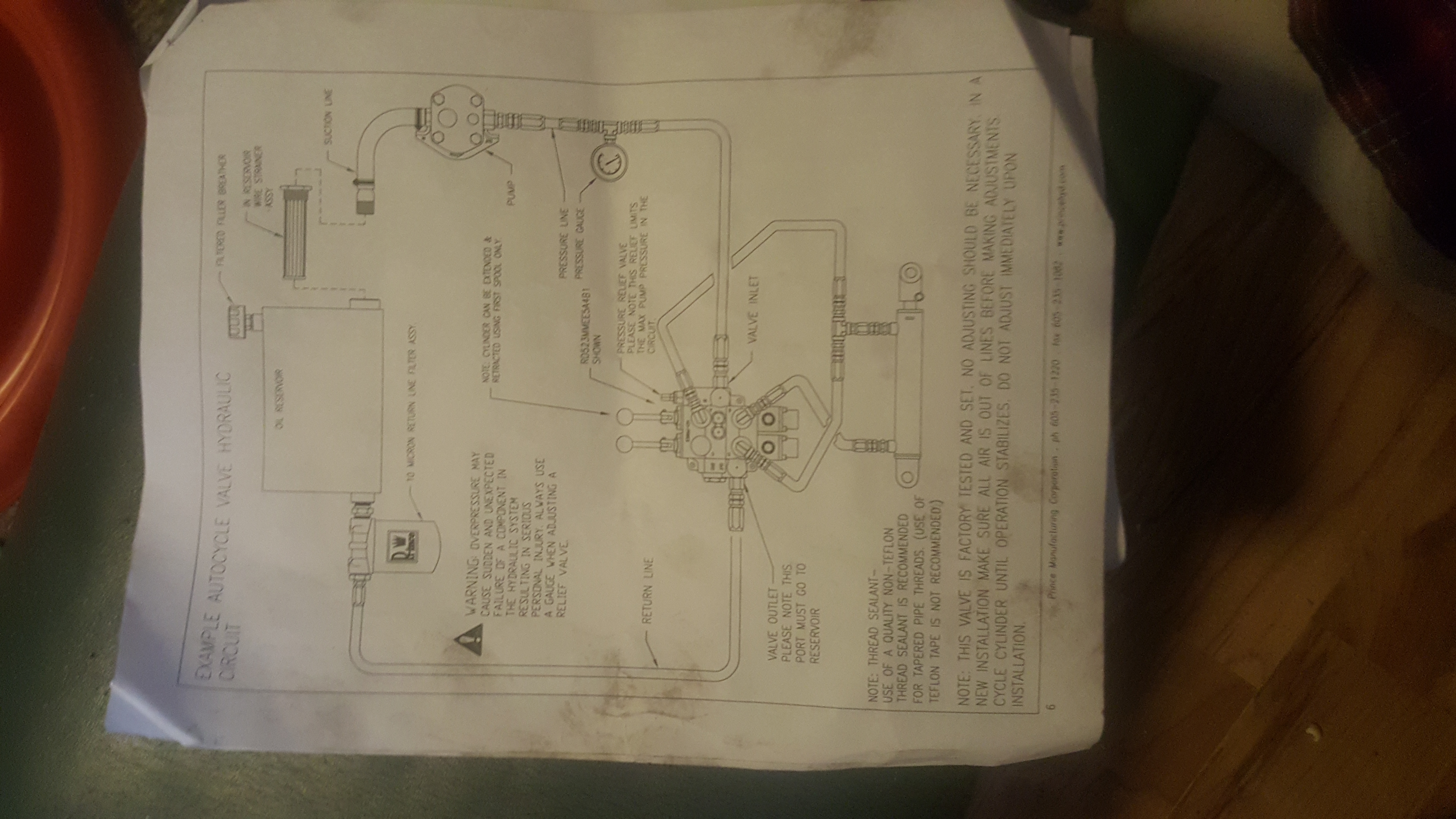

installed on new splitter I've built.its an rd 5000.problem is it doesn't detent either way.and when it gets to the wedge it won't go into relief it already broke a pin in the wedge and I saw it start to bend my cylinder rod but I stopped it in time.
I have the schematic .is it the spool pressure release I try to back off on each?

Did you plumb it backwards? If you have the pressure and tank ports reversed it will do what you describe. If it is that way luckily you haven't blown the pump, cylinder or a line.
/ Prince autocycle valve
I plumbed it exactly like the diagram showed.the ram goes back and forth fine ,just doesn't detent or go into relief

I guess I don't understand that part.if I'm not using the power beyond port I can't just leave the plug in it? It doesn't show in the directions to return both to the tank.so am I suppose to t the out and power beyond together and return to the tank?
My salesmen says I don't have power beyond.its capable of it but some extra peice to buy.he thinks it could be I have a few hoses in my plumbing that are two small
/ Prince autocycle valve #8
There are 2 versions of the valve the one without power beyond has just a tank and pressure port. The one with power beyond has 3 ports pressure, tank, and PB if it has the PB port It has to be plumbed to the tank it cannot have a plug in it.

You can see the difference in the machining on the side ports.

The splitter seems fine now I think it had air or something I cycled it at least 20 times both detents work.perfect. I do however have leaks to solve could you tell me what they are called I need o ring boss 3/4 here ill show pics
