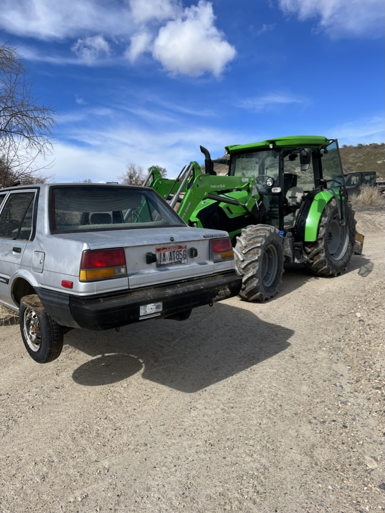

The Titans had no problem with this, not that you want to try that with a sub compact though! But the car weighed in at 2500 pounds. This wasn't what bent the frame on mine.
