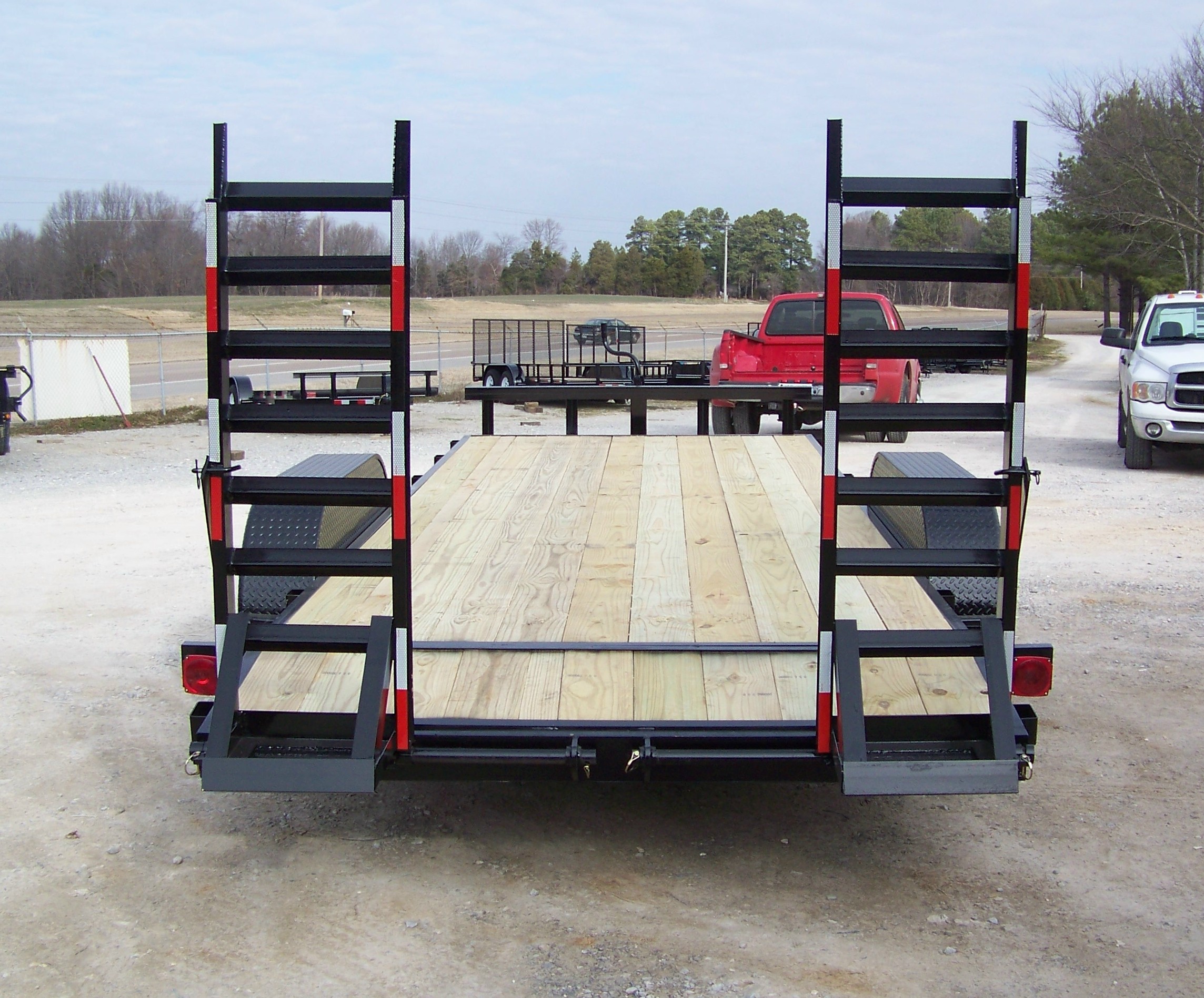

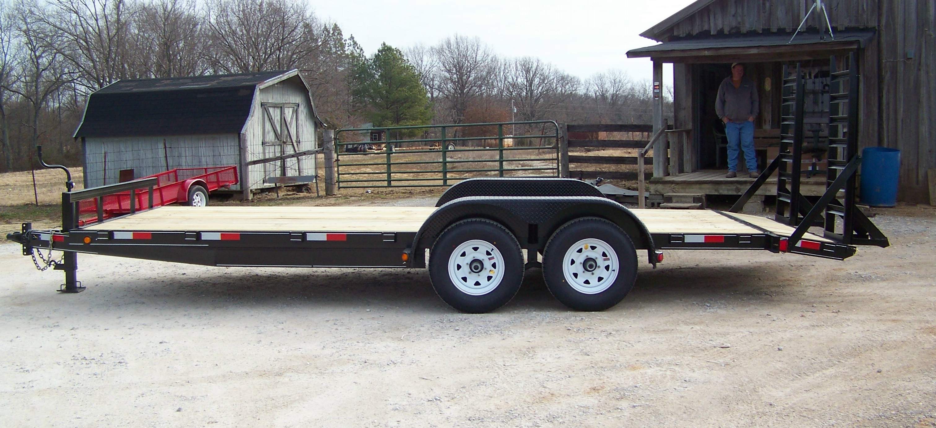

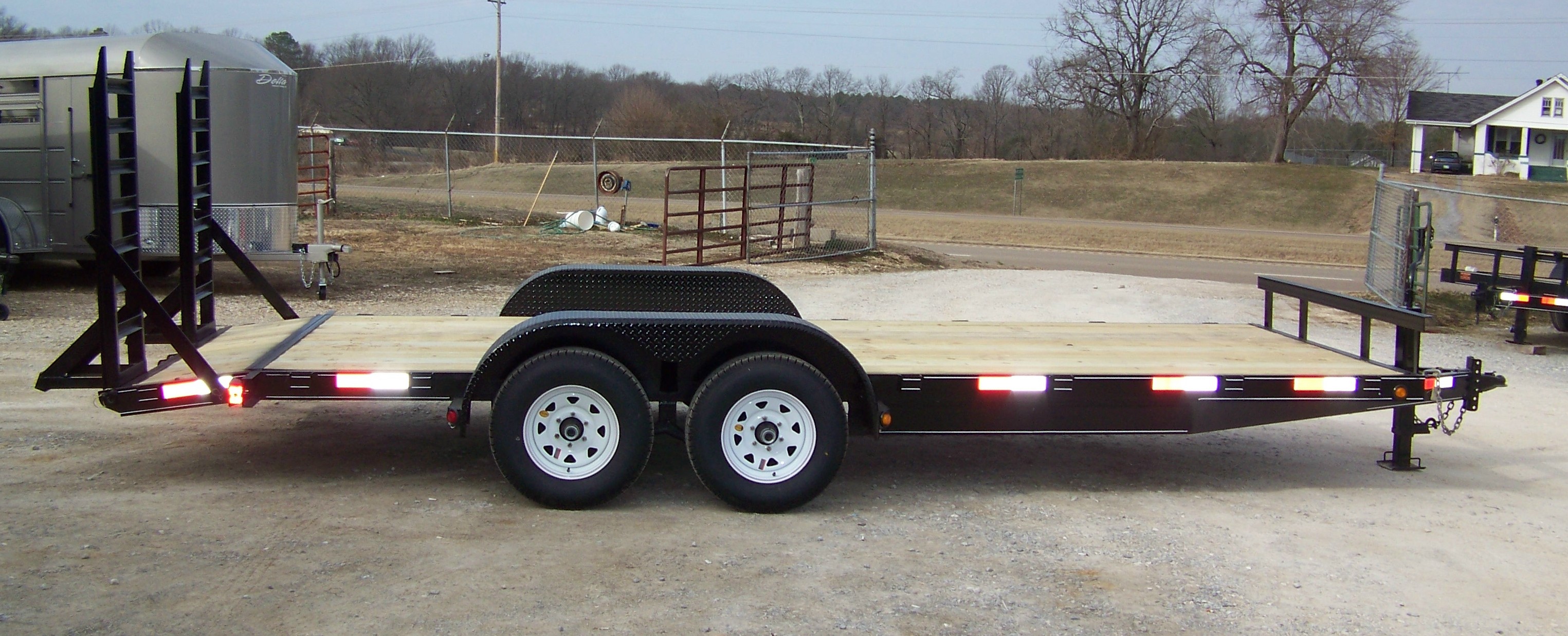

Not sure where you are? I am in west tn and bought the following for $2545 2 months ago..
Trailer is New,20' long,6'10" wide,2' dove tail,5' heavy duty stand up ramps,treated floor,2-5200 Lbs dexter axels, brakes on both axels,8ply 15" tires,6-lug axles,10k jack,D.O.T. Ready,2-5/16" Adj.Hitch
The bull dog hitch is a name brand and is just the hitch that is welded on. Good hitch.. I like the fold up ramps I have and the my frame is heavy duty 6inch channel.. it also has the break away kit... This will give you something to compare against..

The brake away kit is a simple box on the front of the trailer that has a small cable that attaches to the truck in the event that your trailer comes off the truck it pulls a pin in the box that automatically locks the brakes, It is electrical as the brakes are electrical also.. I also have one on my 5th wheel and had it catch something in the bed of the truck while turning last year and it slammed the brakes on.. it works!!:confused2: I had a 16ft with no brakes for about 6 months-- got frid of it for a 20ft with brakes.. GO with 4 brakes its worth it.. The ramps are the only other thing I would tell you go for.. If they are not mounted to the trailer they are heck to pick up and attach to the back EVERY time you load unload.. They are heavy!! thats why I suggest the folding attached ramps.. Mine will come off with one bolt per side if I really wanted to take them off.. Keep looking I bet you can find new in OK between 2500-2800??

The other thing is if you look at the fold up ramps in the picture someone posted you will see that they kneel down to support the weight as you drive the tractor on. If your vehicle isn't overly heavy or if you ever want to drive a very heavy tractor on, some way to keep the back of the trailer from sinking (and lifting the back of your truck) is worth thinking about.
