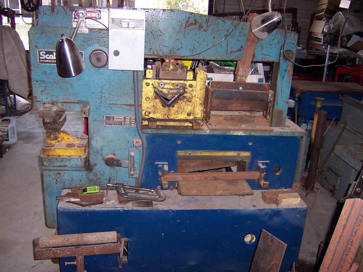

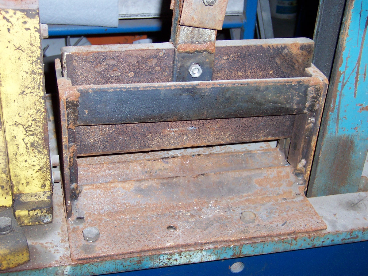

I have a 50 ton (rated at the punch) Scotchman Ironworker.
I made a press brake for it. For the bottom I used 3 pieces of 1/4" X 2 X 2 angle iron in an upside down "W" . Top die is a piece of 3/4" steel gound to a "V" and then radiused.
I can bend 1/4" x 12" (brake width) or 1/2" X 4" with no problems.

Stimw, that is cool! I would be in heaven if I could ever get an Ironworker. There is a shop that I get some metal from and they have like three or four of them, I would like to be trapped in that building for a weekend! LOL
Looks like your brake has had some use too.
I'm only running a 12.5 ton air over hydraulic jack at the moment, the whole press is homemade. I may try a piece of 3/8 x 6 that I have just for fun. I have a 20 ton jack that i would have to run manually if needed. The die is sitting on a piece of 5" I beam so I don't think that will move.

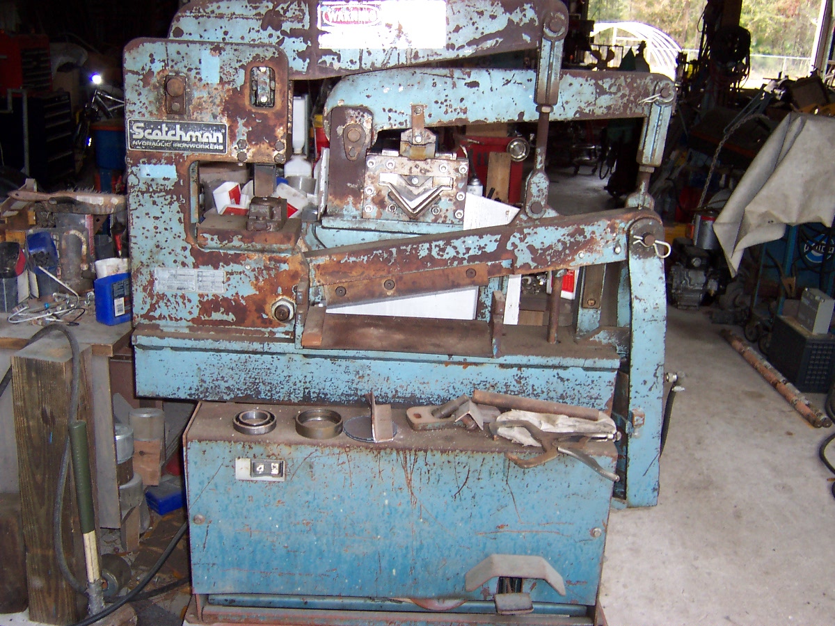

The top pic is my 50 ton, this pic is my 35 ton!!!
I got a good deal on the 35 ton and planned to resell it BUT it looked at me with those sad eyes and there was no way I could let it go!!
My problem is I have been welding and fabricating for many years and all I can think about is how much work the machines would have saved me if I had them back when!
