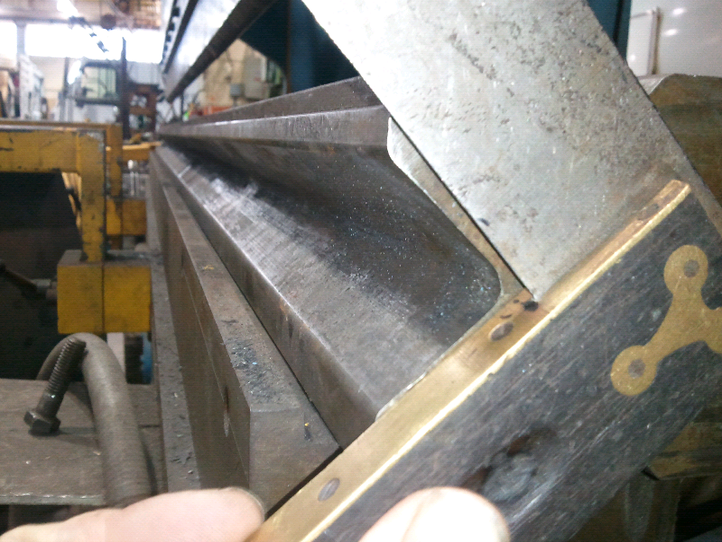

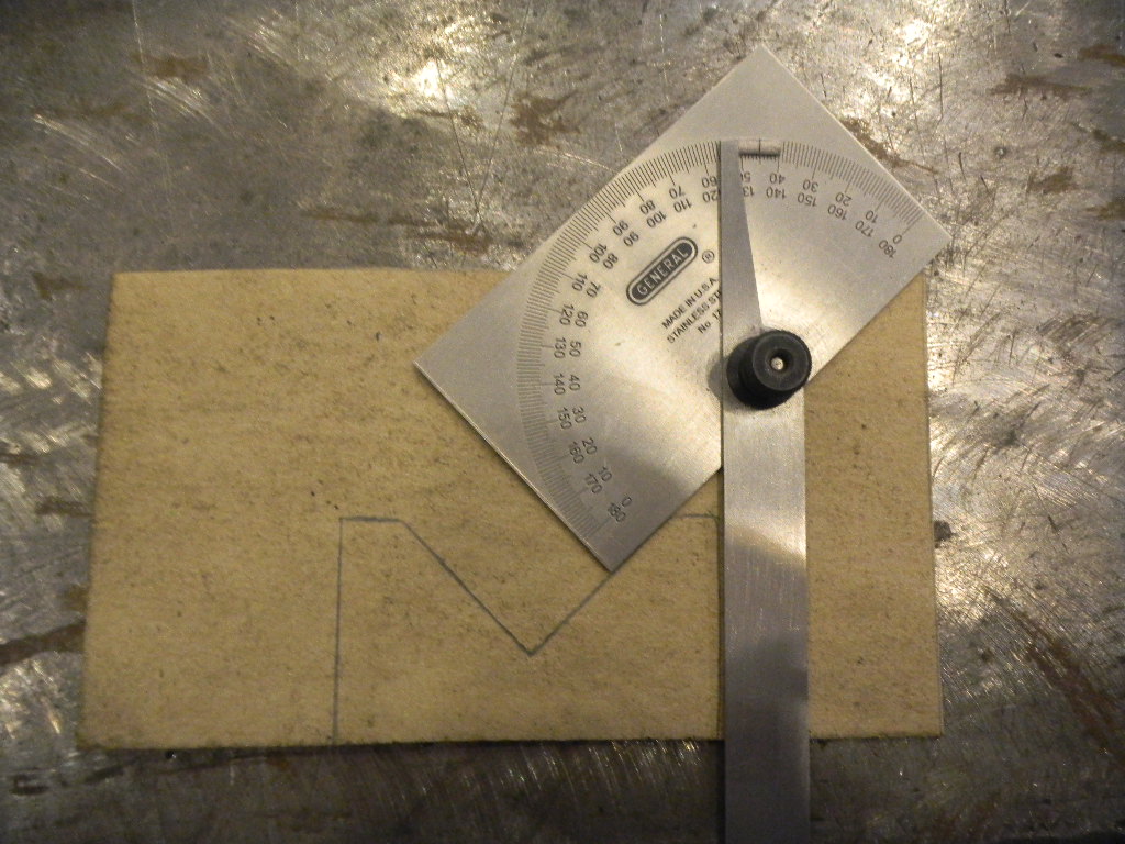

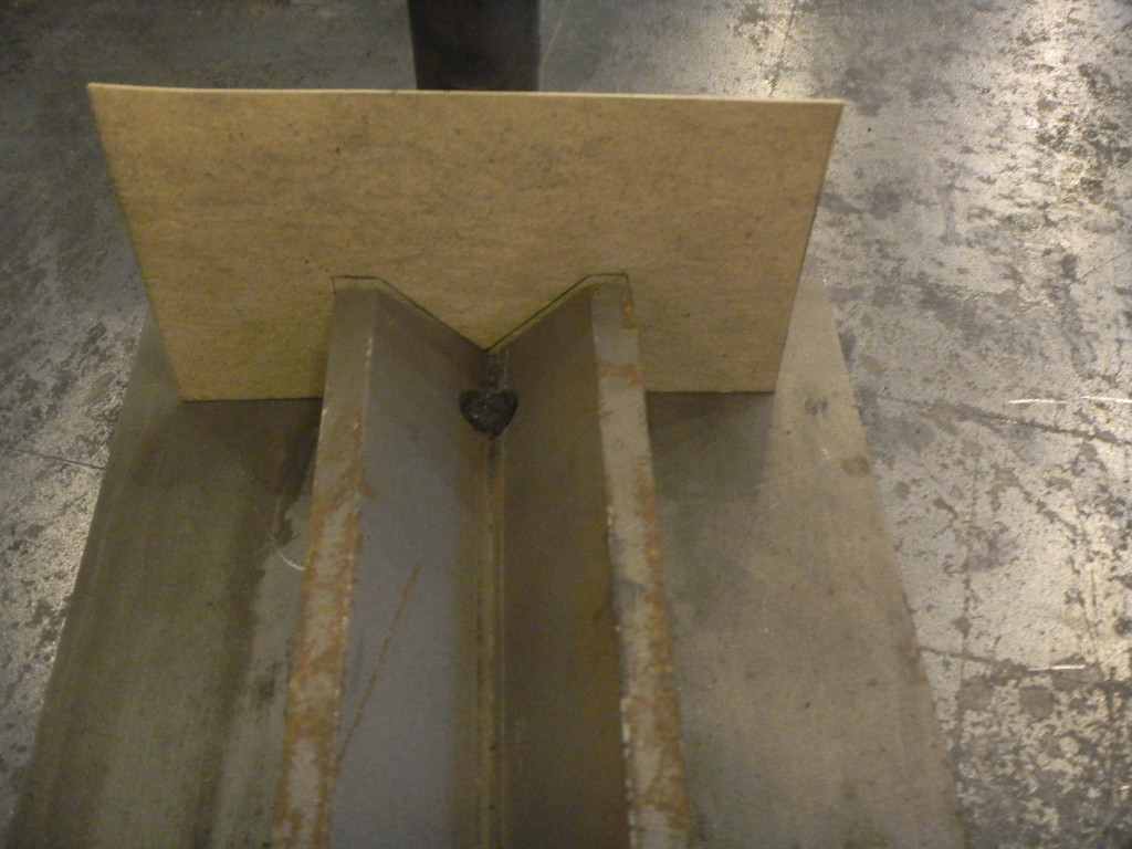

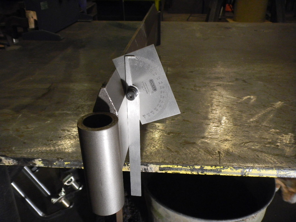

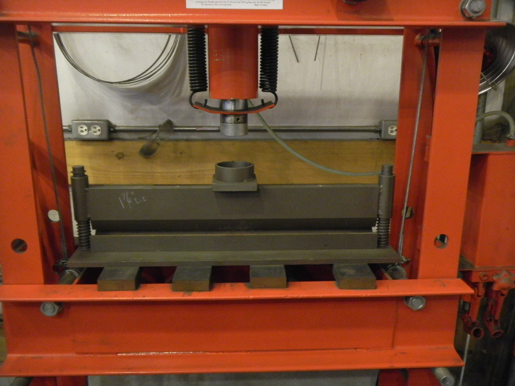

I would say 80, maybe 85 even. Just took a picture for you.
/ press brake die angles? #4
How many degrees did you get shield, sorry I cant see on my phone.

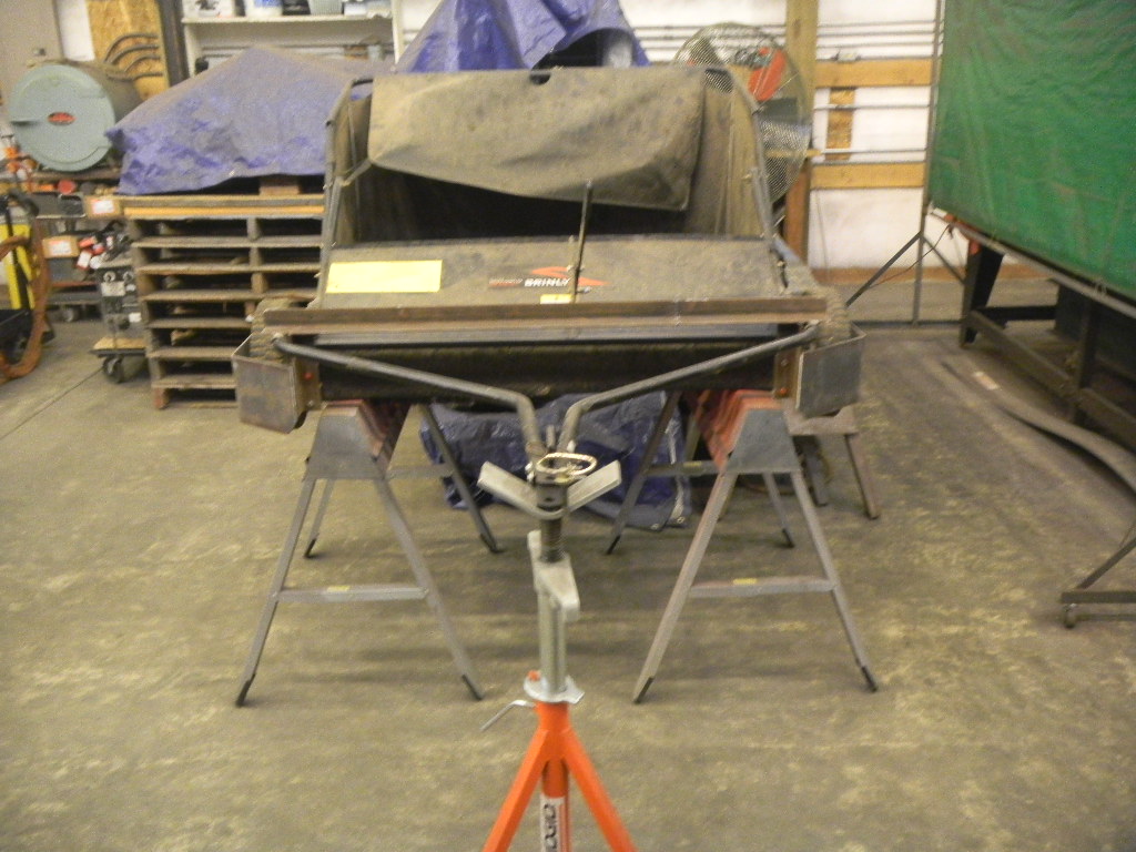

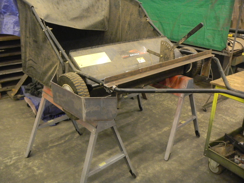

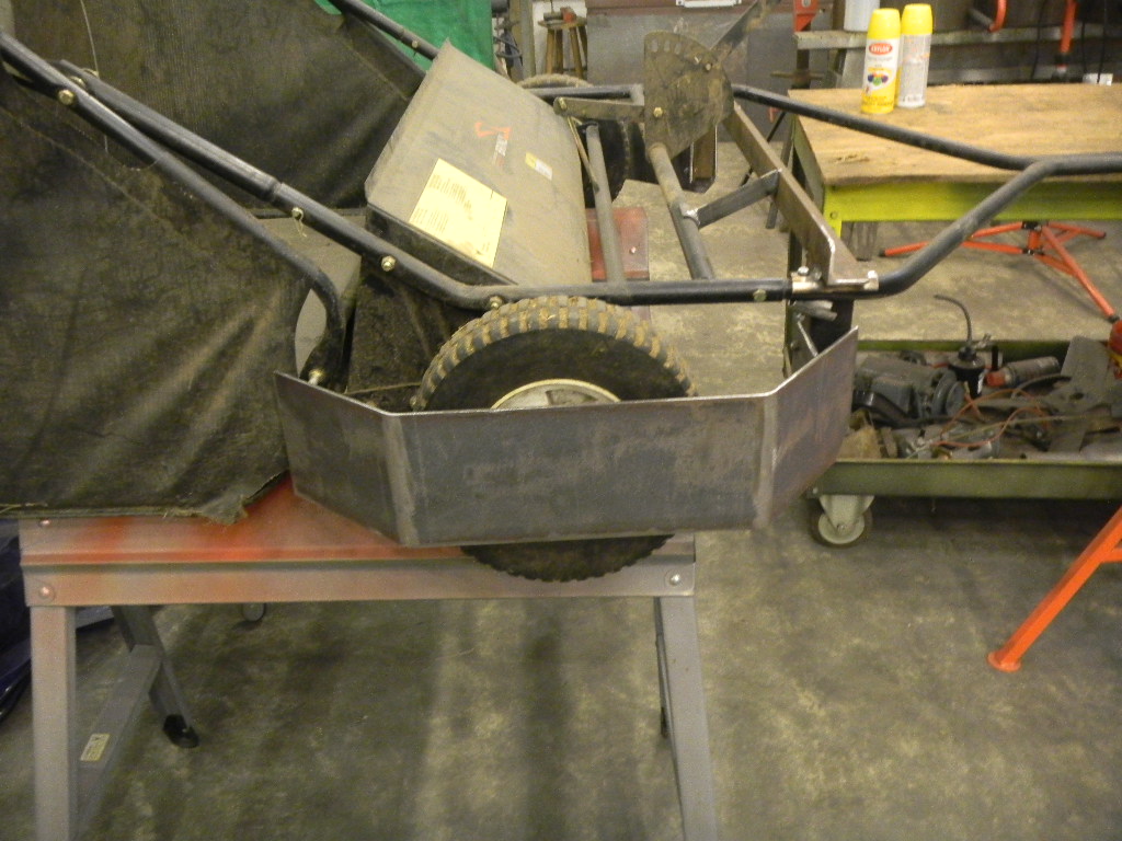

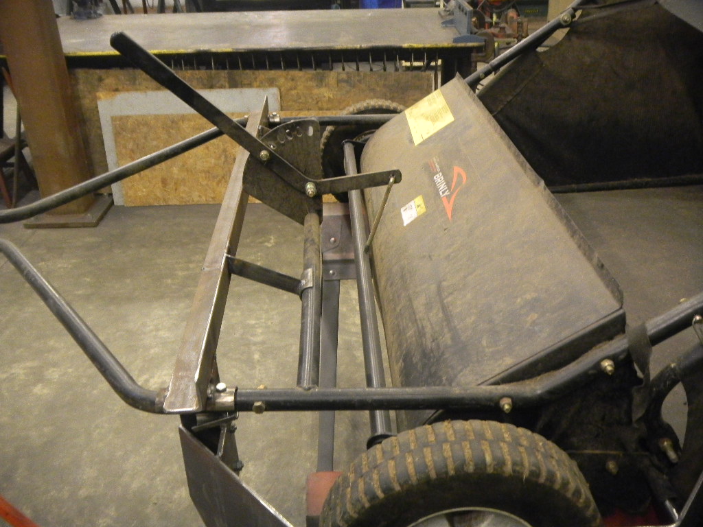

I don't use the break a whole lot, but it does came in handy once in a while.
I built some wheel guards for the lawn sweeper a few months ago. When my wife gets on the lawn mower with her books on tape plugged into her ears, she never looks where the wheels are when making a turn:mad:! So it was either build this or keep buying wheel assembles!:rolleyes:
