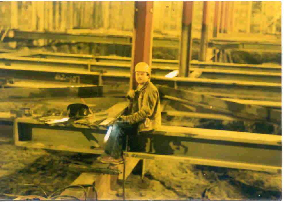

I don't know if it was really all that heavy Mark? Splicing 36-inch x 300 pound I-beams. Well I guess you can't just throw them on your shoulder and walk off tho. :laughing:

I think these were W14-inch x 311-pound beams. Something like 2 1/4-inch thick flanges.:D

Seriously, how long to fit and weld out a joint like that???
/ practicing with my new mig Question ? #33
A lot of variables to that question. If at all possible we would try and weld everything flat, (roll it).
It's been so long now I think that job was in 1987. I would guess 5 to 6-hours, if everything went right.:rolleyes: :D
