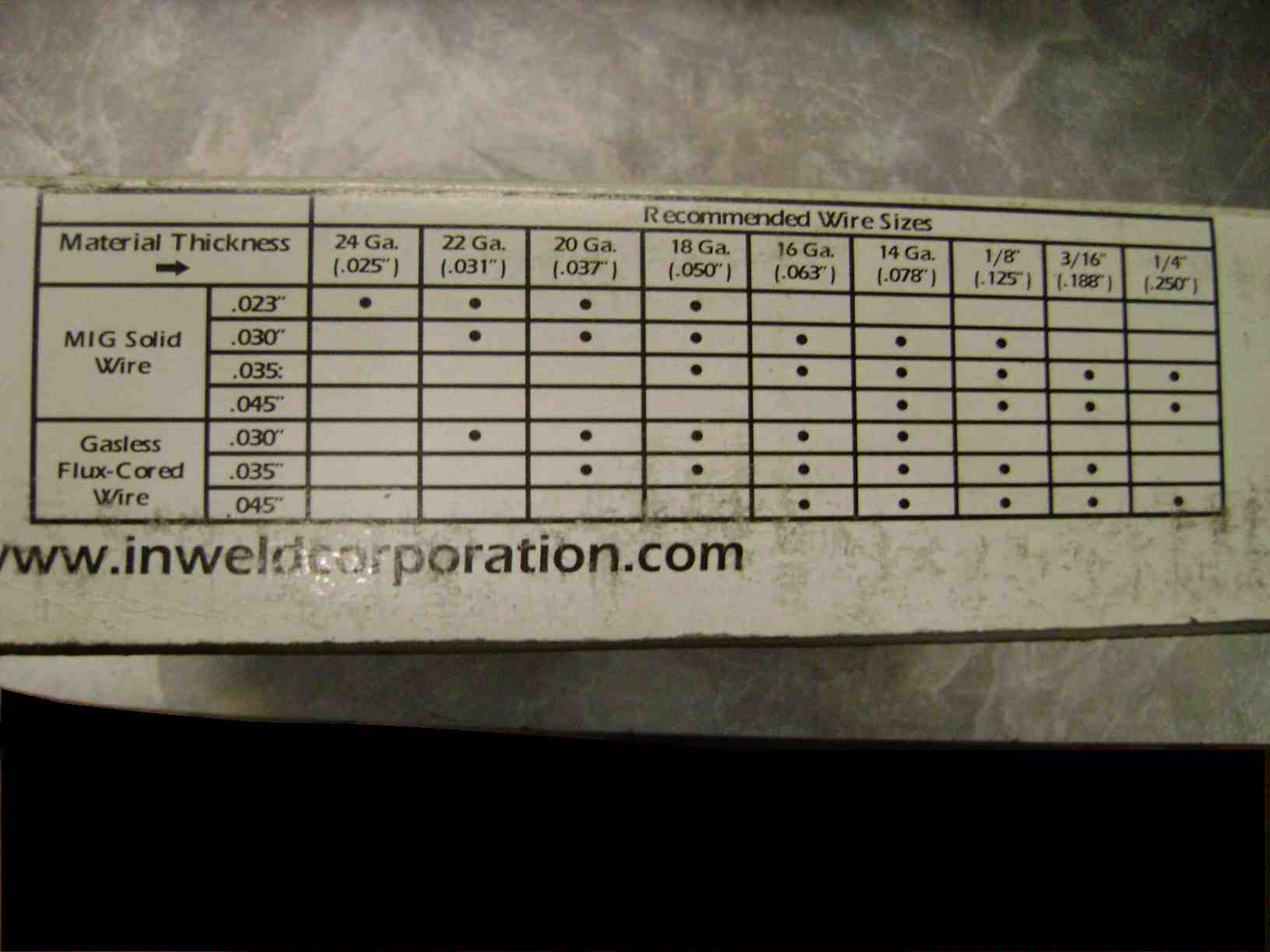

Yes i saw the reverse for gas instructions .I was practicing on a peice of 1/4 plate, rusty and all next time i will clean the area also. I need to practice alot there is a awefull big diffrence in how much of a weld puddle i make compared to my lincoln stick. Not much at all does not seem to be enough actually.The person i bought this from only used it to repair some quarter panels on a jeep she was fixing up .So it is quite possible that the wire i have in it now is very small maybe too small for other uses. I cannot see the size as the label is facing away from me ,unless it is hidden by the nut.What size is the most common to use for welding 1/8 and up like the thickness of a mower deck and up?
/ practicing with my new mig Question ? #5
Here you go Jeff.

thanks for the information it looks to me like i want some 0.45 for most of my stuff.
Just went and read whats in there now called Firepower by a company called Thermodyne it is .030

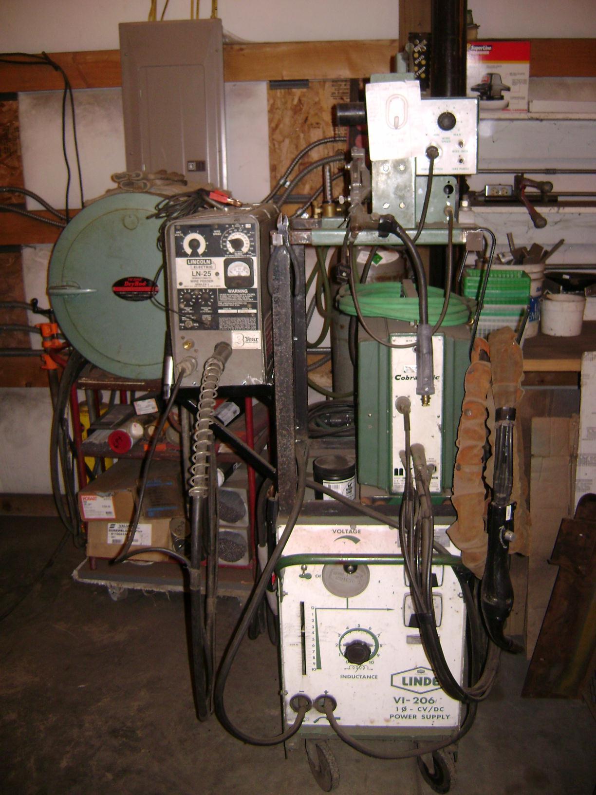

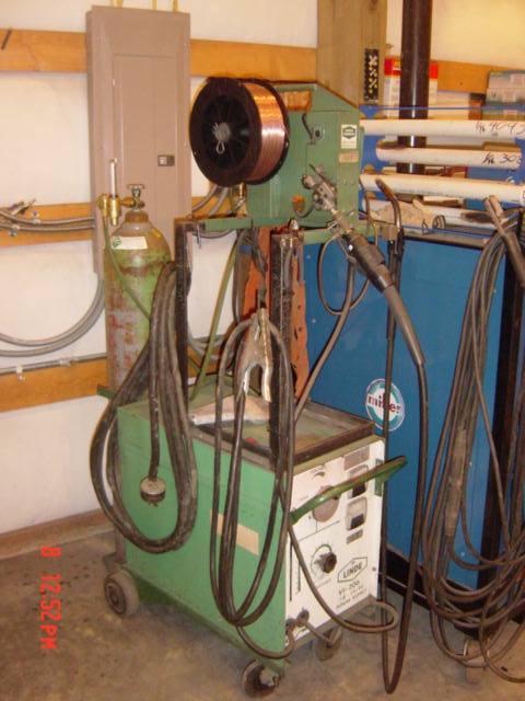

How far do you want to go with your welding?
Maybe PM Mark and ask him to sharpen his pencil for a new 220-volt Mig welder.
There are deals out there, I paid $300.00 for my Mig welder. 200-amps, 100% duty cycle. Then I added other feeders to it.

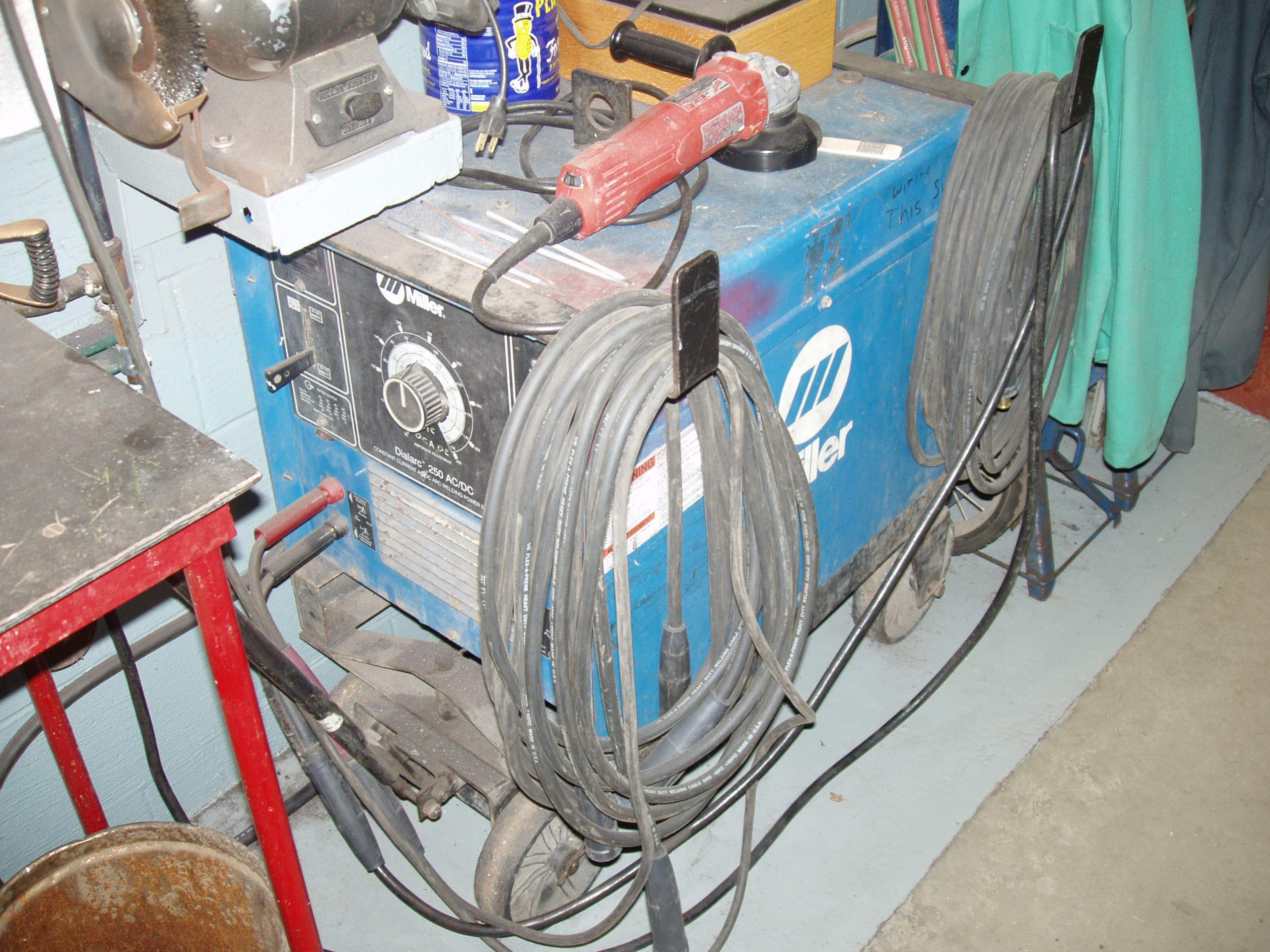

I worked as a professional weldor for many years, then went into rigging full time. I would only go back to welding if there weren't enough weldors available.;)
I have collected a couple machines over the years.
